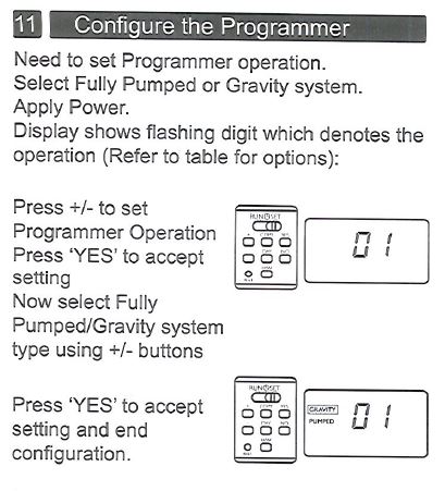

We have a Potterton programmer EP2001 by the boiler. You cannot set separate on and off times for the HW and CW. My question is to be able to set separate on and off times, I want to get a new programmer
The EP2 is well capable of having separate on & off times. If it doesn't allow you to do this presently, that is because it has been set in 'Gravity System Mode' changing the setting to 'Fully Pumped' will allow the programmer to have separate times for the heating and hot water.....
......However, as has been stated, likely you have a system with antiquated plumbing that doesn't support separate control (ie one where the hot water has to be on in order for the heating to work) so the programmer has been 'dumbed down' accordingly.
