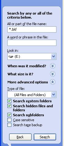

Can you locate the backup file on the E: drive?
If not Try and use the search facility, search for all files and folders Enable look in hidden files and folders) and use the browse button to select the E: drive. In all or part of the file name type: *.bkf
I found it ok,Just could not open it up.
Think above was why
found it using that as well, but also it was is in "my computer" screen anyway.
