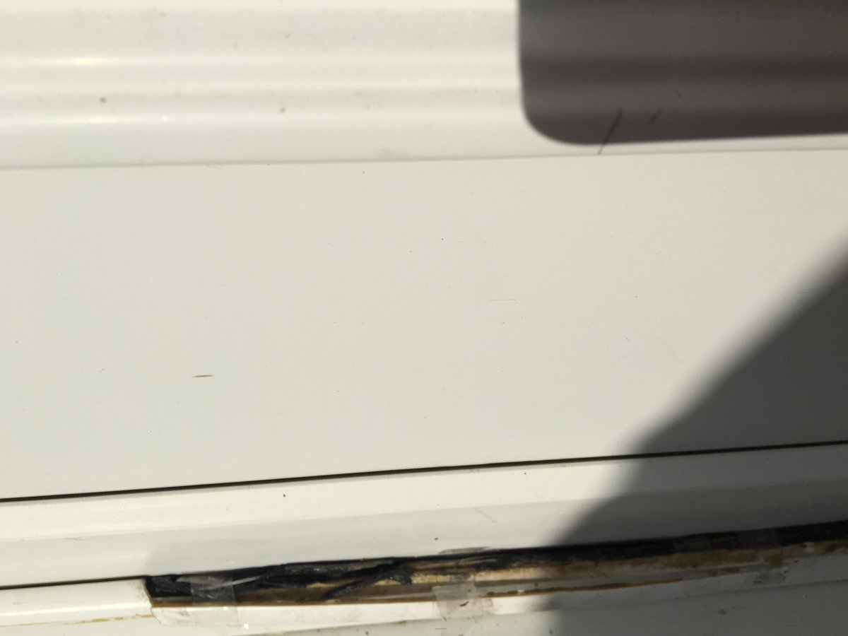

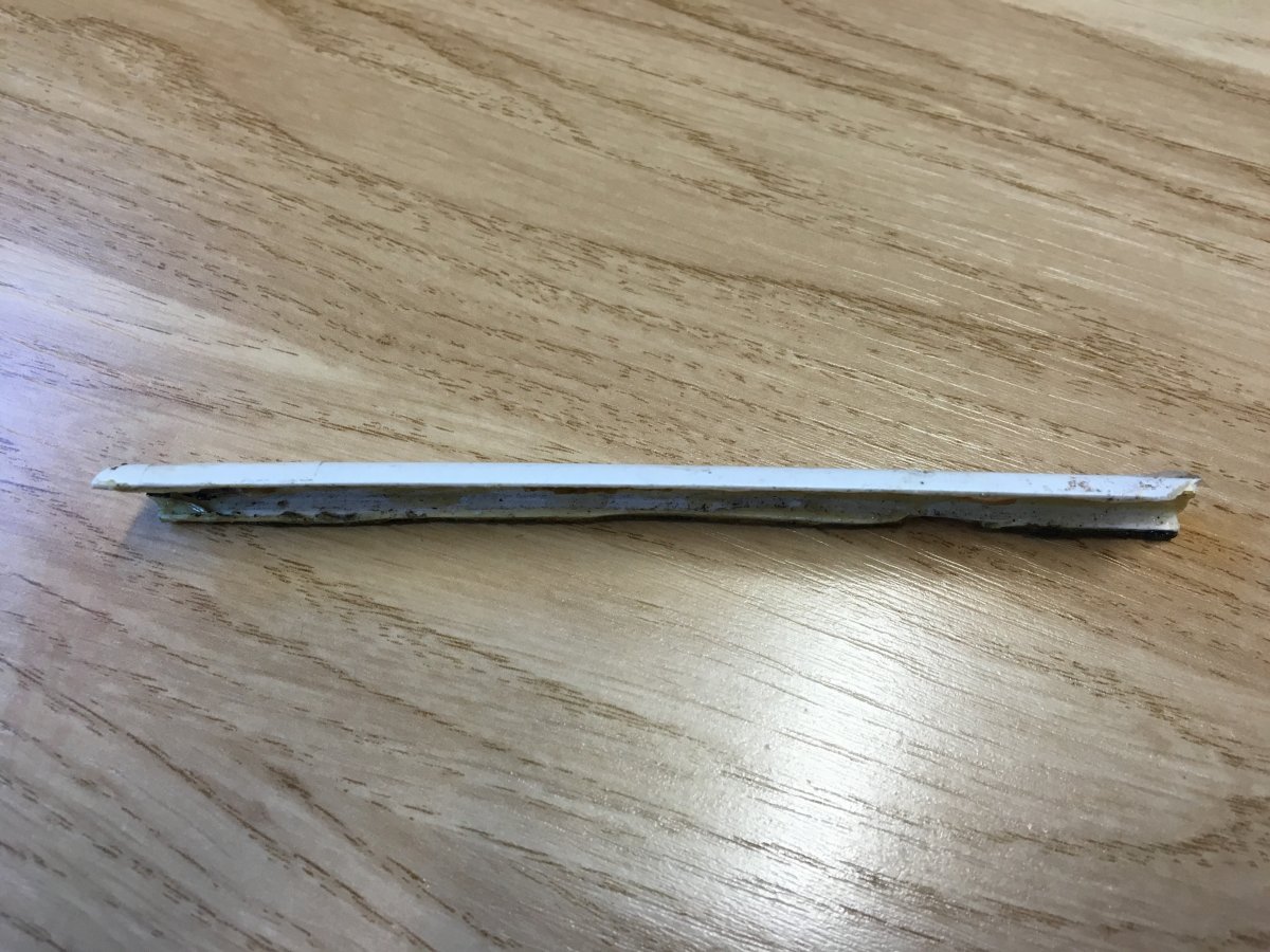

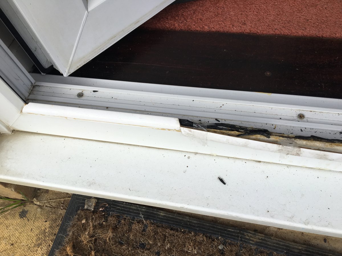

Hi all,

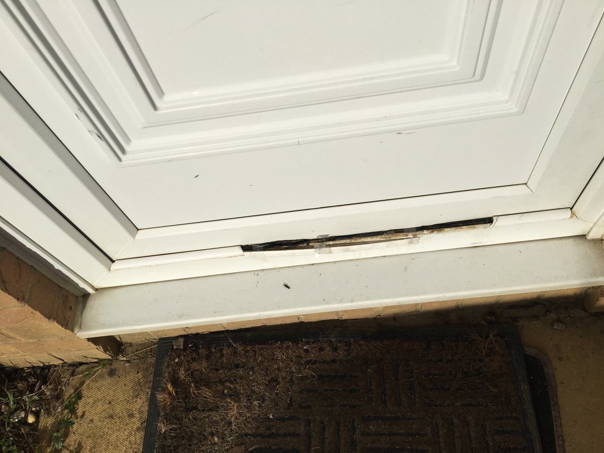

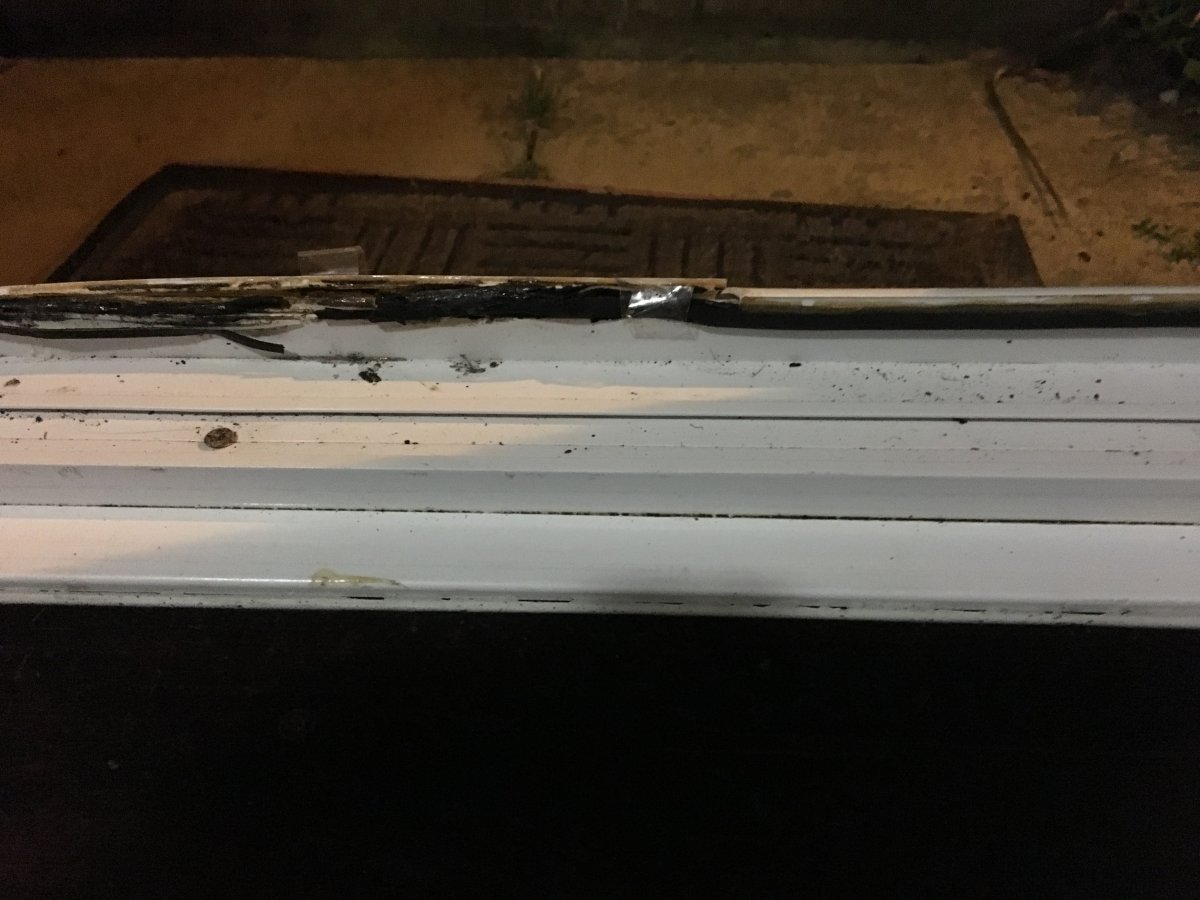

First of all, I am not good with door terms, please bear with me.
I have a problem with my front door frame. the whole frame is intact but the bar (threshold?) on the rubber seal (gasket?) is broken because of kids stepping on it. I have attached the photos.
I have been to Wickes and B&Q but cannot find the bar I am looking for. I contacted a door doctor in my area and he said the whole door frame needs to be replaced.
Can you please advise me as to what to do? What is the name of this part of the door? Do you know anywhere where I can purchase this? How can I know which gasket is the right one? Sorry, I am completely alien to DIY.
Looking forward to your replies,

Any idea what to do David? Were you able to look at the images?
On the face of it it looks as though the 'drip strip' or 'weather bar' is the bit that's broken, if so then easily obtainable and relatively inexpensive on ebay, just Google pvc door drip strip.
If the threshold itself is broken, that's the frame itself then it could well mean a new door, can't tell from the photos while the door is shut, a close up photo with the door open would be nice, you can still buy an aluminium cover that would hide such damage but for the life of me can't remember which website I've seen them, think Gazman linked me to it once, what you will have to bare in mind is that if the plastic threshold is cracked and missing then they'll be nothing for the rubber gasket seal to clip into, I believe the aluminium strip does not accommodate for the rubber

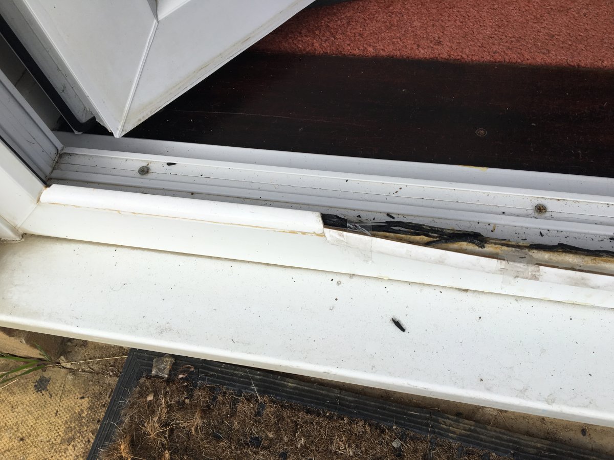

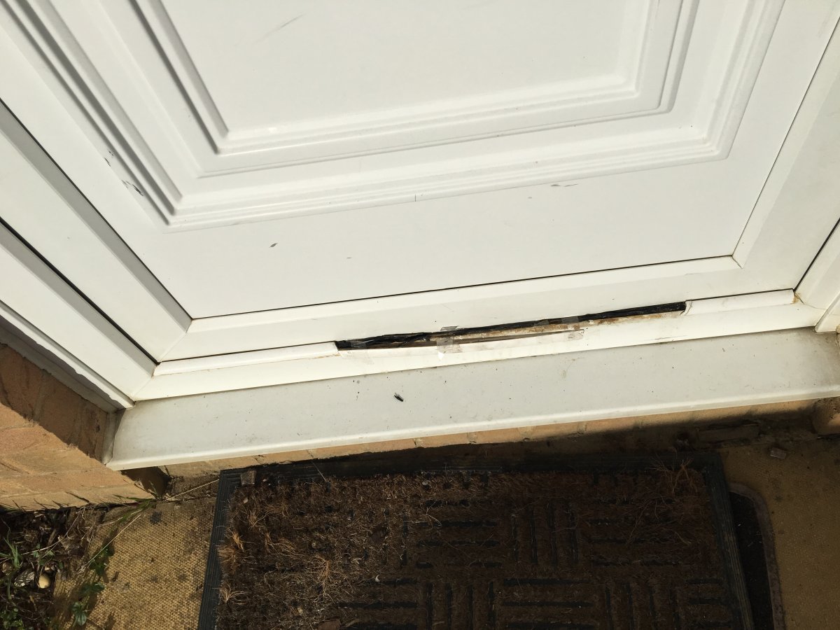

Thank you so much. Here is the image when the door is open.

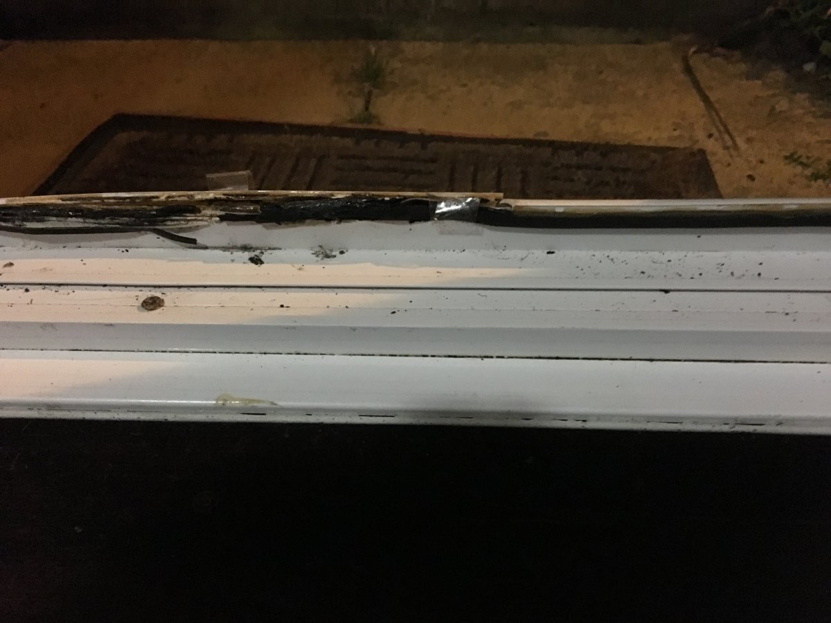

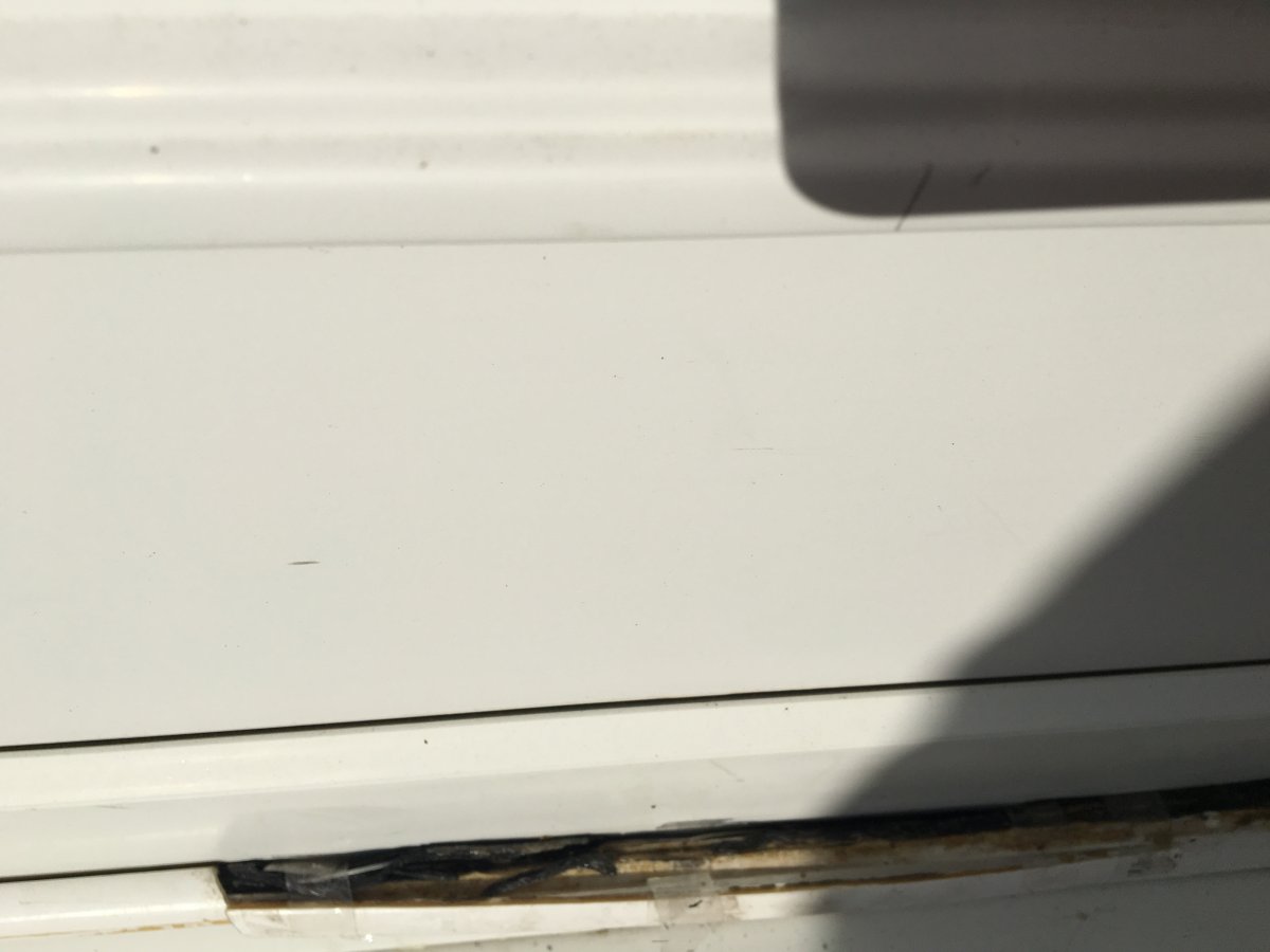

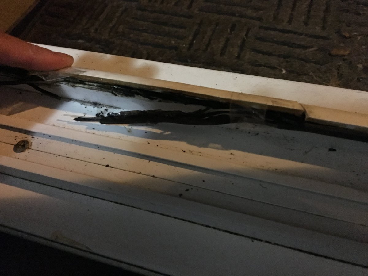

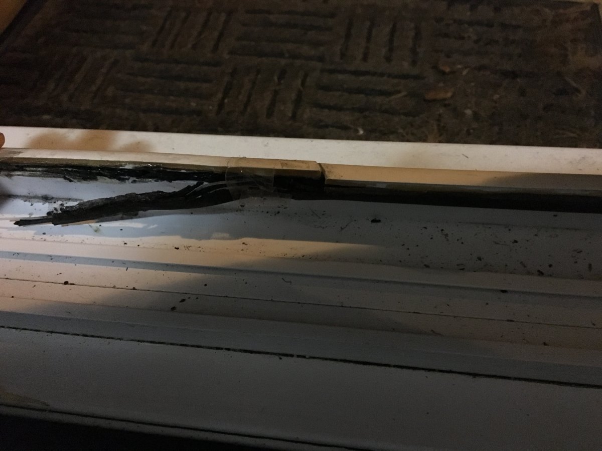

I have taken some new images from
a different angle. Thanks for your advice.

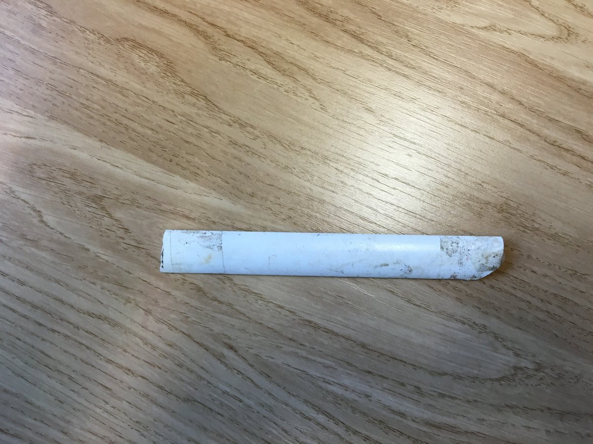

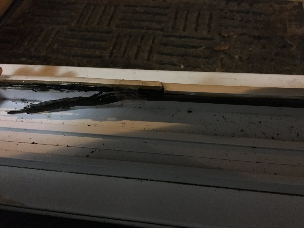

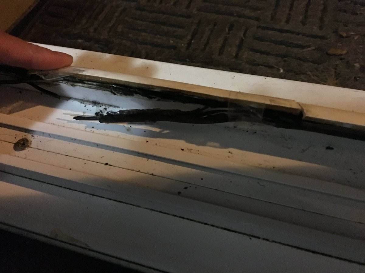

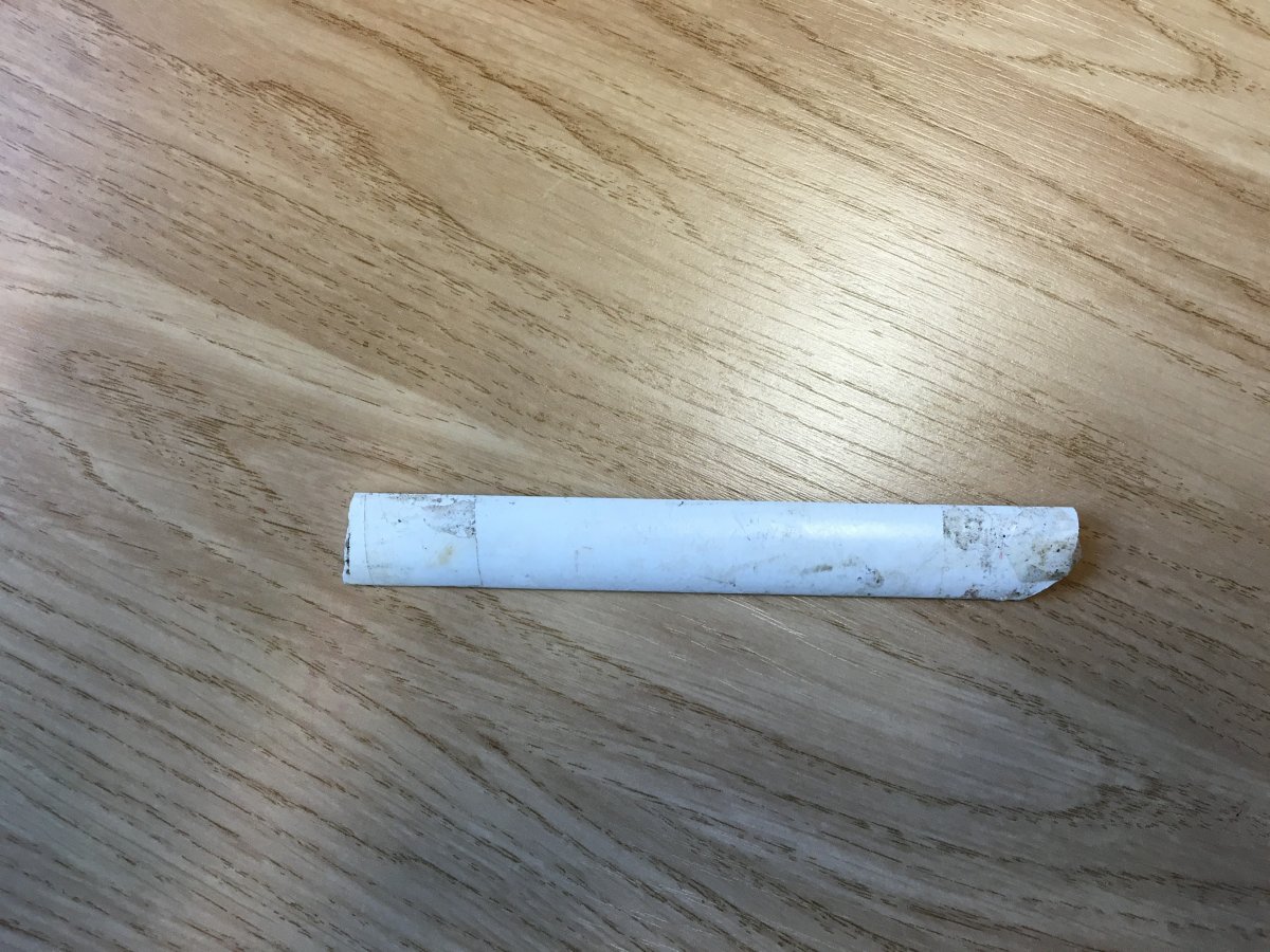

OMG!!! OK what I thought was a drip strip which are fixed to the door you actually have what looks like some quadrant beading glued to the bottom of the frame trying to cover the missing plastic, I can understand why a door doctor recommended replacement, it's easy spending someone else's money and I'd be interested what the repair cost would be from the firm DH linked to but I'd cut your losses and put it towards a new door, how old are the kids, can they contribute.............seeing as they bust it? (y)
i think the images doesnt really show the prob clearly. The damaged area is part of the frame, yes! But it is not attached to the frame. The rubber (the damaged black thing on the images) can be easily removed from where it sits. And the white beading requires replacement. Because it is also not attached to the frame itself. Its just matter of pulling it off.
What I was hoping is to remove the black rubber. Clean the area. Insert a new rubber and and then use a silicone to attach a new plastic beading on the top of the rubber. How does that sound? :(

yes that looks like a 13mm quadrant glued on the bottom of the frame and you could replace it , but my concern is why is it there? I notice the door doesn't have a drip bar , and i'd be inclined to put a drip bar on the door and not put the quadrant back ( as its increasing the height of the threshold , and will get get broken again...). I'm guessing the quadrant was put there originally to stop water ingress , which probably arose from the lack of drip bar in the first place. As for the gasket there is plenty of types available on ebay and the likes but its determining which one you need.
As for covering the area where the old quadrant is , once you have it off , you should be able to get a silver or gold aluminium threshold strip, they used to be standard on the doors we used to buy , but seem to be left off these days
Pretty sure from the photos that the quadrant part is actually what's holding the seal. In that case it should be possible to remove the length and find something that performs a similar function?
