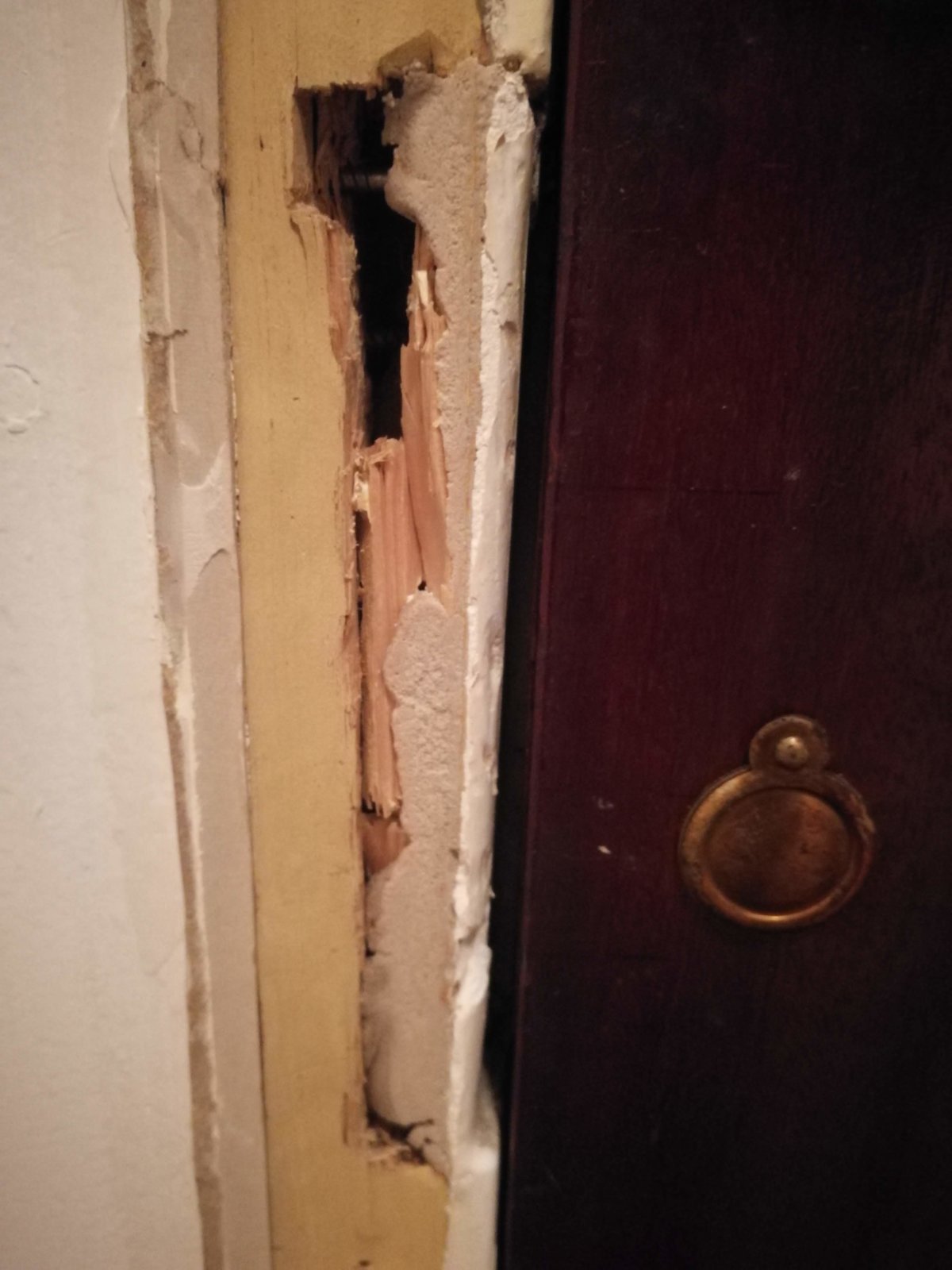

After taking off the architrave of our external front door, I noticed that the frame is damaged around where the lock keep is. The damage has been partially filled, but I'm not confident in the strength of the repair, it looks like it would give way very easily if someone tried to break in. What would be a good way of fixing this to improve the strength and security of the door frame?

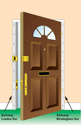

Maybe a bit "industrial" but you might want to consider a "Birmingham bar" down that side of the frame. On door frames with an architrave these can be hidden to an extent by fixing to the frame and chiselling out the back of the architrave to form a pocket, then reattaching the architrave

That's a great suggestion, thank you! I wonder if it would still be worth trying to fix the frame before attaching one of those bars, just to provide a bit more strength. Perhaps I should cut out the damaged area, and replace with a section of fresh timber? What kind of joint would be used to make it strong against being kicked in?

I'm thinking of using two half-lap joints to insert the new piece of frame, secured with four screws in the overlapping sections. Do you think this would be sufficiently strong enough?
Done well with tightish joints and a good exterior (D4 PVA) glue then possibly, but it will still be weaker than the original one-piece frame leg, so I reckon your splice will need be long enough to allow for a couple of frame fixings or the like to be put into the masonry behind and I'd certainly put a Birmingham bar up the back of that leg (with loads of screws) to further strengthen it
