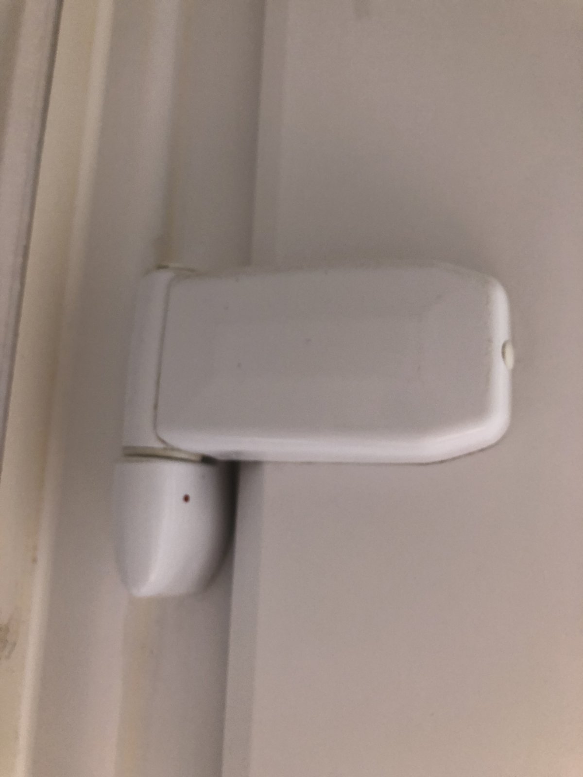

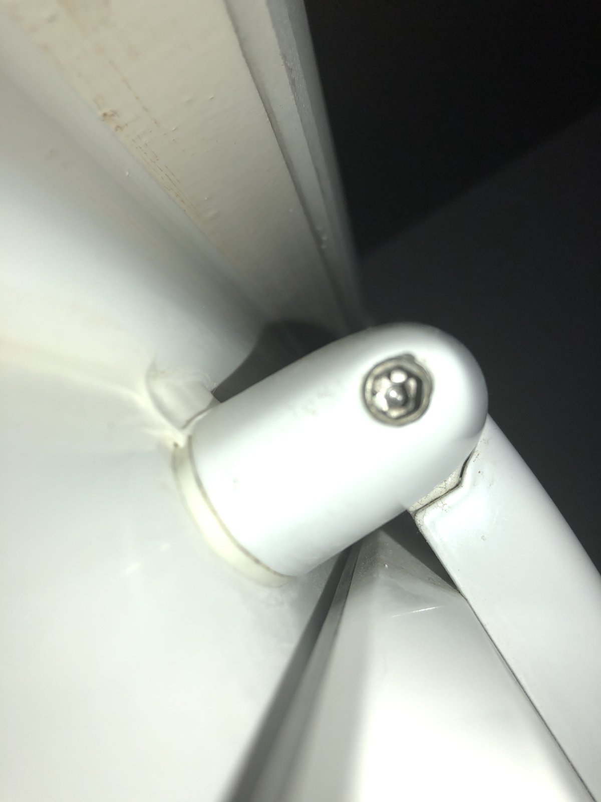

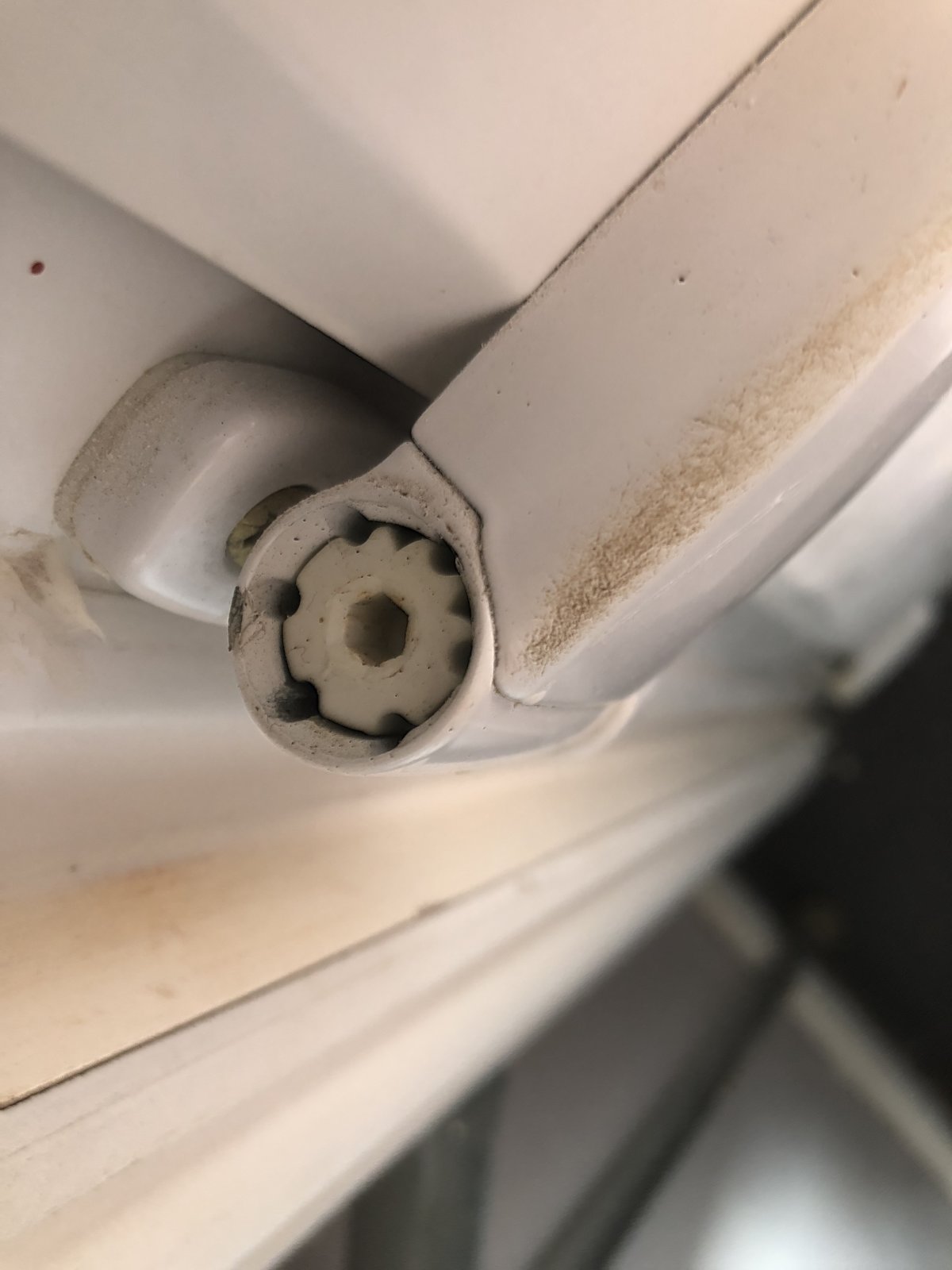

hi on my front upvc door with multipoint locking I have to give the handle an extra nudge when locking as it sticks just enough to stop the key turning, but works fine if I try it when opened, so I assume that after around 10 years it has dropped a bit and I need to Jack the hinges up a bit, if this is right can anyone tell me how, I know where the screws are.
Going to need photos. Door and especially close ups of the hinges. There are hundreds of Makes/types

D22CFA5C-BB1B-473A-A8BF-E3F2F3D99BF6.jpeg 80A73F52-1C7C-4649-A2DB-00BDBF48FCCC.jpeg 7D40571E-D27E-4289-B9E7-A4E0932A923A.jpeg Pics of the hinges
