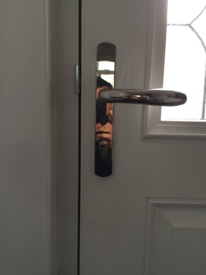

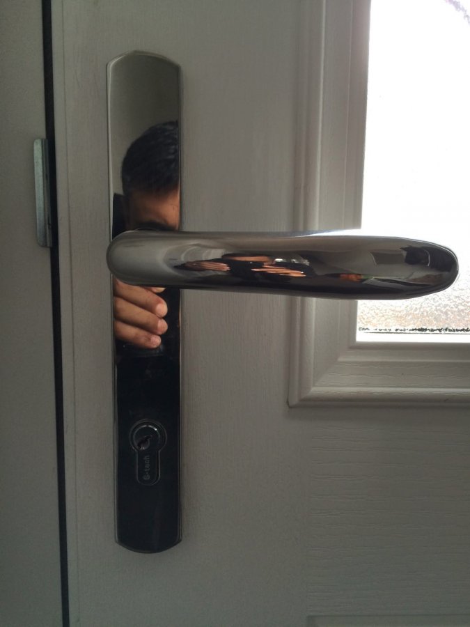

My front door is locked and internal keyhole is out of alignment. The key won't fit in from the inside but does from the outside. However I can not open it. I tried with force to get the keyhole alignment the same as the outside but it is not budging.
There is not screws on the internal handle so I can't even remove the handle to try snapping the euro cylinder.
Does anyone know of a method to open this door or removing the handle? Any help would be much appreciated.
is there an allen key holding the actual lever on , and then the chrome cover prises off?
Thanks Ronnie, the chrome cover actually does prise off. It was held tightly on with clips which prised off with a sharp knife.
