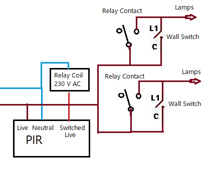

Hi,
My next home improvement will be to install some lighting in the front garden.
Plan is to install 4 wall lights and some ground lights around the plants.
I have a tripple switch. And plan on using as such.
Switch one will control the two of the lights by the front door (one on either side)
Switch 2 will control two lights ( one on either end of the house)
Switch 3 will control ground lights.
Now thats all straight forward as i can see.
But i wanted to complicate it by introducing a pir sensor for the wall lights, for both switch one and switch 2.
Is it possible for me use just the one pir sensor to control both sets of the wall lights and still be able to change switch any circuit to stay on permanently?
For example,
Switch one is on permanently by overriding the switch (turn on/off couple times) and switch 2 can still operate via pir.
Please can one of you smart sparks help me out with this, thankyou in advance

As long as both lights on same circuit, you need the PIR to switch a 2 pole relay that would link to the light 1 and 2 switch lines, or fit another PIR. With PIR/PIR's tripped you would not be able to turn lights OFF, if not happy with that, fit another switch to turn PIR/PIR's ON/OFF - key switch possibly.

Edit - see EFL's drawing of 333rockys idea, and add a switch (key switch?) to L to isolate in the event of a fault, that's the way to do it.

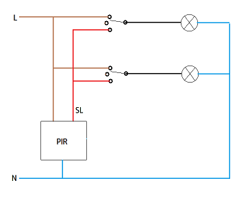

no need for relays use grid switches, use two position centre off, feed each switch from both the pir And a permanent live, then the other terminal use as the output to the light
you need a pir with a Neutral that works with no load connected.
position 1 lights work via pir
position centre lights off
possition 2 lights permanently on

Rocky and EFL have got it right, ( I am probably addicted to relays ).
Dare I mention the ability to have full isolation ( Live and Neutral ) of outside lights.
If there is damage/ water ingress then protective devices ( RCD and/or MCB ) may operate on a Neutral Earth fault and remove power from circuits inside the house,

It needs thinking about, but is not complicated for an electrican, and 333rocky has given the simple solution as sketched by EFL.
Have you looked at the previous posts.
If the wirings in, all you need extra is an extra cable from the Pir to the switch, and power including a neutral to the Pir, if you have a Neutral at the switch you can use that for the Pir.
You can even use your existing 3 gang switch as Efli suggests but there will be no Permanent off facility/
