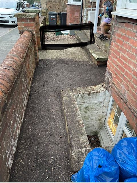

Hi all
I would like to build a brick wall between the front garden of a semi detached house. The footing is existing concrete which is on a slight slope down away from the house. How would I ensure it is level to build the wall? Is there a specific way to use formwork ontop of concrete? Trying to add a picture but keep getting a security error. Any ideas for the wall welcome. Thanks

Thanks Tigercubrider. it's actually some rather unsightly poured concrete rather than a concrete slab. Hopefully the picture works now. I have marked in black where i want the wall to go. I will lay paving on the other parts and create a victorian pathway leading up to the steps.

You would level the first course of bricks if possible - via the joints or cut bricks.
How much out of level is it, over what distance?
its about 150cm and a gentle slope so first course will be unlevel unless i manage to either build up the foundation on the end sloping down away from the house or dig the existing concrete the other side in order to level it. Tricky one!
That's doable as mentioned above, especially as you say you will be laying paving which will hide the bottom of the wall.
Start at the low end with a big joint and lay that course which will have a tight or no joint at the other end.
There's threads about this in more detail regarding uneven foundations.
If the slope is too steep, gain level in 2 courses.
It's fine to build on that concrete, unless it's only an inch thick.
Use wall starters on either ends.
And clean the concrete before you start lying bricks, brick cleaner will do the job in seconds, otherwise jetwash or bleach and hard brush.
Thanks everyone!
So in summary, give the concrete a good clean, find the level and start at the low end where I build up the joint and have more flexibility as it will be hidden by paving slabs. Oh and use wall starters.
