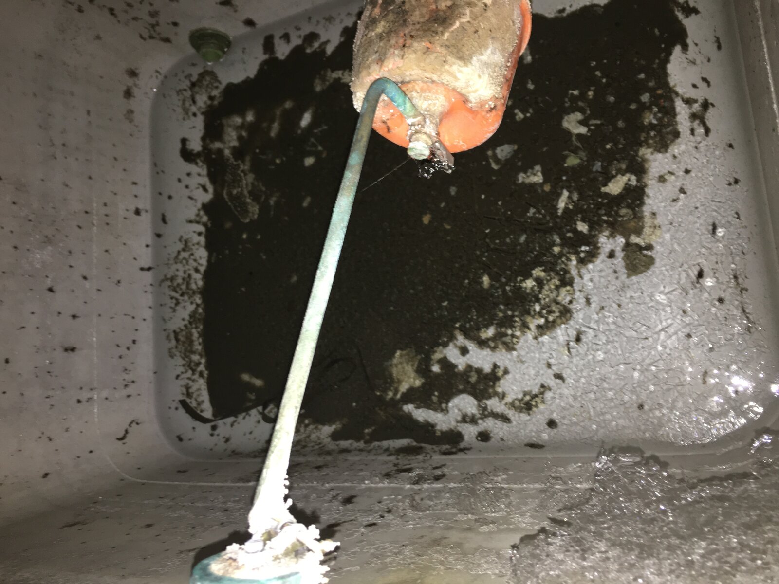

Hi everyone I just tried to use hot water tap in kitchen and no water came out I think my pipes have frozen, I’m thinking the pipe to the water tank is frozen, I’ve been in the loft and checked the water tank has not filled up the stop cock is down, so I’m guessing. The cold water feed is frozen, what is the best thing to do just wait for temperature to go up and let unfreeze naturally, my loft is very cold any help would be appreciated thank you

you might consider cleaning out that tank while you're up there.
Also, measure it so you can buy a lid

Thank you so much for the advice I actually brought the house a year ago and in 2 weeks time I’m getting the water tank changed to the black poly tank with lid , didn’t expect the pipe to freeze, the previous owner didn’t put any insulation on pipes
Hi all I use the hairdryer and melted the ice and pipes and got it working thank so much for the advice glad I’m having it all changed I’m 2 weeks time
Lol it was frozen but it’s also buggered will be changed soon at least the hairdryer came useful for something as I’m bold it’s not used at all haha
