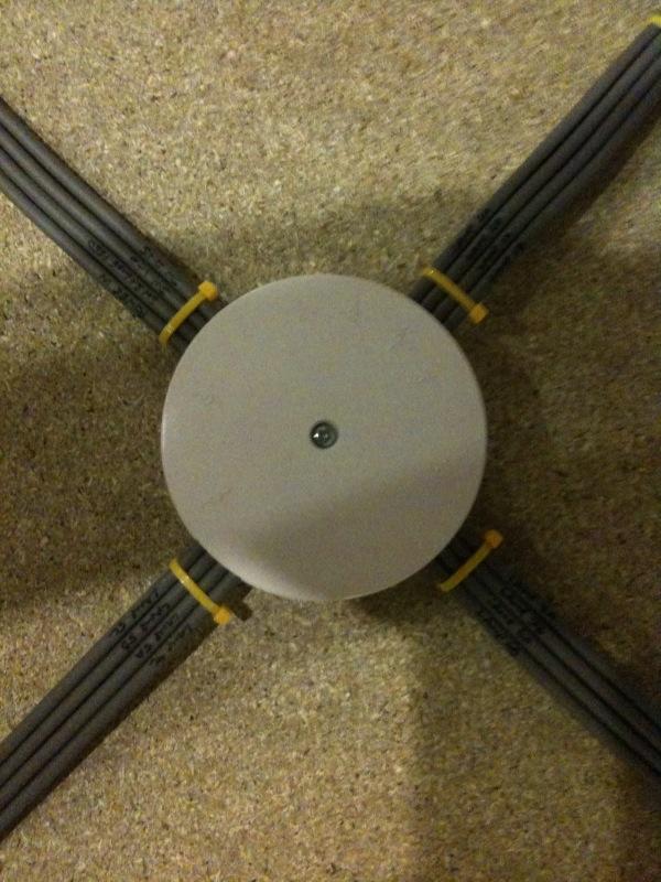

I must confess that I got a little carried away with this one, but it just goes to show that you can fit an insane number of cables (16 in this case) into 1 junction box and still keep it neat.

I was thinking, you could probably get 20 x 1.0mm cables into a 30amp round junction box! - Anyone care to try :)
I have to ask though: What's it for? It looks as if there's a carpet underneath the JB in the bottom picture, and it's pretty rare you get to install one in a location as comfy to work in as that!
The top one is a big room lighting setup, 5 circuits of between 2-3 lights on each switch. 12 lamps in total.
The smaller of the two is on some carpet in the picture (well spotted) but it's in a loft space - I just used to carpet to kneel on, otherwise I get bad knees. Again it's a lighting circuit - 4xGU10 downlights in a bathroom.
Why didn't you use a larger, more suitable junction box with enough terminals?
Was this just to proove how many conductors you could terminate or is it in service?
If it's in service I'd hate to have to disconnect anything for fault finding!

Fair points.. As I said, I got a bit carried away seeing if they would all fit :oops: a larger box would have been far more sensible... :LOL:

Very neat, though I'm not sure I'm a fan of dressing the heads on terminal screws! Visable accessory screws, fair doos if you're that OCD, but terminals should be done up to the required tightness in my opinion.
....Ummmm, that is a good point well made.... :oops:
Guess who's just been back up into the loft to give them all a extra tweak up! :D

Would like to see what you will do if one of your short neutrals burns out LOL :LOL:
To Grantewart, He probably does what i do and leaves a foot of slack out5 of sight.
