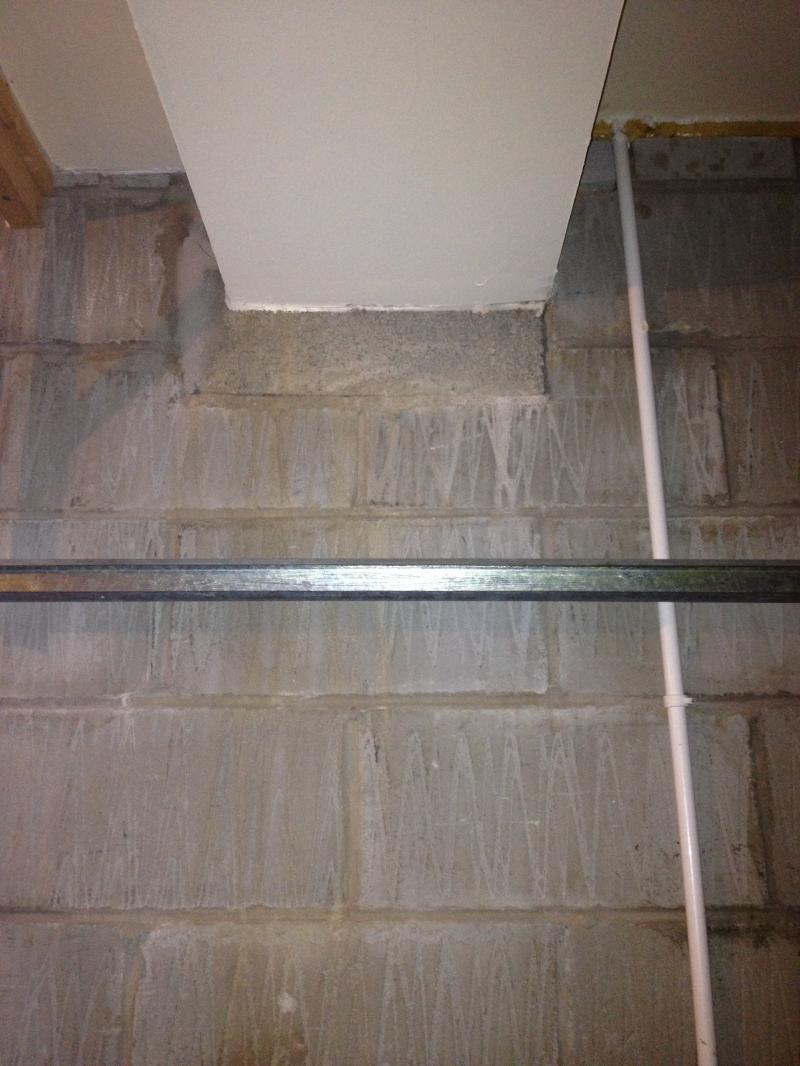

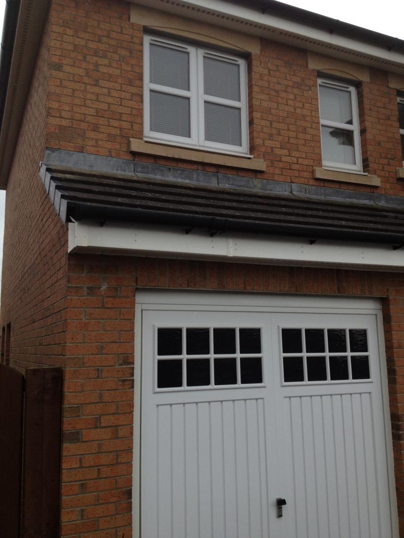

Greetings all
The crack in question is in an integral garage ( right hand side as you look at the picture of the house ), is hairline, runs pretty much vertical, through mortar in places and in other places straight through the blocks (which I think are thermalite but may very well be wrong ) themselves.
There is a beam running across the roof with a concrete block underneath this ( pic 3 ), I assume is supporting the outer upper front wall of the house which is recessed from the garage entrance. The crack starts pretty much underneath this and runs down to the floor.
House is built by Miller, approx 9 years old. Can't say how long this crack has been there, first time I've noticed it. No noticeable cracks anywhere else in the walls and the concrete underneath the supporting beam is intact.
Being completely clueless, should I be worried or is this common? Any thoughts v. much appreciated.
Regards
Vin

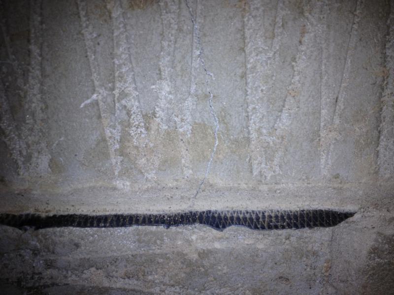

Tony, the cracks get slightly wider towards the bottom and where they go through the mortar, but even at their widest they are only approx 1.5mm.
Further to my previous post the cracks don't actually go all the way to floor level, they stop approx 6 inches from floor where there is some sort of membrane layed in between the blocks.

That membrane is the flexible damp-proof course. The fact that the cracks don't continue below that is further evidence that the cracking is not serious.
The vertical cracks are due to initial shrinkage of the blocks, which can be pronounced for lightweight blocks, the more so if they were wet when laid, and/or a strong mortar has been used. The damp-proof course provides a slip-plane; the blocks below that are probably permanently slightly damp, so won't shrink quite as much.
It's nothing serious; the time to worry would be if you saw similar corresponding cracks in the external skin.

VinnieG - Tony 1851 is correct regarding the width of a vertical crack. if it is of uniform width top to bottom, it is most likely to be a tension crack, At the foot of a wall movement `may / can' be arrested by the junction of the wall with the ground floor, which is why they sometimes do not go all the way to the bottom.
Cracks which change in width may be more serious, as those which are wider at the top than the bottom can be formed by hogging e.g something which lifts the wall from below, e.g a root from a nearby tree under the foundations, or where the foundations under a return wall have settled slightly.
Where cracks are wider at the bottom than the top, this `may' indicate settlement under the wall in question. but from your description it seems to be a simple drying shrinkage crack. Once the materials in the wall have returned to the normal (equilibrium) moisture content further drying shrinkage is possible but unlikely.
