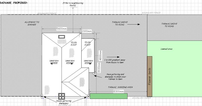

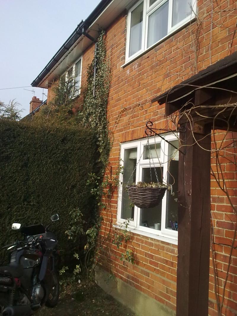

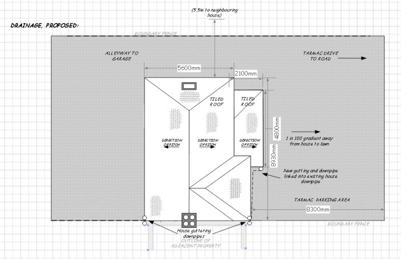

3) Rainwater drainage. "Please provide full details of rainwater disposal from extension roof" The existing storm shelter roof that I'm replacing like-for-like has no guttering and runs onto the tarmac drive, and there's a gentle gradient away from the house into the lawn. I'd been a bit cheeky here and stated that I was going to fit guttering and join it into the main house roof down-pipe. Obviously this isn't sufficient detail. I have no idea where the main roof down-pipe goes - it's buried in a hedge and I suspect it just flows into the ground. I'll have a closer look later:
So - if I have to dig a soakaway, is there a dimensional lookup table that I can use to calculate the size required?

Soakaway 1m x 1m x 1m with 100mm clean fill will be fine - only thing is, it has to be minimum 5m away from the building.

By clean fill - presumably you mean rubble? I'll be breaking up the existing concrete slab so that could work out nicely. The lawn is around 5M away from the house, so I suppose that's not too much of a problem, but I'll need to cut through the tarmac to lay a pipe, which is a shame.
The soakaway should be filled with non-degradable non-compressible materials, usually single sized drainage stones or hardcore and it should be lined with a suitable geotextile material (e.g. Terram 500S).
Then your new drainage can also drain onto the ground then unless it runs into a neighbours garden or down a path etc, the rain that falls where the extension is being built absorbs the rain at the moment so you're not making anything worse. Soakaways fine unless you're on clay.
Yes, I'm on clay. I've read in the archives that a number of people have been forced to install pointless soakaways in clay to please building control.
My first drainage submission was this one:
So I could change it so that it shows the lawn, flower beds, and hedge between us and the neighbour. Is it acceptable for the water to flow from the drain pipe, over the tarmac that cars are parked on, and into the lawn? i.e. what would be my chances with this :
Gary
Phone up the inspector and ask him if he is prepared to accept you draining over the existing ground as that is where the existing is draining, it needn't spill all over the path, you can guide any rainwater with a fluted footway channel 2nd one across in this pic:
They're extremely common down this neck of the woods.
Admittedly you don't want to end up with a hole in the ground where the water pools though so not ideal.
Your inspector should know off the top of his head if a soakaway will work as he should be familiar with your particular area. You may have to do a soakaway percolation test to prove a soakaway won't work. If he won't accept it spilling onto the ground and a soakway won't work he should let you branch into the mains drainage.

Drainage - I need to build an underground pipe from the new extension, to carry the water at a 1 in 40 gradient, around 4.5 to 5 metres away. This will terminate at the top of a 1.2 m3 hardcore filled soakaway.
