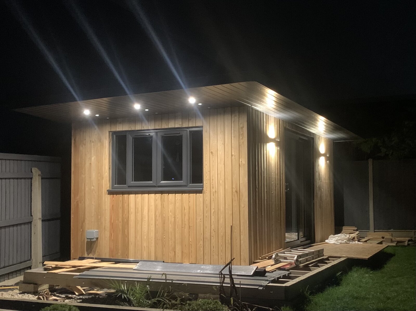

I have casement windows that I want to open fully outwards. They have standard on at the moment. I would like to open the windows fully out.
is this possible?

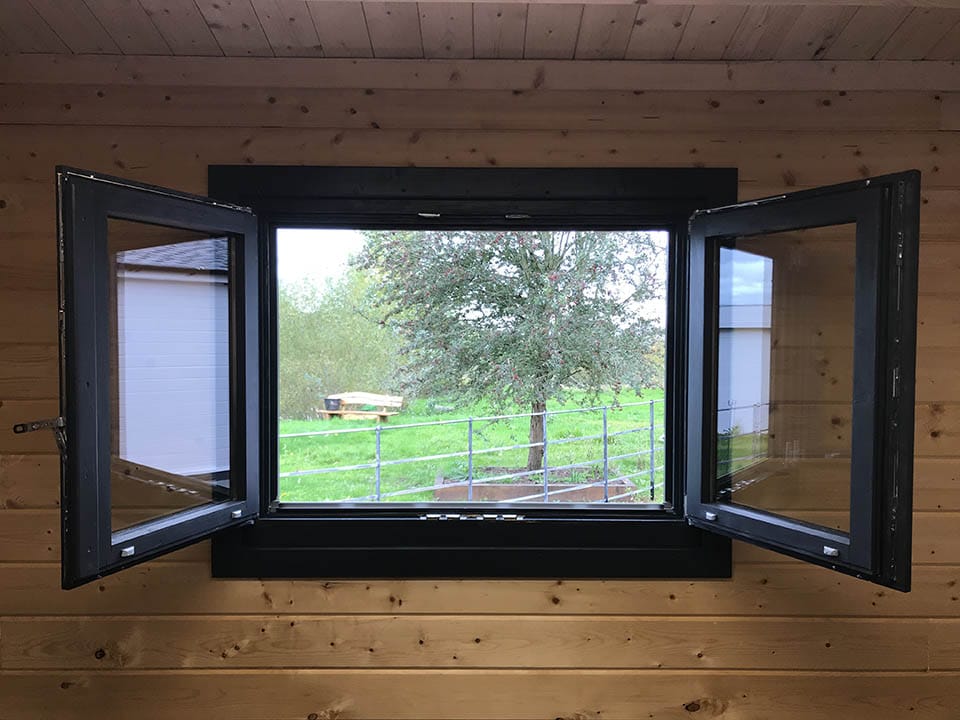

like this but outside
OK the sample pic is a tilt n turn window and has a totally different hinge mechanism setup, it wouldn't be beyond a competent service engineer to retrofit tilt n turn mechanisms on site but the cost might be prohibitive and cheaper to have a new window made, another issue you have with the existing window is when you open both openers out your left with a centre mullion frame right in the middle not a clear opening like in your sample pic, there's no way to remove that and it's defo a new window, probably looking and £400/500 I'd imagine

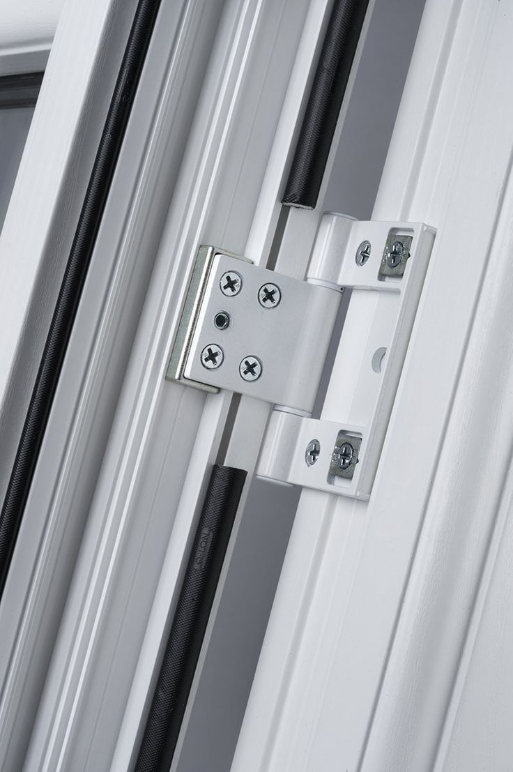

Do you mean open to 90 degrees and where the sash in open position will be tight against the frame?
if so the mega egress hinge will do that
https://windowware.co.uk/trojan-mega-egress-easy-clean-friction-hinge-prc0000017
whether it will fit your window upvc profile or not is another question and whether the Euro groove is in the right place.
if your window has a mullion you can’t remove it now, but French windows are available in upvc.
if you the windows to open back flat against the wall you can’t do that with any upvc system

it's a flying mullion window

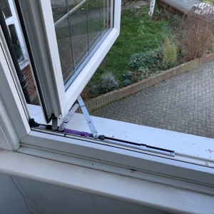

it has an egress hinge already fitted but want the window to open beyond 90 degrees
