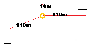

About 4-6 years ago contractors laid a 6" duct, 220m with a 300mm pit (drainage access chamber) roughly in the middle. We pulled in 3 SWA's: 1.5mm² 12c all the way, 35mm² 4c to the mid point building and 16mm² 2c from there to the far end and a blue draw rope everywhere:
Since then there are 2 more cables about 15mm diameter to the mid point.
The plan was to pull in one more today all the way and finding 2 blue ropes in the first run thought it would be OK, after an hour of huffing and puffing a cheap USB camera was put down the duct on lightweight cable rods to find each rope is wrapped around a newer cable every metre or so...

My experience has been limited, but it has always been the same, even with a single cable and single rope.
Putting a rope in a newly-laid duct, with which to pull through a cable, is fine. However, if (as one usually would do) when one pulls the first cable in, one also pulls through a 'new rope' (for subsequent use) my experience is that the 'new rope' invariably gets totally wrapped around the cable. That means that one cannot use that 'new rope' for subsequently pulling through another cable, unless one also pulls out the original cable!
