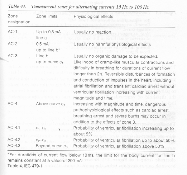

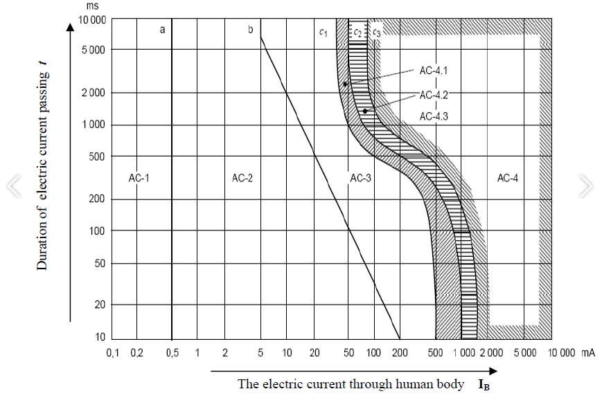

But that current would not have gone through you, it went from L to N via your cutters.
And if it had "gone through you" it would have been nowhere near 160A, as even a small part of you has a great deal more impedance than a short length of steel.
But if you could, with a high enough voltage, contrive to pass 160A through you your chances of survival would be nil.
I believe that the voltages used with the electric chair result in currents of 10-15A.
