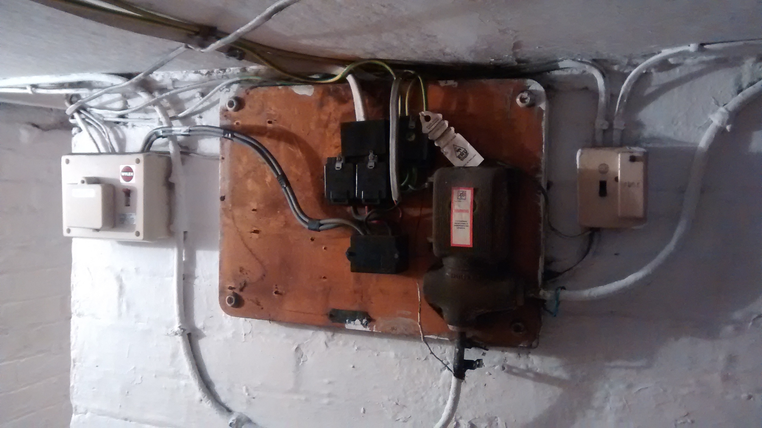

Good morning all,
I am buying a house to do up. It's my first time so please go easy on me. My real work is not that interesting to me these days, so I fancied a change, something to interest me and provide a challenge and, hopefully, to bring some decrepit property back into usefulness - it might work out, it might not.
In the cellar of this house, I took a photo of this (I've uploaded the full size image as I'm hoping the forum might allow you to see it all or zoom in for detail)...
Now, the Vendor of the property said that the house had been "rewired a few years ago" but that doesn't make much sense to me... wouldn't you expect to see a nice Consumer Unit if that had been done, or do people sometimes do a rewire and still leave this kind of thing in place?
Anyway, I'm prepared to spend £s on rectifying things... my question is this... regardless of the rewire position, is the replacement of the thing that I see in the picture with something like ToolStation item #50454 the way to go (obviously by a professional, this is certainly not a job for me)?

I think the first thing you need to do is take a look in the loft and see if there is anything unusual up there!
Ah, no - sorry, the meter is not actually in the picture, it's outside the house. Took a gander at that and it didn't seem different to what I would normally see on a house... can you elaborate on why that bit is relevant too, I had no idea it might be?
It does seem no meter. There is also twin and earth into a henley block. I suppose one has to ask what is a re-wire? My mothers house had the kitchen re-wired except for the light but it did not go further than the kitchen. I re-wired my shed i.e. renewed the SWA feeding it.
Not quite sure of the date but some where around 1994 the type tested distribution unit called a consumer unit came out. Before that date they were not type tested so not consumer units. I am not sure what actually changed even today you can have fuses it does not need to be MCB protected.
My first question is that actually the incomer into the property? The little black boxes may be CT's and maybe the meter is where it is easy to read but that's unusual for domestic. Also I have seen with a re-wire where the incomer is moved but the old stuff is left in place.
I would say start with an Electrical Installation Condition Report which should be done with new occupants and see what it says.
I remember my dad buying a new car. Within 500 miles the head gasket failed and as a result a new engine was fitted. Some 10 years latter when he sold it the buyer was impressed as it had a new gold seal engine fitted can't remember if we told him that was fitted just 500 miles into life of car. So any house built before 1950 will likely have been re-wired at least once. What is important is when it was re-wired. If built 1920's and re-wired in 1970's then likely dew for some serious upgrade now even if not a full re-wire.
Apart from the missing meter, looks like there are two Twin & Earths going into those Henley blocks. :/ also can't see any cables coming out of that service head.
There appears to be something wrong with this photo. If the meter is outside, that explains the thick T+E cable leaving the service board and heading towards the direction of the camera - I don't see anything remotely that size coming back to those henleys. And it looks like there is a piece of 2.5/4mm coming out of that bottom henley block and it looks like it could be feeding that wylex board on the right but I assume it can't be.
It also looks like it should be a TN-S supply, but the state of those clamps on the cable - and the size of the pathetic earth cable leaving the cable suggests there could be little/no earth. Unless of course it's been converted to TNC-S, but those ISCO cutouts are so old I wouldn't have thought the DNO would do that on those.
OP, bottom line, that doesn't look it's been rewired this century. The DNO will likely change that cutout for you too for free, could get it all tidied up in one go.

I will have a guess. Most re-wired but not the cellar and that was just supplied from new board with loads of unused stuff left behind. But guess is no good and so it needs an EICR to find out what is what.
Some of this has gone over my head, guys... but I'll take some time and try to absorb it. :eek: What my take-away is from this - it's old, it defo. needs attention (even though the Vendor would say the electrics in the house are all fine and dandy).

You need to stop right there. A proper survey of what you have is needed before you buy ANYTHING.

What you have photographed looks like an old supply. It may have been replaced by a new supply into the meter cupboard itself.

It may be worthwhilehaving a competent electrician do a survey and report for you. (EICR)

BTW - everything's live, it's a house with fully working electricity. It just needs some TLC to make things better for the next occupiers... definitely a Consumer Board, maybe a rewire (of some level).
The thick incoming cable that is fed from the meter thats outside - also goes off elsewhere?

Either way it does look like you need professional help with that setup and the DNO to change the head etc. Perhaps arranging for a smart meter to be fitted whilst also mentioning the setup, then the meter can be fitted where the rest is.
