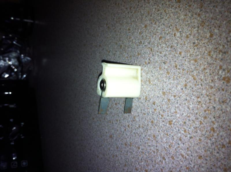

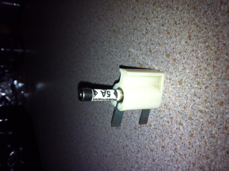

Hi,
Could anyone help me to identify what these fuse holders are please?
One has blown my downstairs lights today and I cannot find a replacement on-line which looks like what I have in my fuse box. I don't think it is the fuse that has blown because if I use the holder for the upstairs lights on the downstairs one it works fine however if I just replace the fuse on the downstairs holder it still doesn't work (hope that makes sense.
Any help anyone could provide would be fantastic.
Cheers
Matt

Thanks for the reply.
Well I first replaced the fuse and tried it and the lights did not work. I then took the fuse and the holder from the upstairs lights and they did work hence why I assumed it was the holder that was at fault.
No nothing has cracked off, well not that I can tell the plastic is smooth when you touch it.
Sorted it.
Turns out there is a slight size difference between regular fuses and consumer unit fuses.
Thank you all very much for your time and advice, this forum really is a top notch place.
Cheers all.
