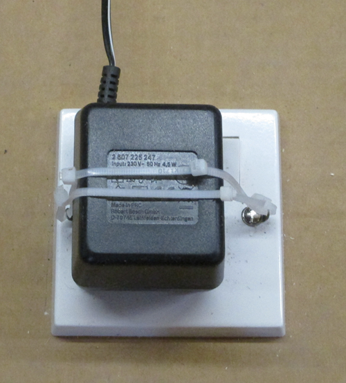

Does it use a plug-in adaptor? It would be worth using an FCU rather than a 13A socket if possible, but if the adaptor is integrated with the plug then there's no option for this.
Why would you favour that, even if it were not a walwart -do you perhaps share winston's concerns?
I have countless things (AV, IT, large kitchen appliances etc. etc.) permanently 'plugged in' for their entire working lives. I could change them all to being wired in to being hard-wired into FCUs, but the only real difference I can think of would be the unnecessary hassle/inconvenience if/when they ever had to be replaced, repaired or moved.
People seem happy with 20A radials with multiple sockets, and it would be very easy to overload such a circuit to the same (pro-rata) extent as would occur if a vacuum cleaner were plugged into a 6A circuit.
Kind Regards, John
Kind Regards, John
Just to stop people taking a kettle into the loft for a brew. Also more usefully will hopefully prevent the alarm from accidentally being unplugged or switched off.
OK- so, as I suggested, it seems that you do share some of winston's concerns?
As I recently posted, if that were your concern (and even if it were a wallwart), then ...
Kind Regards, John
