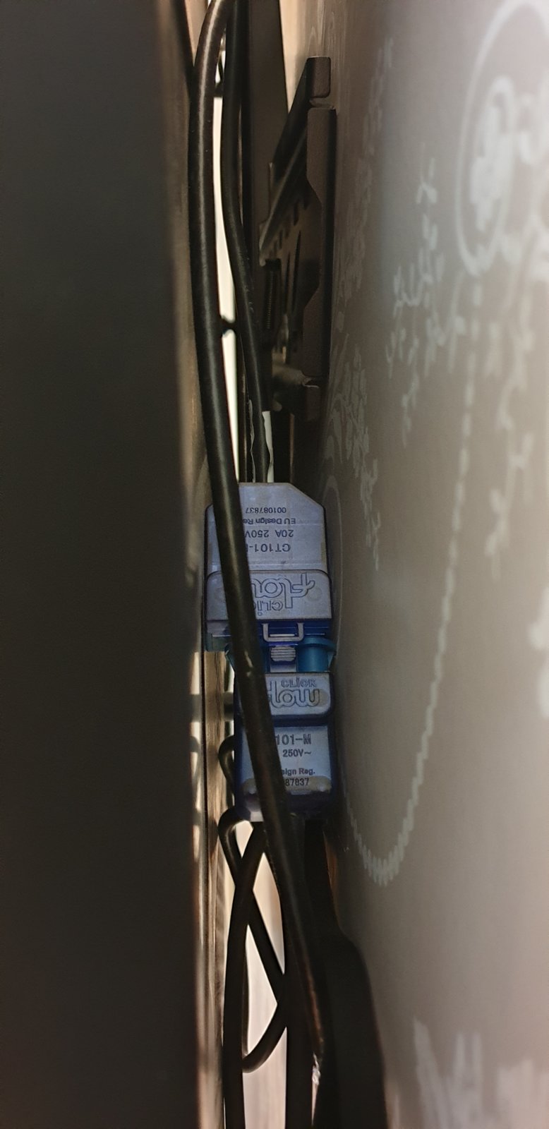

Quick one..
At the minute Ive gone from the fused spur through the wall and behind the telly then used a blue plug to connect the telly and power. But the new telly has a moulded plug and isn't on a kettle lead so I can just swap the blue socket for a one gang extention socket to plug the telly in?

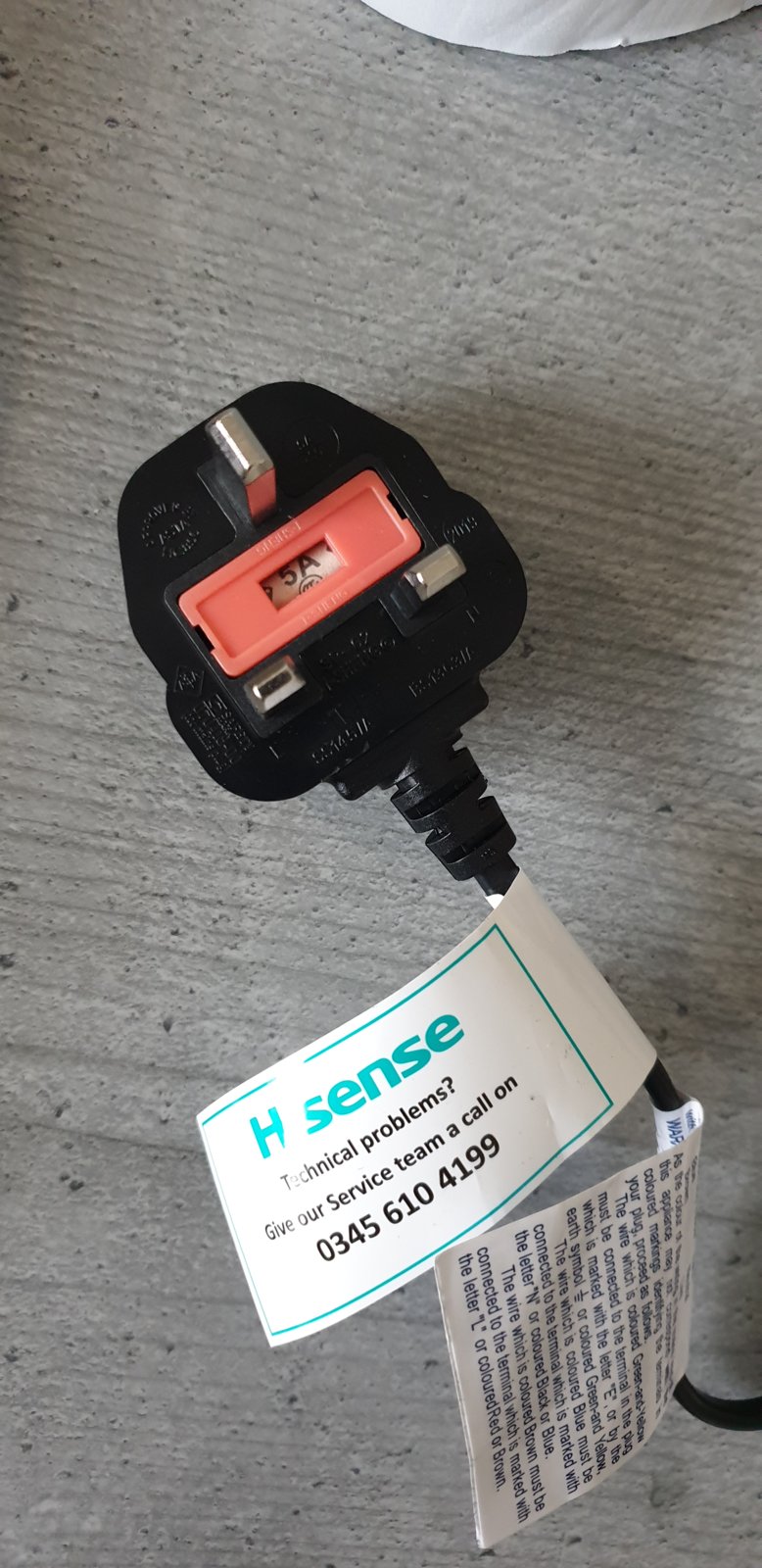

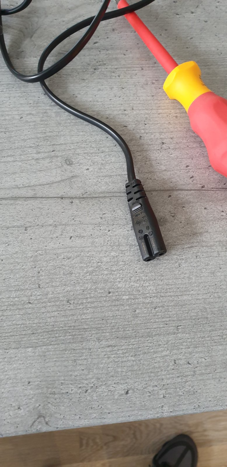

Hi Andy,
This is the plug and the current set up.. could I cut the plug off and just wire the blue plug like the old one?

Yes, I thought that.
If you look at the third picture, 'CT101-' can be seen.
Google search brings up a Click connector and they are - well - blue.
I suspect the colour is probably a red herring.
