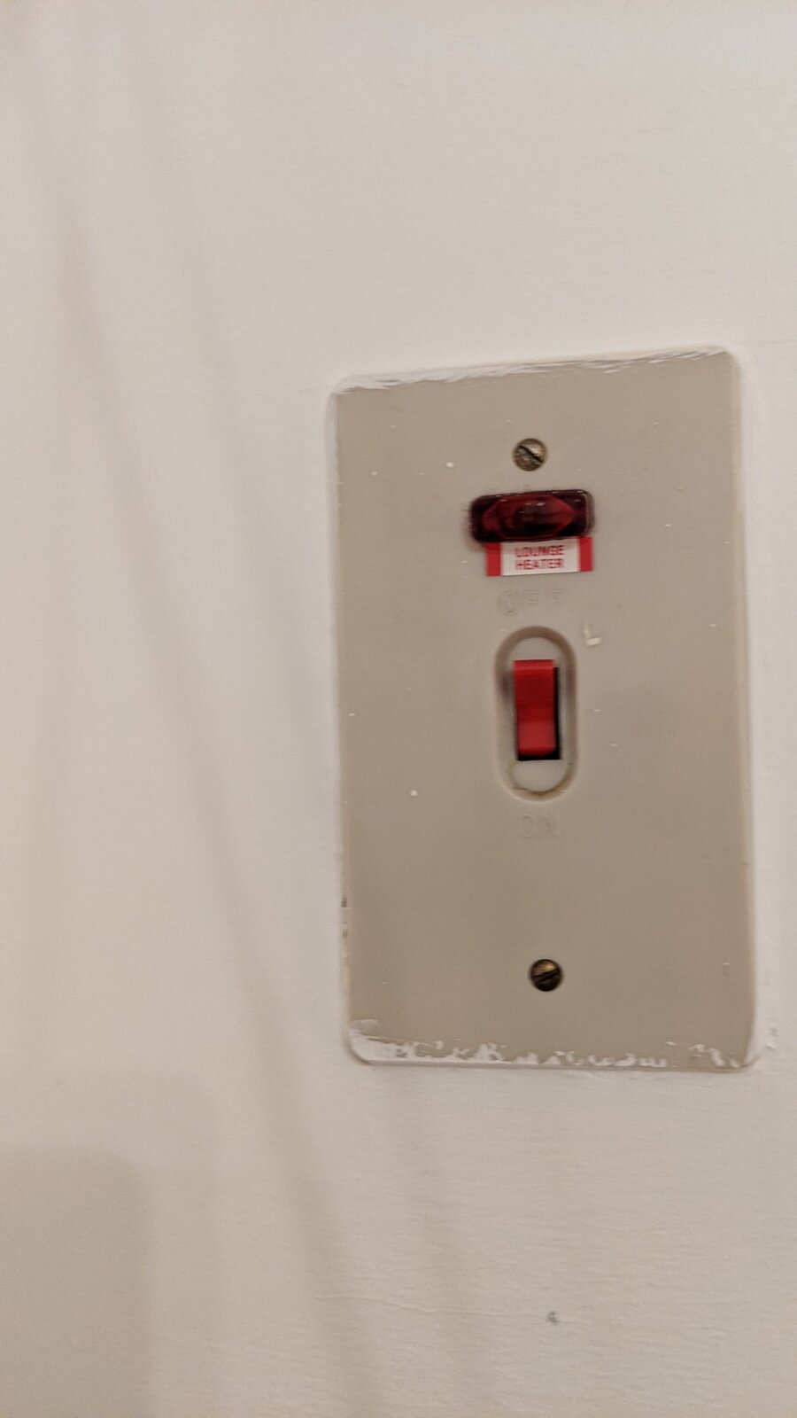

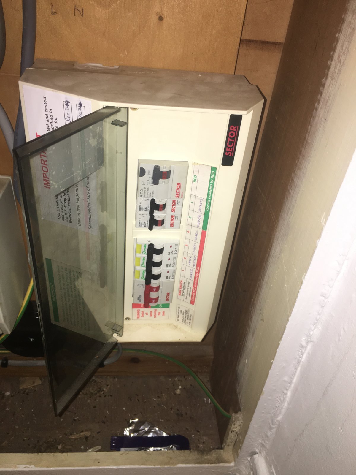

Here is a picture of the switch and the CU. Yeah, I’ve just never turned the electrics off myself. The electrician showed me but I should’ve written it down!

Just get a screwdriver and pop out the little drawer that says fuse on it and take out the fuse... does exactly the same as switching it off
Flick down the breaker labelled "sockets"
The switch in your pic does not look heat-damaged. It might have age-related wear, or grit in the moving parts.

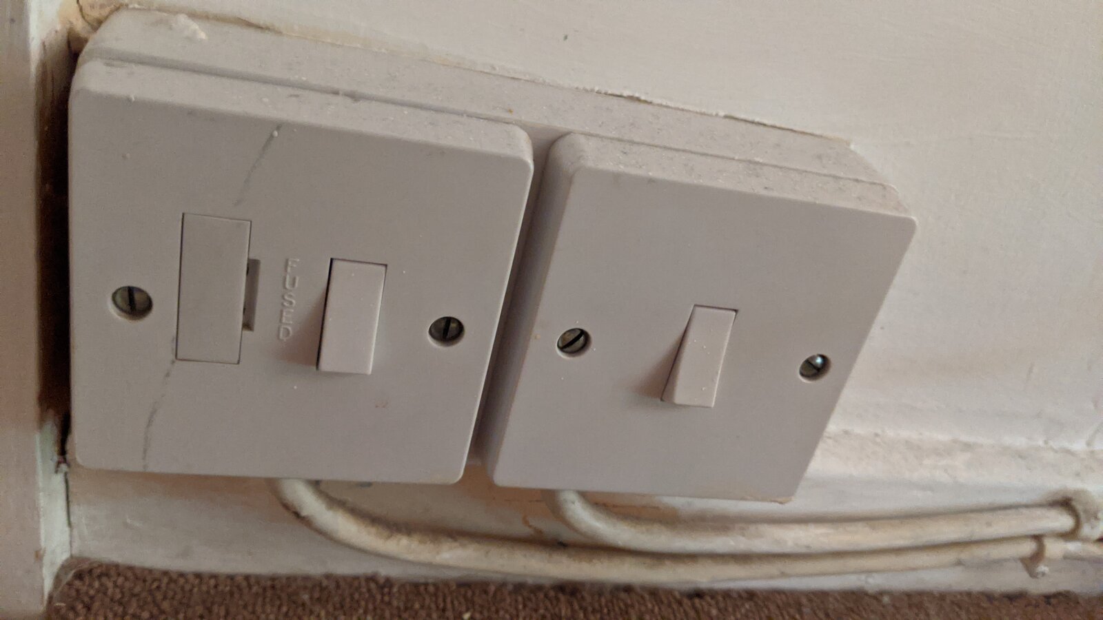

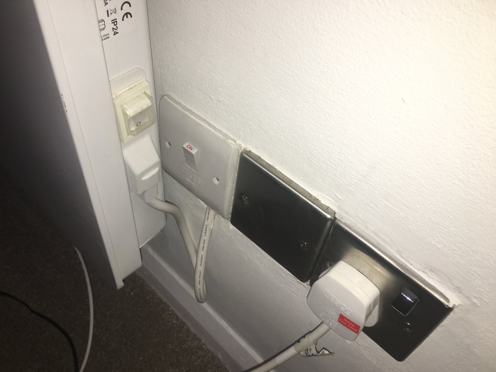

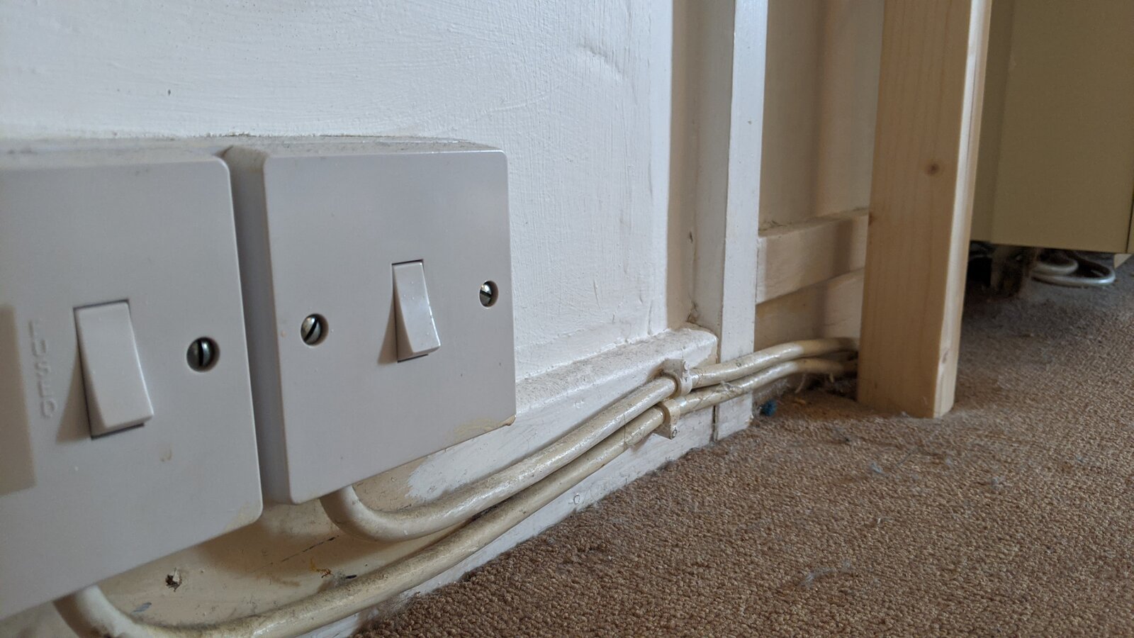

I have similar issues in my studio flat. I turned it on for the first time yesterday and used it intermittently throughout the day with no issues. This morning I woke up and the room smelt like a burnt hairdryer. The heater was hot even though I had switched it off the night before. switched everything off that was connected to the heather. I popped the fuse out from the socket (the picture is from before I did). The heater is still hot and heating. I there something I can do as I am shielding and prefer that an electrician not need to come and fix it

Unfortunately it sounds as though the fuse you've pulled out is nothing to do with the heater.
I can only suggest that you find the cable going into the heater and follow it back and hope to find a different fuse / switch which you can remove / switch off. Otherwise look in your CU (aka fuse box) and see if there's anything labelled in a manner which suggests its connected to the heater and (again) remove fuse or switch off (in the CU the off position will be with the lever down).
Are you sure the switches in your pics are connected to the heater ?
Show us some pics of your fuseboard or consumer unit if you have one .
Is this perhaps a storage heater? They behave differently from normal room heaters. A heater not used for months will collect room dust and smell awful the first time they're turned on.

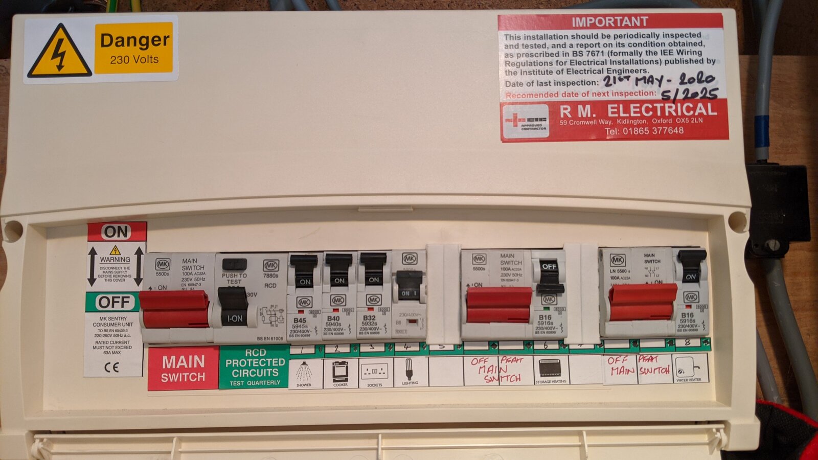

I thought the sockets were connected because the wire ran to the bottom of the heater. Attached is my cu

The circuit breaker marked " storage heaters" is in the OFF position . Did you turn it to that position ?
