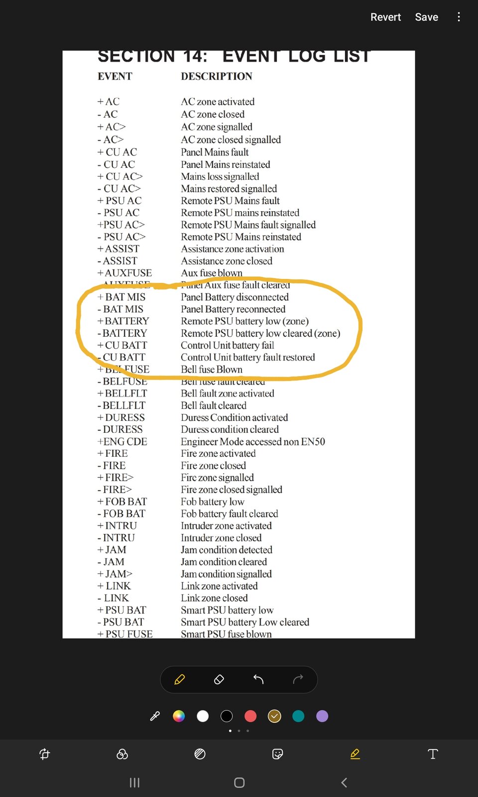

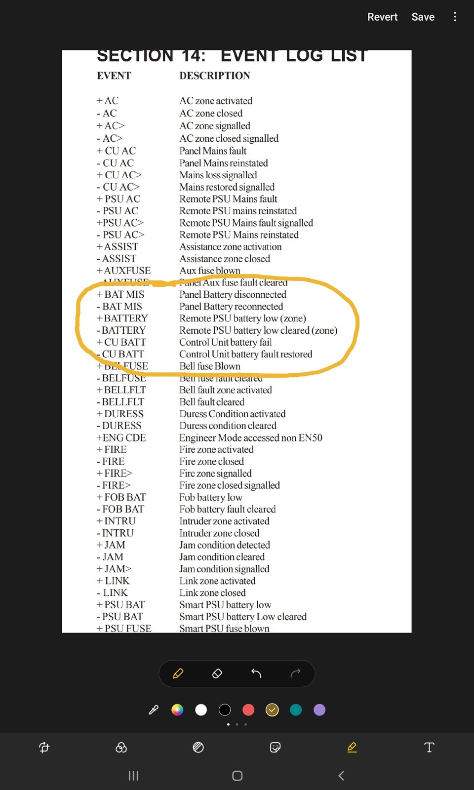

whats the difference between the 2 battery events? i love firmware/software testing - whoever wrote it needs to do a better description! lol
Event log descriptions.
This may be one for galaxyguy.
