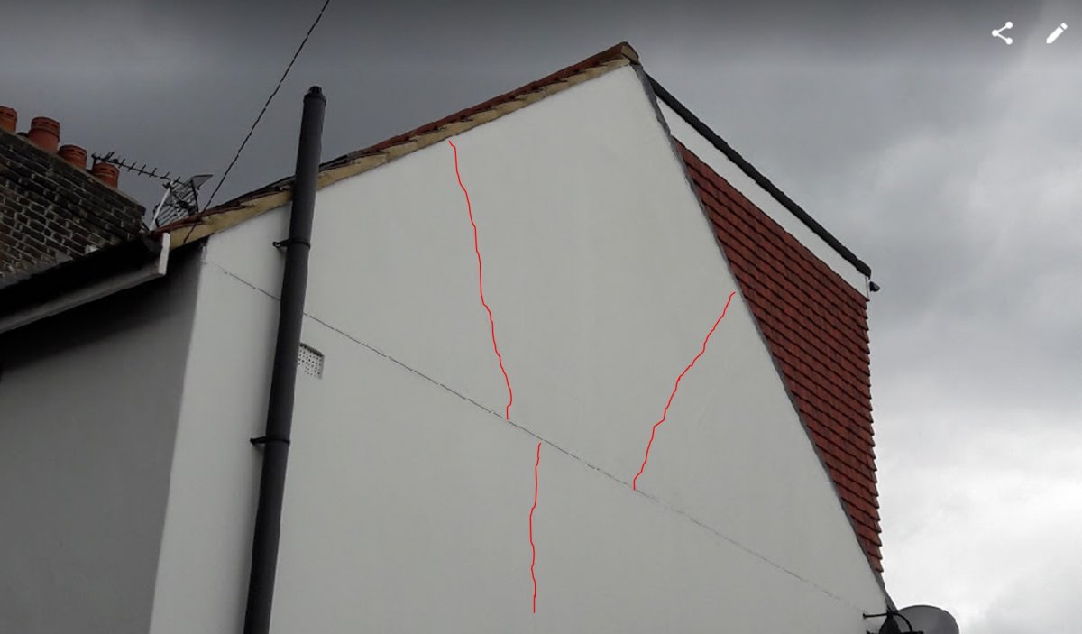

Gable end cracking thru brick
Sorry - meant to include a picture - I'm new to this
Its in the house Gallery
Can you post pics showing any cracks inside the property?
You refer to the render expansion joint I presume.
Have any walls been taken out or lintelled over below the dormer?
Has the gable pike been built with block or bricks - how was it constructed?

There may be other internal cracks that I cant see as the inside has a layer of plasterboard with a inch gap to inner brickwork.
The crack I could see internally mirrors the lhs diagonal crack and is apparent on plastered solid wall in the attic room.
Not sure about the lintel question ( I purchased this in 2013 - extension was donecin 2010).
The gable end is mainly block - with bricks used to fill out the roof connection at the top.
If it was done in lightweight (aerated) concrete blockwork, it could just be normal shrinkage.

But even if its just shrinkage - surely the cracks will need to repaired by replacing bricks - no ?
Any thoughts on approx cost to resolve?
I believe the wall is solid construction with no cavity - but the SE will confirm when he visits in a week
