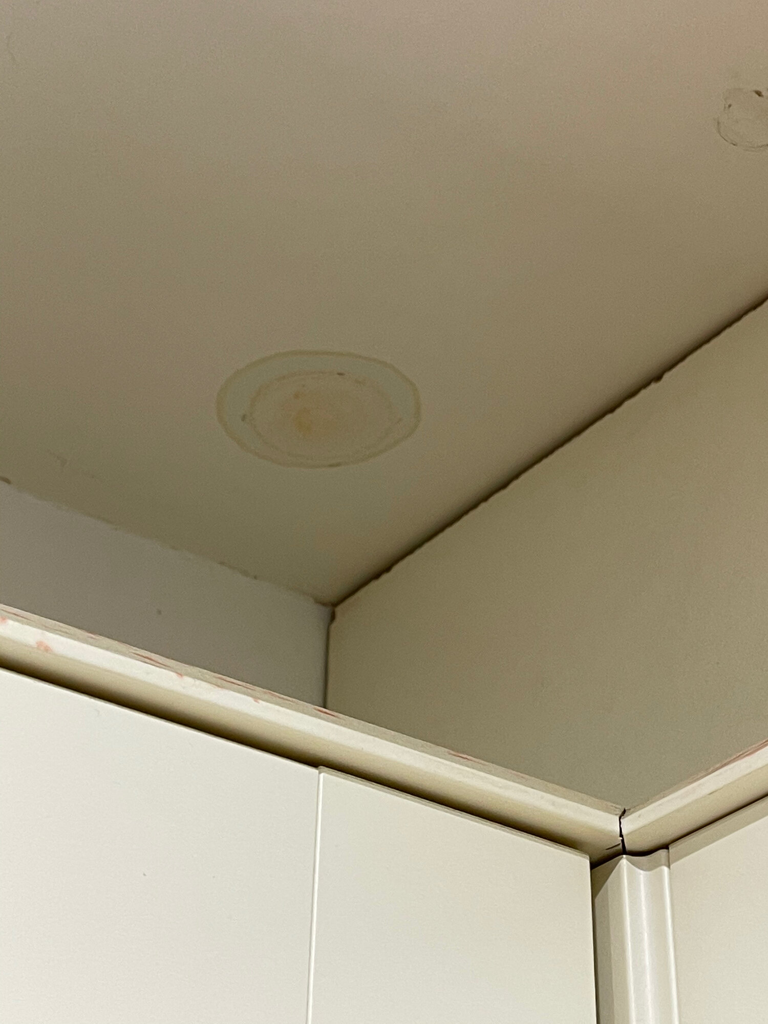

Hi
I have a leak that appears to be coming from an upstairs shower. There's a water stain on the ceiling below that gets bigger every day. Unfortunately the pipes for the shower are inaccessible - beneath a fully enclosed shower cubicle on top of a ceramic tiled floor. To access the pipes from the bathroom I'd need to rip out the shower and rip up the floor - a huge job.
I'm wondering if I can access the pipes more easily by cutting out a piece of the ceiling below. However I have no idea if the leaking pipe will be accessible from beneath if I do this. Does anyone know if it's likely I'll be able to see (and somehow repair) the leaking pipe by going through the ceiling beneath? I don't want to rip down half my kitchen ceiling only to find I can't do anything about the problem from below. But not sure what other option I have!

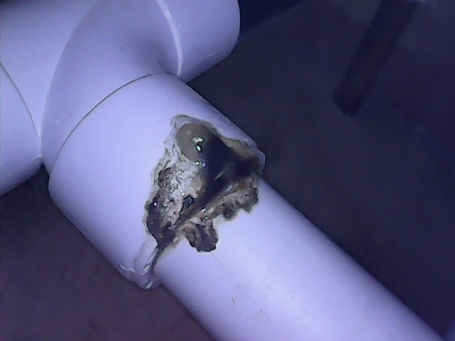

I bought a Draper endoscope camera which is brilliant - and with just a small hole drilled in the ceiling revealed this (see image below). I'm wondering if this is something easy to replace (reasonably competent DIY-er standard) or if I'm going to need a plumber to be sure it's done right?
That joint is solvent welded ( badly).The fitting will need cutting out ,replacing , and pipework ammended to achieve this. And a hole cut in the ceiling ,large enough to be able to do it.
