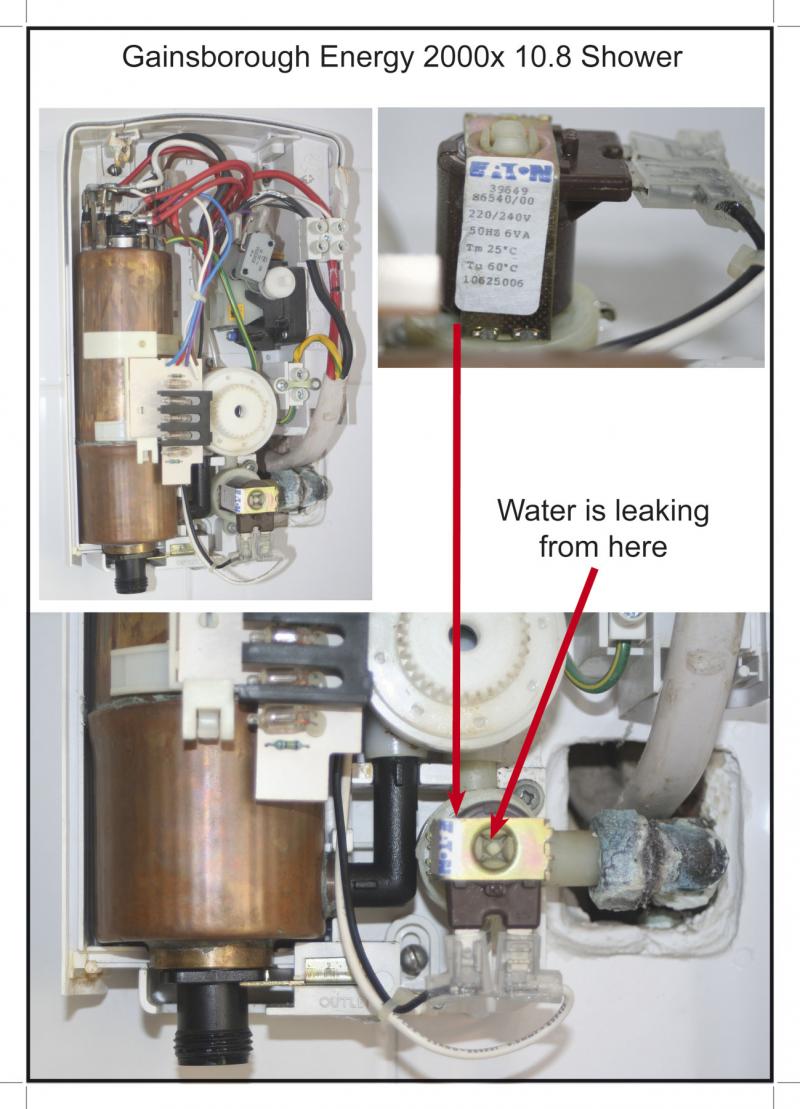

Our shower decided to leak in the middle of last night, so I stopped the electric and water supply and removed the front plate.
It appears that the leak is coming from the solenoid valve.
Being recently made redundant I am looking for the cheapest way to repair.

I have attached an image of our shower.

The existing valve is leaking from plastic tube inside the coil,. You will need a whole valve.
The other one is just a coil. No valve. It just sit over valve.

You be better off getting the whole valve including the solenoid.
Turn water off, and electric for shower off at the consumer board.
Undo brass nut and prise brass elbow away, unscrew valve securing screw, remove it downward from flow control unit.
Fit new one, reuse old nut and new olive. Test on completed. :)
Make sure to keep wires in correct order and on solenoid terminal.
Daniel.

That is part E as shown on photo of parts, it is a small filter that fit inside inlet of valve body.
What you need is part R as shown on same photo, completed valve body with solenoid.

Got the part, installed and all is okay.
So many thanks for your advice Stardanny.
