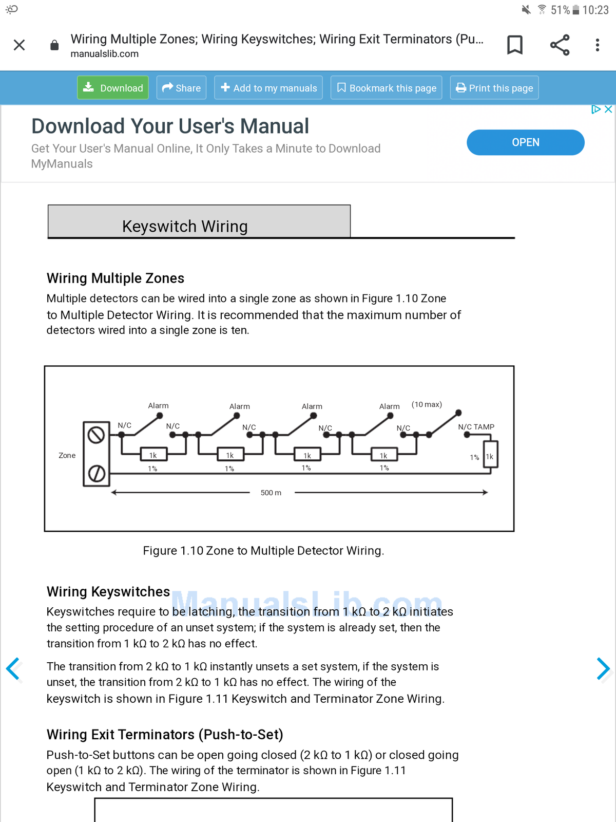

hi i have a galaxy 16 - currently have 8 door contacts and 8 pir but need to add an extra pir
the door contacts are cqr sc570 and the pir pyronix kx15dt
i know i will need to double up 2 sensors onto 1 zone
how can u connect either 1 door contact and 1 pir or 2 pir to same zone i have 8 core cable available

You can have multiple devices on a zone but it is not advised. Screenshot_20210121-102324.png
Wiring diagram shows how this can be done.
