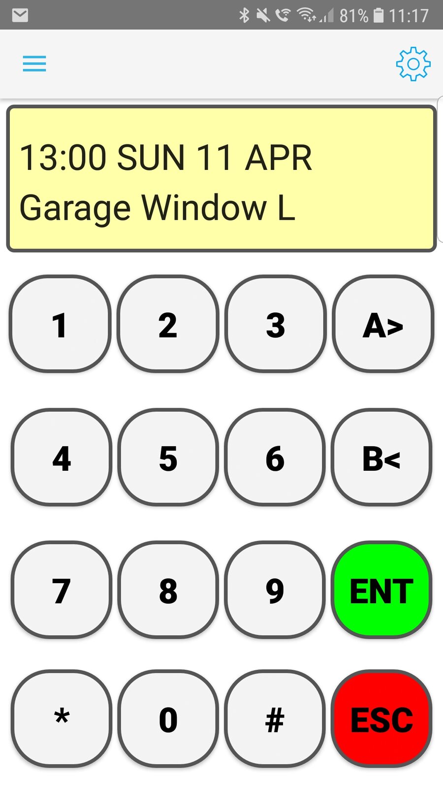

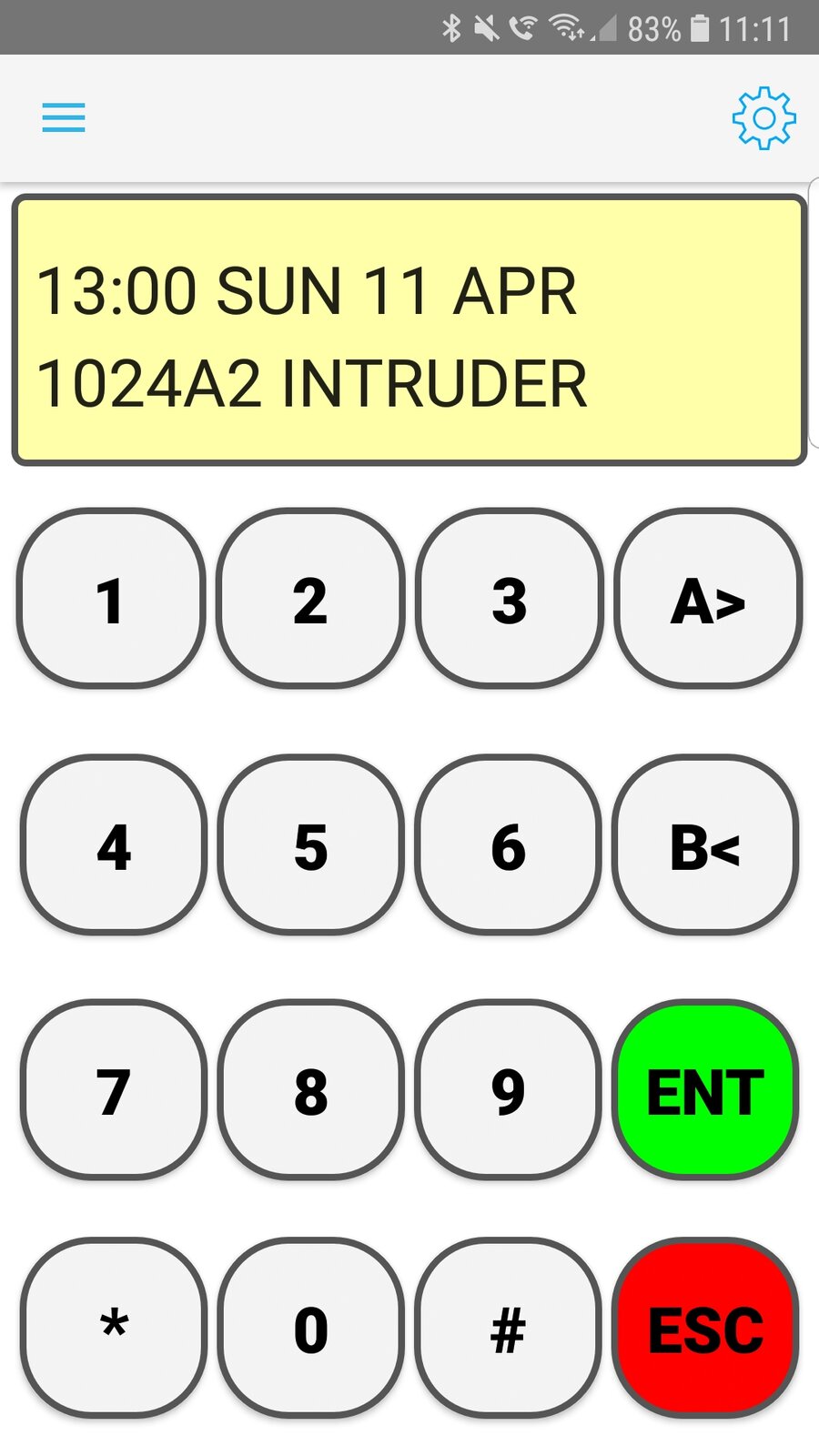

Double check the garage sensor is programmed for group 2.
The sensors are programmed correctly yes, and I should have mentioned the event appears in the event log fine for group 2.

I seem to have a memory that there's a couple of things that Honeywell don't support on the free push notification.
Have you ensured that each groups triggers have been set ? When you program 56.4.2.1.1 there is an option 2 when groups are enabled. In that option 2, you need to ensure the account, IP and port number are the same. I cannot say if Honeywell's push notification supports this, but selfmon certainly does.
