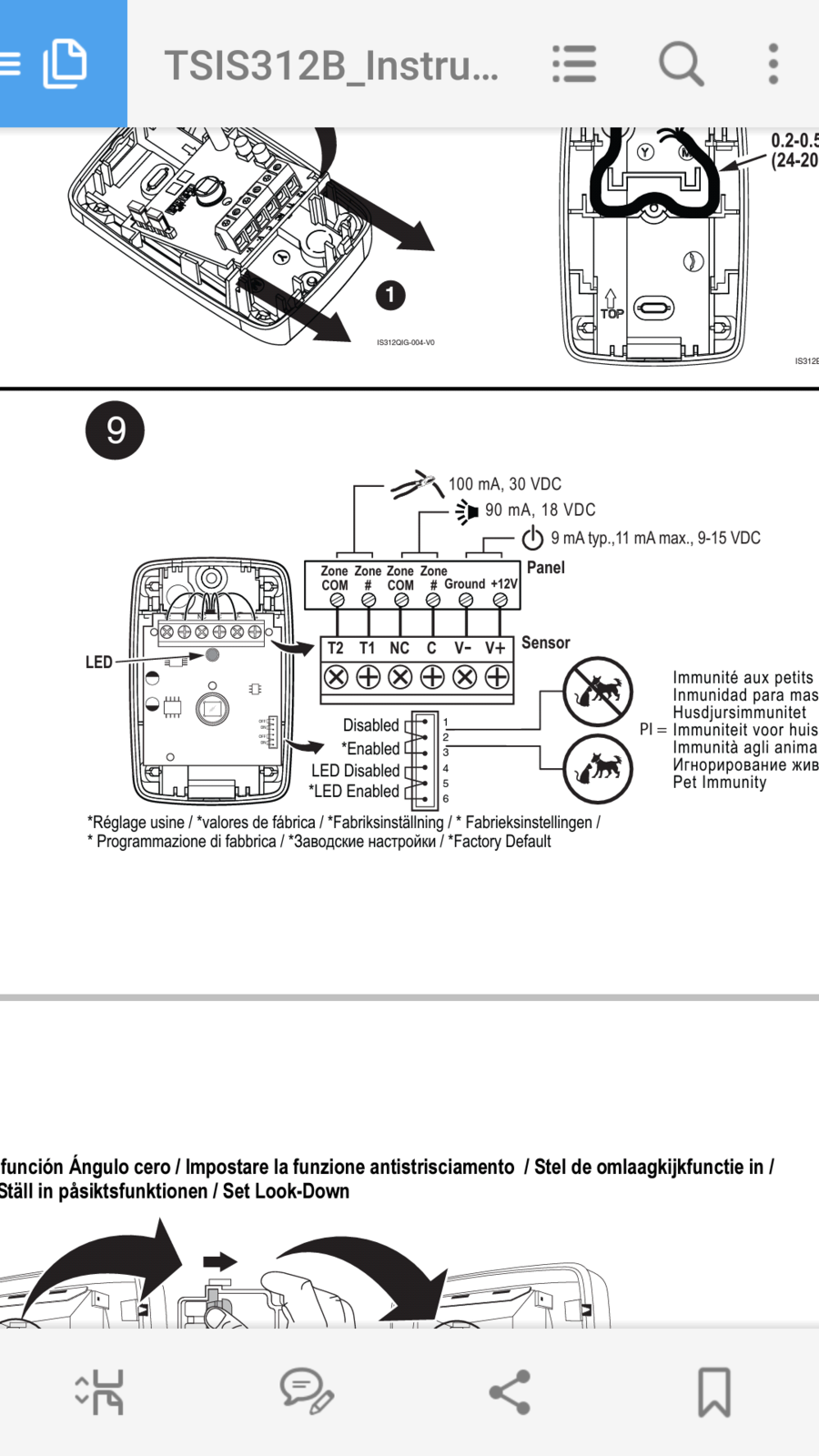

Hi i added a new honeywell pir to the system. When i walk past the sensor the light comes on detecting movement. I need to add the pir on the keypad. I can get into engineering mode but I'm not sure what to do next.
I did a walk test on all zones but it didn't activate. I suspect i need to enable something
Can anyone point me in the right direction please?
You need to program the new pir onto your zones by going into engineering.
Program zone option 52
Hi i did this. I changed one from spare and enabled it. When i went into walk test nothing happened. It makes me think i have not connected the pir correctly. I will have a look.
Could you tell me which ones should be connected please? Many thanks

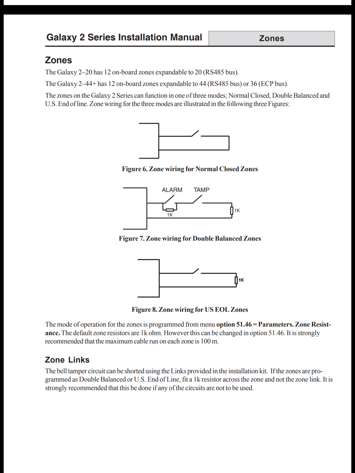

Galaxy control panels require EOL wiring with 1k/1k resistors or a detector with EOL built into it
Ok i will pop to maplins and buy one. I guess its fairly simple after i have that?

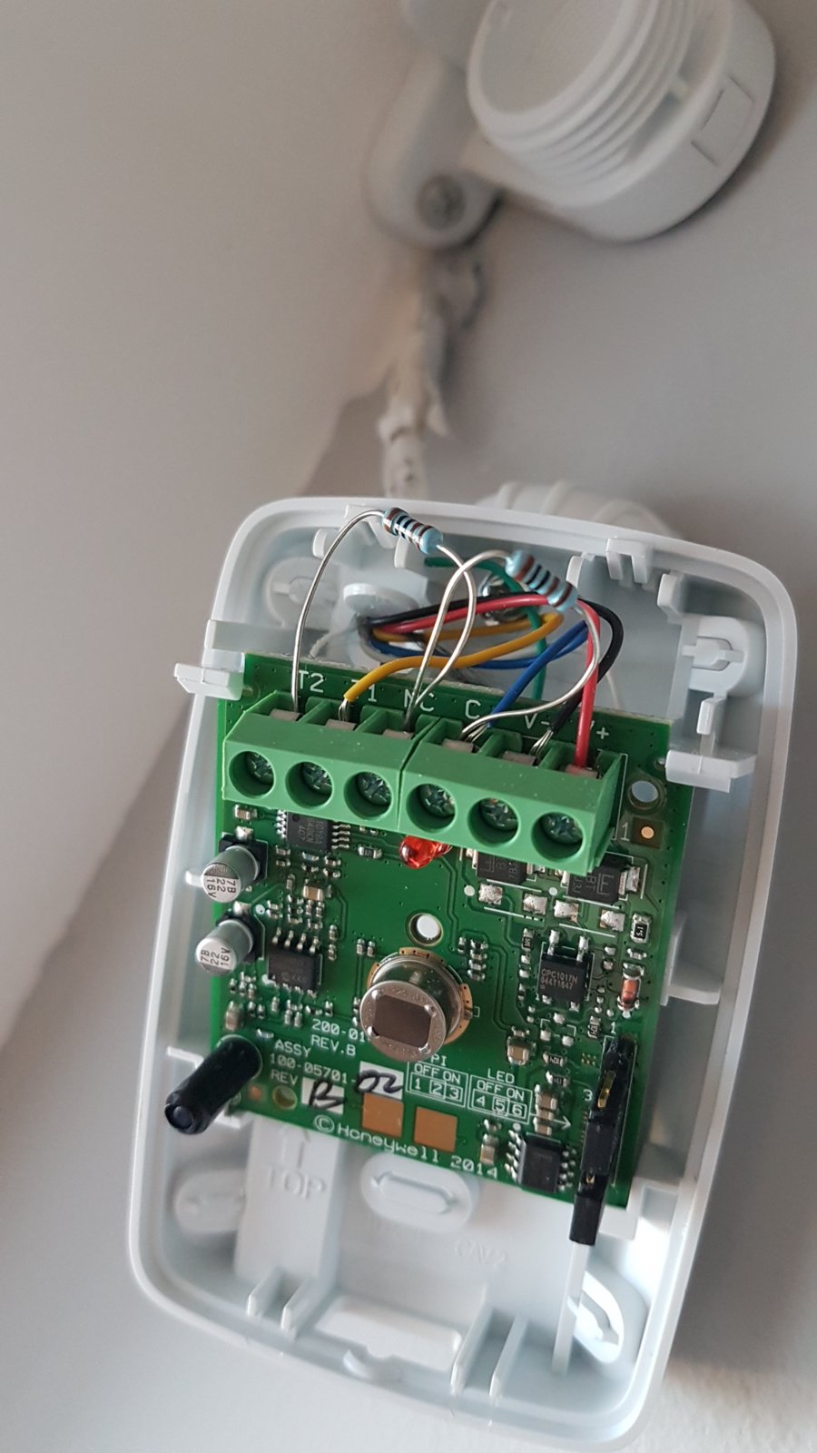

Hi i don't think ive got it right. Zone enabled but on walk test nothing happens. What have i done wrong please? These are 1 k resistors. At the board they are wired the same as the other pir. However the other pir have a different labelling inside
Thank you
That wiring is correct.
Have checked the zone programming ?
You could swap the wiring into a zone that you no works,that will prove the detector and if ok then programming wrong

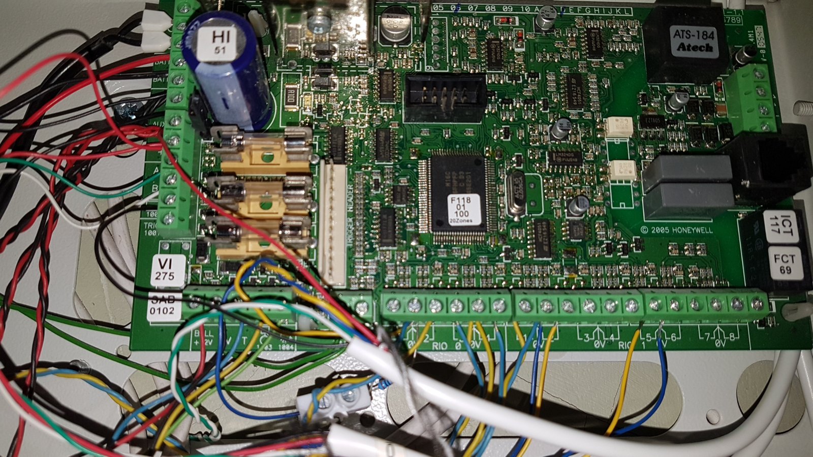

Ive put a photo up of the board. The new pir is on the far right of the photo. Is that correct? From the manual it says i can work the zone number out. I can't from that. Any idea please
What zone number have you programmed the new pir onto in option 52 zone program ?
That's wrong
Should be 1015 and should be programmed to spare and you need to change to intruder
