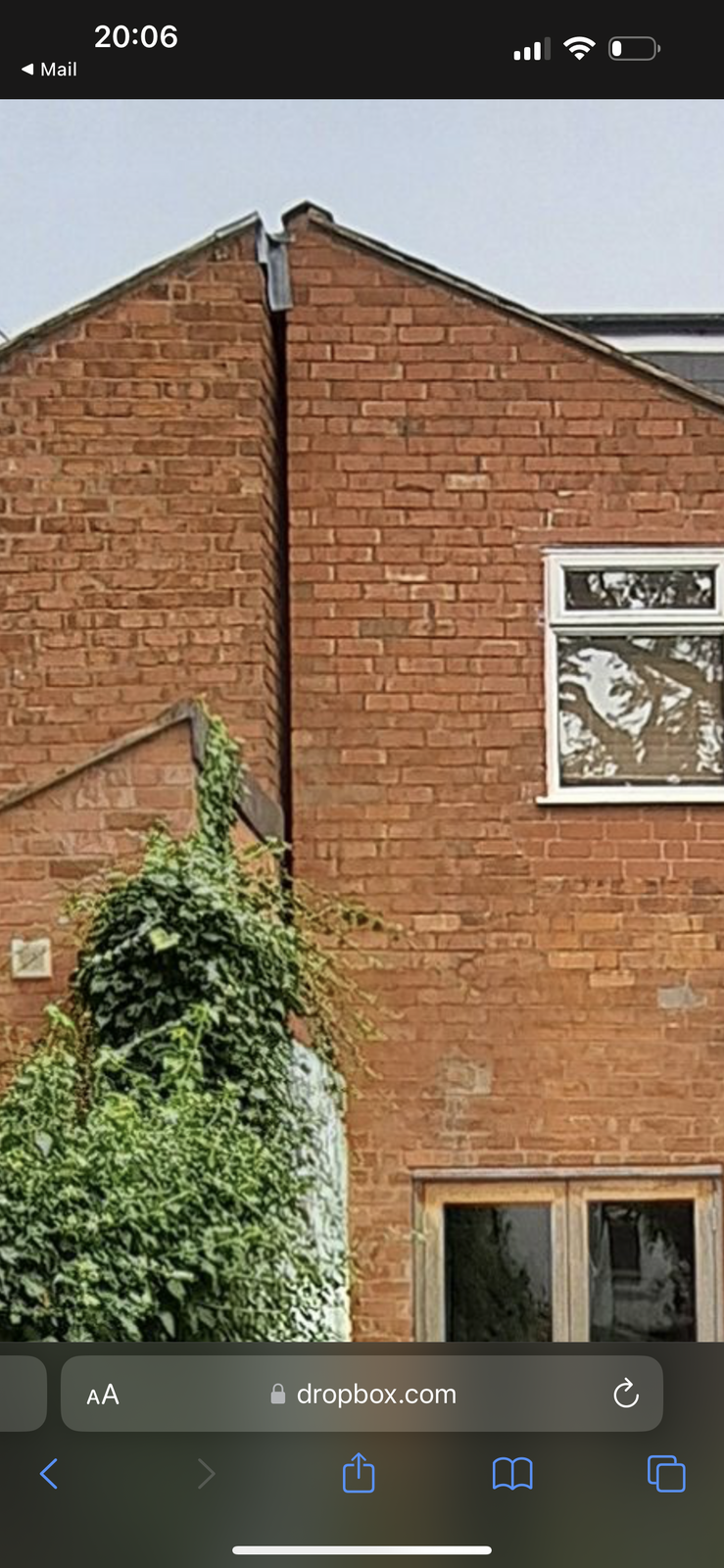

Had a survey done on a house and he noticed a gap between mine and next doors. He is concerned about it and also if it’s built to the correct size bricks. Anyone got experience with this.
Got a better photo? Looks like they're both extensions and neither was prepared to join onto the other, what is the 'surveyors' reason for being suspicious - 'if it’s built to the correct size bricks'? Whatever the hell that means. Surely he should be telling you. Plenty of air flow so what's the problem? Can you look into the gap to see if it's clear or is it full of crap?

he said you wouldn’t know unless you got something in it to drag out any crap. They have felt and lead along the top but the side is exposed.
Yeah terrace at the front but top rear bedroom bathroom, and kitchen is not attached to next door. Looked at other houses on the street and none like this at the back.

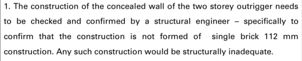

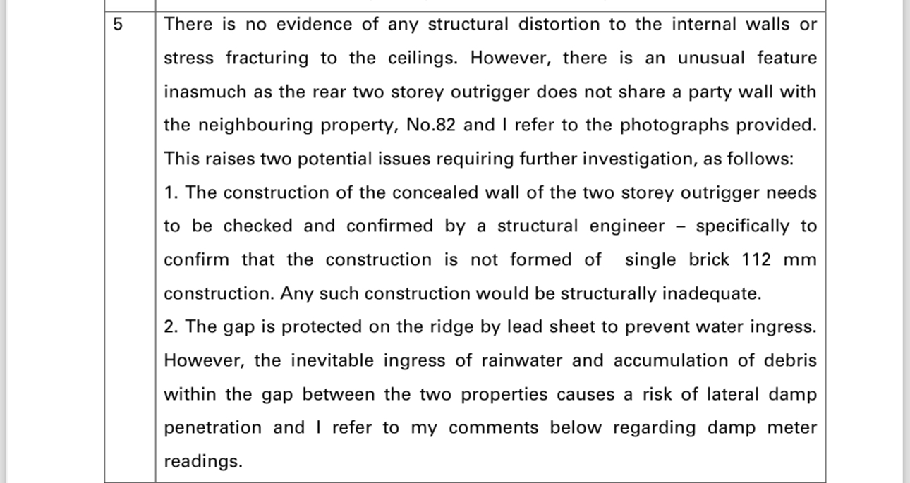

With the brick size I think he means he is concerned it less than 22cm thickness or something like that and not regulations. Suggested getting a structural engineer report, would that give me all the facts.

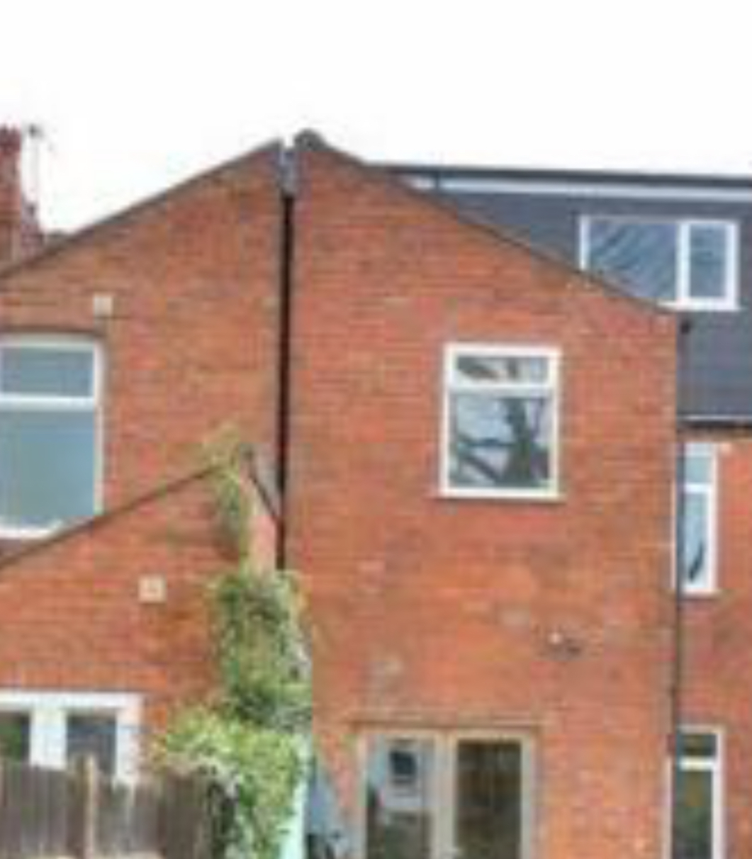

Attached a better quality photo.
Don’t think it’s a dispute, just how it’s been built.
Hmm bit weird, would have been better to leave a gap at the top too. Your surveyor is less than useless. You're not gonna see in there without a ladder. Does the boundary wall just butt up against the gap? How long ago were the extensions built? Brick size thing is a red herring, he's talking crap there.

Might just be a gap to create 2properties independent of each other, it would definitely make a substantial difference on acoustic isolation
If extensions were built at different times, a dispute might’ve been the reason, ie one neighbour saying “no you effing can’t build yours and attach it to my extension
The comment on bricks is just nonsense
Attached the wording of the point he is making in the survey report
Go visit with a tape measure and a 6" bit of wood.
Use the wood to enable you to measure from a point on the window (edge of frame) and to the internal wall on the inside.
Then go outside and measure from the same point to the edge of the outside wall (the one between both properties).
Then take away the std brick width (112mm) and see what's left.
This should be enough to cater for a internal later of brick/blockwork and the std gap.
I don't know what this should be but this is a way to measure it.

What does that mean? Is he asking what the external wall is made from? Why would he assume it's inadequate and not double skin or cavity?
As mentioned, he could have easily have assessed that with a tape measure. I guess he had another four to do before teatime.

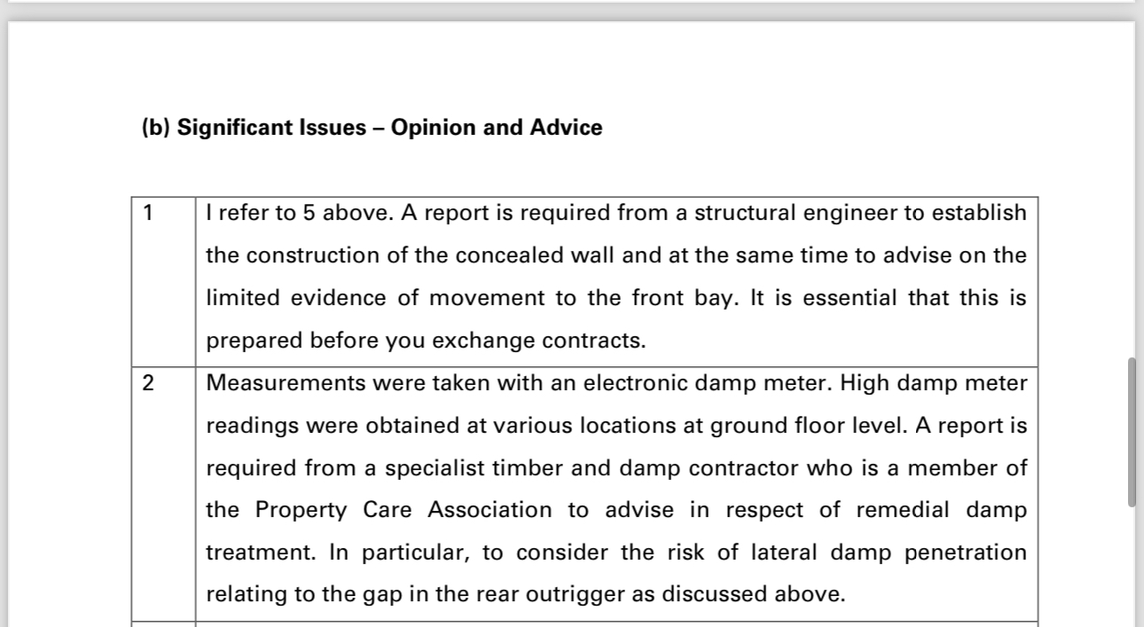

Some further points and yes he uses a damp reader. Is that not good?
