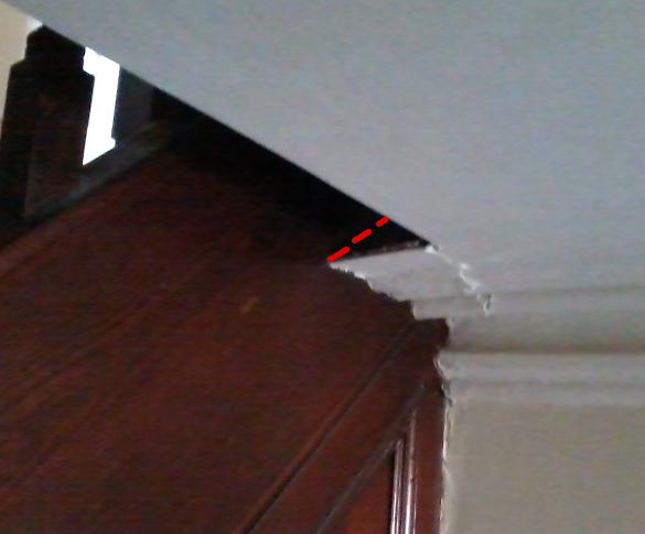

Please help.
Can anyone provide some advice on what to do with the gap between the stairs (Banister) and ceiling. It currently looks like this....
img_1976-jpg.117702
I was aiming to clean and sand it down but what's next?
Thanks for any help you can offer...

You can either leave it with a sharp plastered corner, or decorate it with moulding.* (You'll want to cut away the end of that coving and return mitre it onto the wall)
*e.g:
Thanks for that. If we went with the sharp plastered corner what should we do with the coving? I don't want it to look a mess from above either.

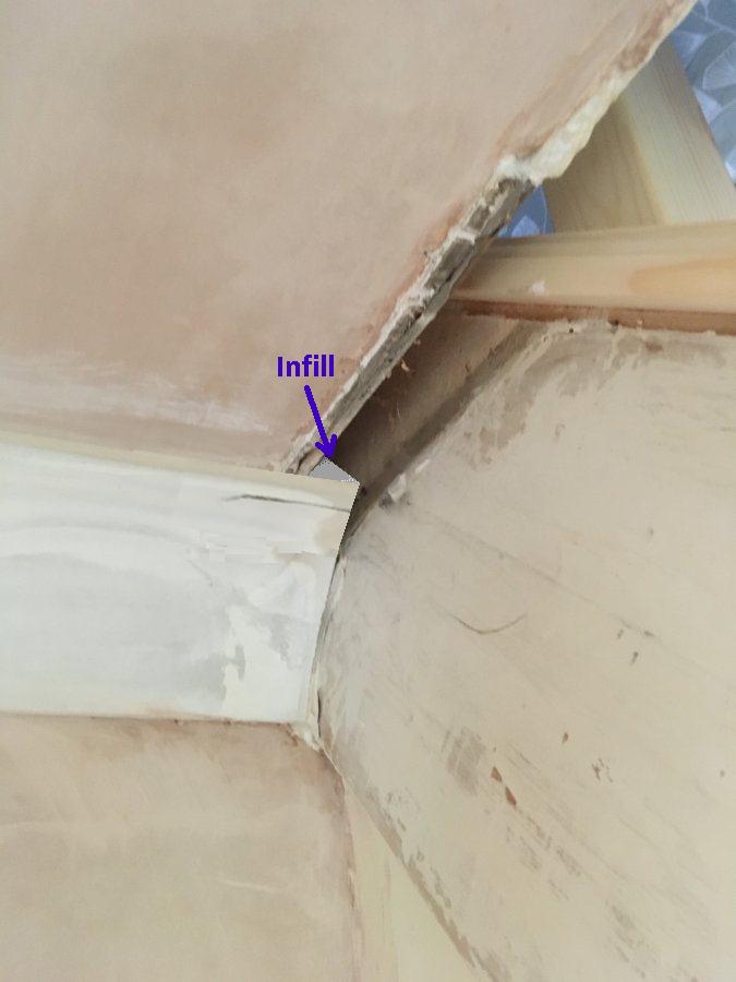

You could do this and infill the gap with some wood
(my house basically does this):
