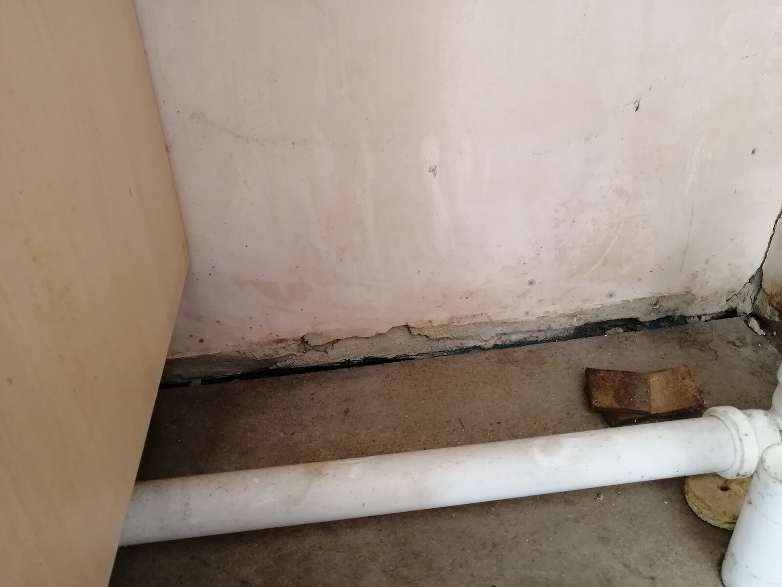

Hi guys
Gap between wall & floor behind kitchen units where no skirting has been fitted:
Leave
Plaster
or take pictures to show friends after the kitchen has been fitted :)
Spray a mist of water on the gaps and then use a can of expanding foam to fill the gaps. If you want to make it mouse proof, wedge course wire wool in first.
Most cans need to be used upside down. Mega_Foam by BondiT can be used at most angles
Edit- sorry, was composing the post before @RandomGrinch replied.
The water helps the adhesion and curing process.
Wear the gloves provided in the lid.
Do not smoke whilst working with it- the propellant is flammable.
If you are messy, have some acetone to hand to clear up any mess, alternative buy a can of foam gun cleaner.
The cans are sold as ones provided with a "straw" nozzle, or to fit a foam gum.
