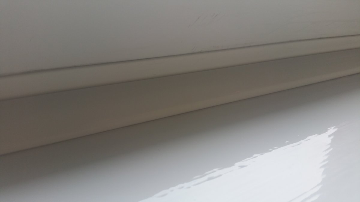

Hi.
As part of decorating the living room I've replaced the PVC quadrant that sits in the right angle between the bottom of the window and the wooden window sill. It's fixed in but there is a very slight gap between the quadrant and window and also the quadrant and sill (see pic). What is best to use to fill/bead this?
Wickes is close so any particular product recommendation would be great.
Cheers in advance!
Low modulus, Neutral cure silicone for PVC to PVC. Caulk for PVC to wood
