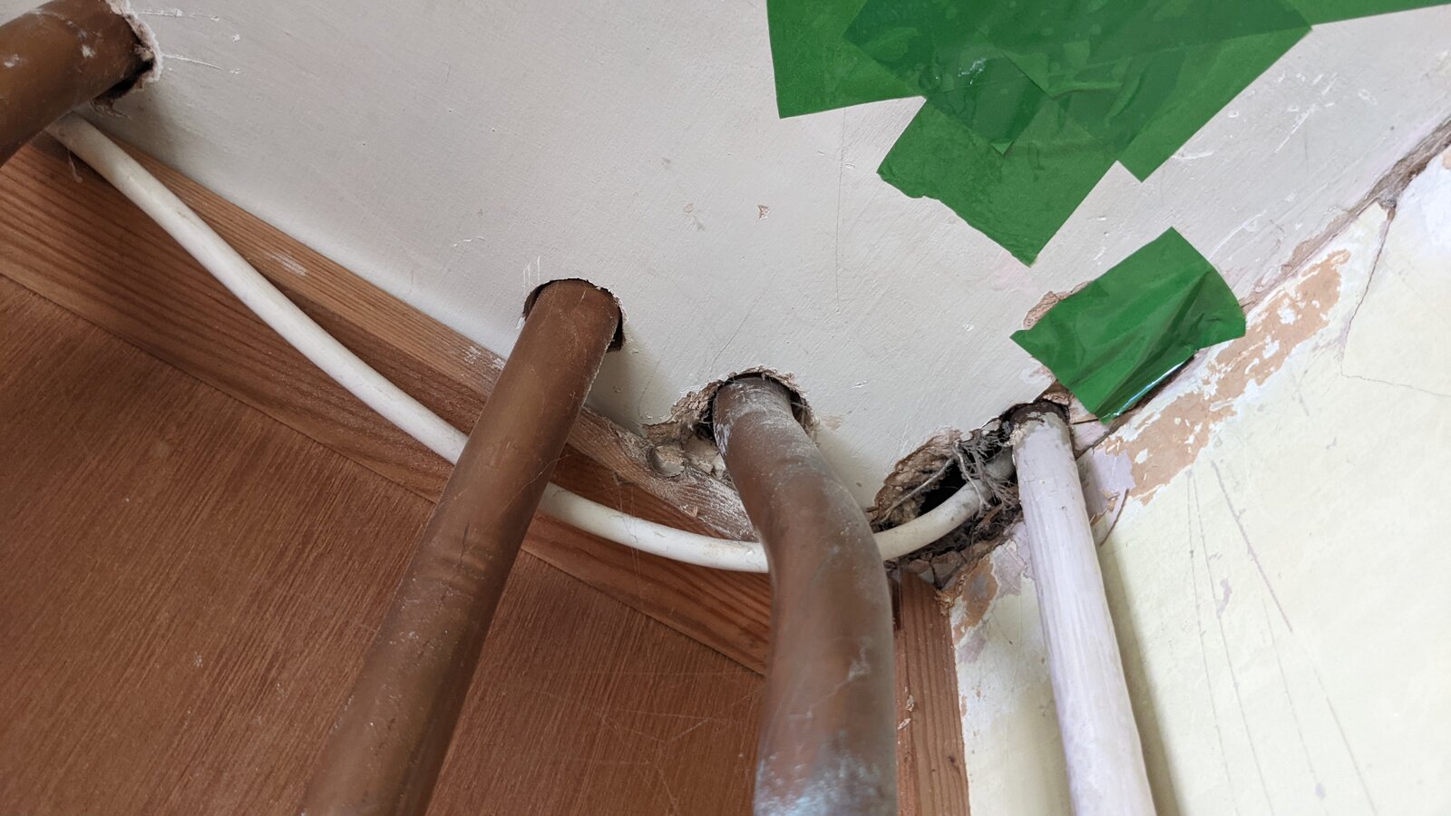

I need to seal around these pipes. 2 of them are hot water pipes, one is water and one is gas mains. Have some mice in the loft; going through the eviction process, and for some reason they haven't been using these gaps to get in my spare room; never the less, I want to seal them just in case.
Don't want to make a mistake and corrode the pipes. Expanding foam, builders sealent? Any help would be very appreciated.

You could stuff the gaps with copper wool - the mice don't like chewing on it, and there won't be any galvanic corrosion, as there would be with steel wool.
And then filler over the top or a foam to fix it in place.

Sounds likes a plan, thank you.
