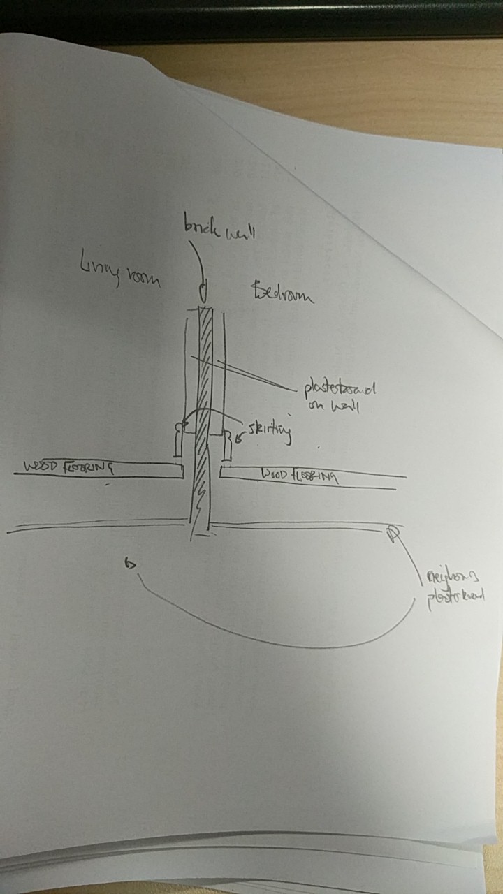

Hi there,
Hope this is the right forum. I got a builder in to install an engineered wooden floor, which involved exposing the joists and also removing the old skirting. While he was at it he put down 200mm of Rockwool sound block, to block out airbourne sound from the downstairs neighbours. Actually this worked pretty well, but they got their ceiling (plasterboard) replaced and we've been able to hear them talking ever since. It's sort of odd, but it's sporadic, we can go for days without hearing them and then suddenly we hear them quite clearly. The workmen who did their ceiling confirm that they didn't disturb the Rockwool that we had put down.
I can see gaps under all my skirting boards, varying from very small up to about 12mm, because the floor isn't perfectly level. The skirting board is quite high (victorian style - 20cm), and there isn't much behind most of the skirting because when our builder pulled the original skirting off he took much of the plasterboard with it. If you tap our skirting (MDF) it sounds rather hollow, I think due to this. I've attached a picture to make it clearer.
I also know our neighbour downstairs put in a ceiling light, so they have a small hole in the ceiling where the light cable comes out (which I believe they didn't have before). I'm wondering if it's worthwhile to redo all my skirting boards to fix the sound issue? A friend suggested spraying expanding foam, but I've never used that stuff before.
Does anyone have any advice about what to do in this situation?
Thanks.

The builder who did the work told me that they were careful with the rockwool, but that they pushed it up against my floor when they installed the ceiling. I can currently use the stiff wire from a coat hanger to poke at the insulation (I bend it at the right-angle, stick it under the skirting board crack and rotate - I can feel there's something soft, which is the insulation). My fear is that perhaps around the edges some insulation fell out, or a gap was created.
I'd love to remove the skirting board, but my builder screwed AND glued it on.. so I'm not sure how exactly to get it off without damaging it.

Just for others' benefit, I basically managed to fix the problem. First I got a small borehole camera and used it to see under the floor. It turned out that the old rockwool insulation I'd put down had been moved - just slightly - in places. Crucially it wasn't touching the wall in some places. Also since the flat is old it's likely the plasterboard wouldn't be a tight fit to the wall either, this effectively creates a gap between their flat and mine. I tried stuffing some more rockwool down the gaps, but it didn't do much (to my surprise). Instead I bought some expanding foam that was rated to 60dB sound reduction and sprayed a small amount of that down to seal the join between the wall and their ceiling, and the wall and my flooring. This has almost completely removed the sound problem.
