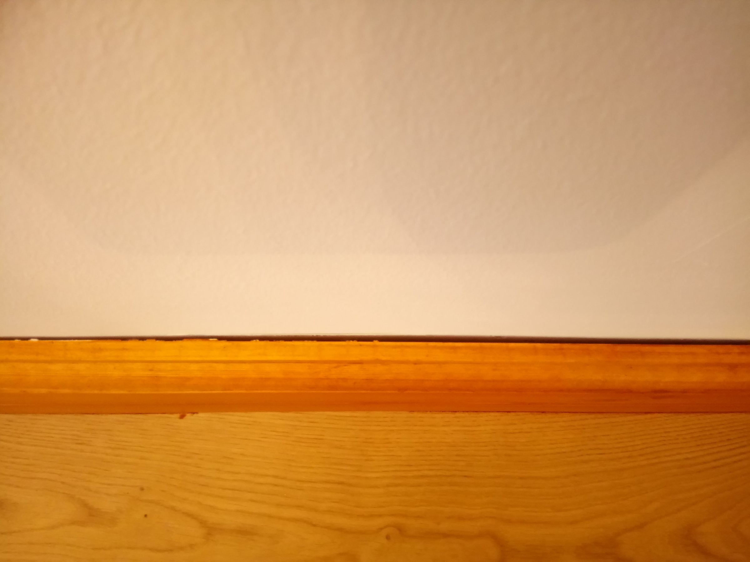

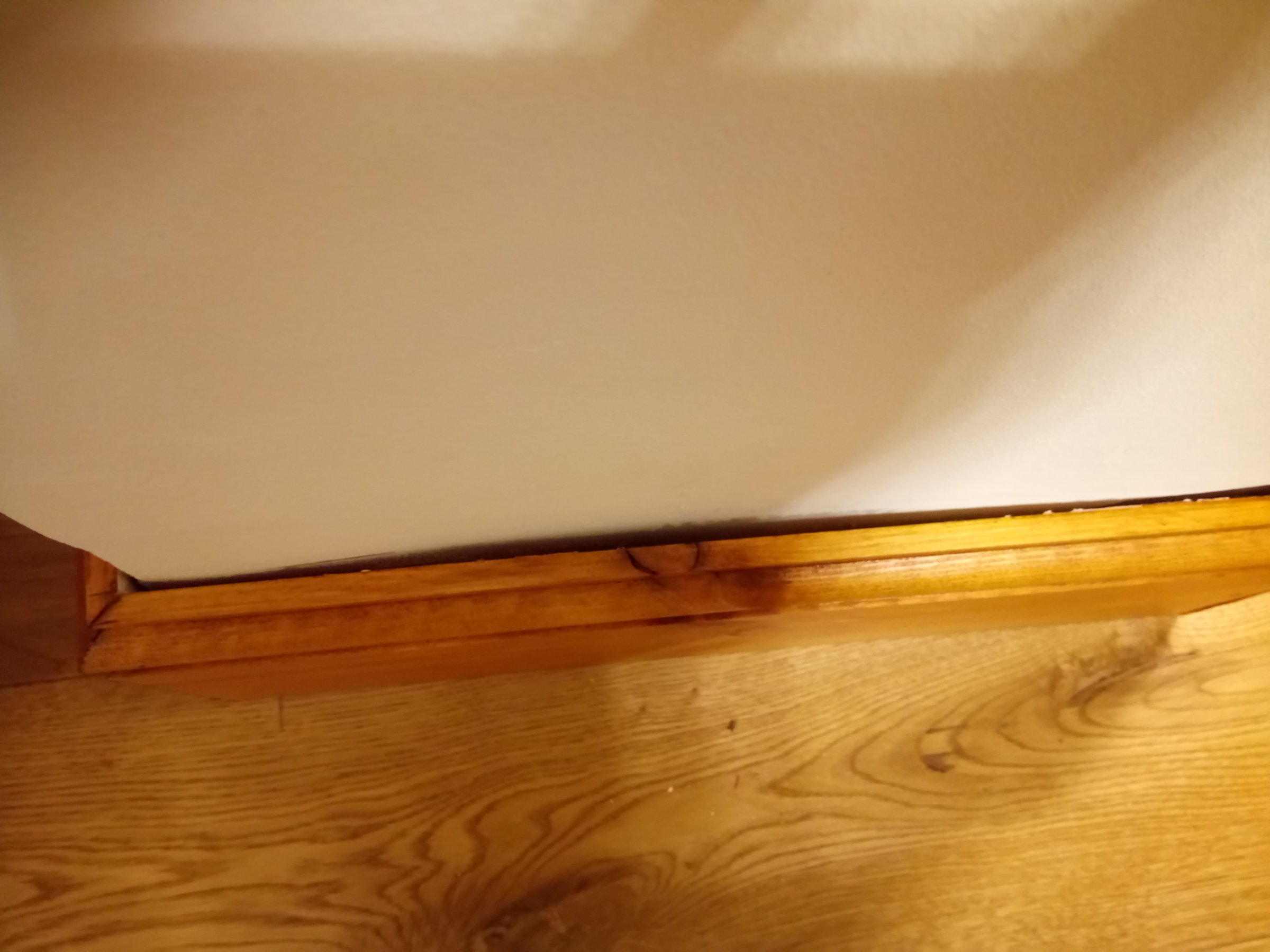

Been having an insurance reinstatement done after a water leak. The builders hired to do it have replaced some plaster and skirting boards. Only problem is there are some fairly large gaps between the plaster and the skirting at points. The builders say the decorators can fill these gaps in if need be. But the decorating company say they don't think it's a good idea to fill the gaps, they say that works for painted skirting, not for stained skirting. Should the gaps be filled in? The smaller gaps don't look so bad, but some of the gaps are quite visible (see pics).

I don't think there will be a problem if I insist. None of the parties are being difficult. The question is more about whether the gaps be filled in. And is it normally the builder who does it, or the decorator? (And who would you expect to do a better job?)

As for the line and level of the new plaster? as post by diydazzler above, simply not the best, But? if you look closely at the miter on the corner? you will see that the unseen section of the Skirting protrudes past the main plane of the wall in the Image, meaning the Builders Joiner has made a bodged job of the miter, there is, in my estimation about a 3 mm / 5 mm. protrusion of the unseen section of the Skirting. Further if you look closely at the miter there are still pencil marks on the top edge of the Skirting that would appear to indicate that the Miter was not cut in the correct position???
As for the decorator?
Normally what happens is that the Decorator arrives and starts his prep which should have included installing "Decorators Caulk" in any gaps between the Skirting and the walls, this is not a time consuming task, materials are as cheap as chips [a tube of Decorators Caulk?]
Given the above, it is my opinion that the Builders Joiner, by Mis-Cutting the Miter it is this that has occasioned the problem in your First image posted above.
