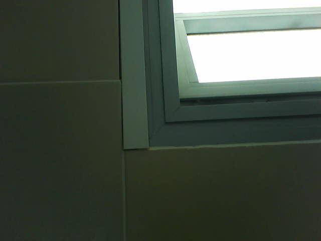

Tiler left gaps either side of window, one is 1.25cm, other side is 3.5cm...
As you may be able to see from photo (!) he's covered gaps with plastic strip and suggested spray painting same colour as have done window frame.
Not happy with plastic strip and he couldn't offer any other suggestions.
Can I simply fill it with grout and paint same colour as tiles? Is there any way I could break down tiles and mosaic (have feeling gap too small on 1 side).
Please help with any ideas! Thanks.
thats one nasty strip added in there, are you sure he is a tiler? id say hes not.
You gotta be kidding me :eek: ,get him to do it again and properly this time,looks very shoddy,no amount of trim will solve that.

my suggestion is a large sledge hammer!
start again and either do it yourself properly or get someone else in,
but first give him the opportunity to do the job again correctly, take loads of pics, get a pro tiler to come look at it and give you a statement, write down a good record of what happened, if he says no take the fool to court to get the re-tiling and the damage to the canopy paid for

So, back to the ops predicament then - expensive tiles with a long lead time for replacement which she doesn't want to go down the line of anyway.
The only thing that immediately comes to mind is to get a small and thin piece of timber the same thickness as the tiles (or as close as possible - 8 to 10mm?) which you fix to the window frame all the way round, with a thin strip of timber, rounded over at the edges (4-6mm) by 40 or 50 mm fixed onto this to act as an architrave, which you can then paint the same colour as the window. Should look quite good, probably better than just a tile edge anyway.
if you still got some tiles or get hold of the same tiles,get the tiler or kinda tiler to cut the tile, glue, end edging strip and stick it
it would look much better
also why hasn't he tilled on the window area????
Missed this one; some sort of more appropriate plastic trim/border or even a light Oak strip is really the only thing I can suggest. The tiles are not even bloody straight; he’s got the layout/spacing all wrong & retiling would involve stripping the whole wall off as no matter what you do with it now, you will never get rid of those little slips of tile, is the other side the same?
I've got to admit I couldn’t live with that & would have to start again. The Spanish are supposed to be among the tiling experts of Europe so why on earth did you use some e-pat tw at who is obviously no tiler & hasn't got a clue :eek:
No idea how what sort of trading standards exist in Spain & whether you’d stand any realistic chance of redress but if he’s running a building firm, I’d certainly try & make his life very difficult locally. :evil:
