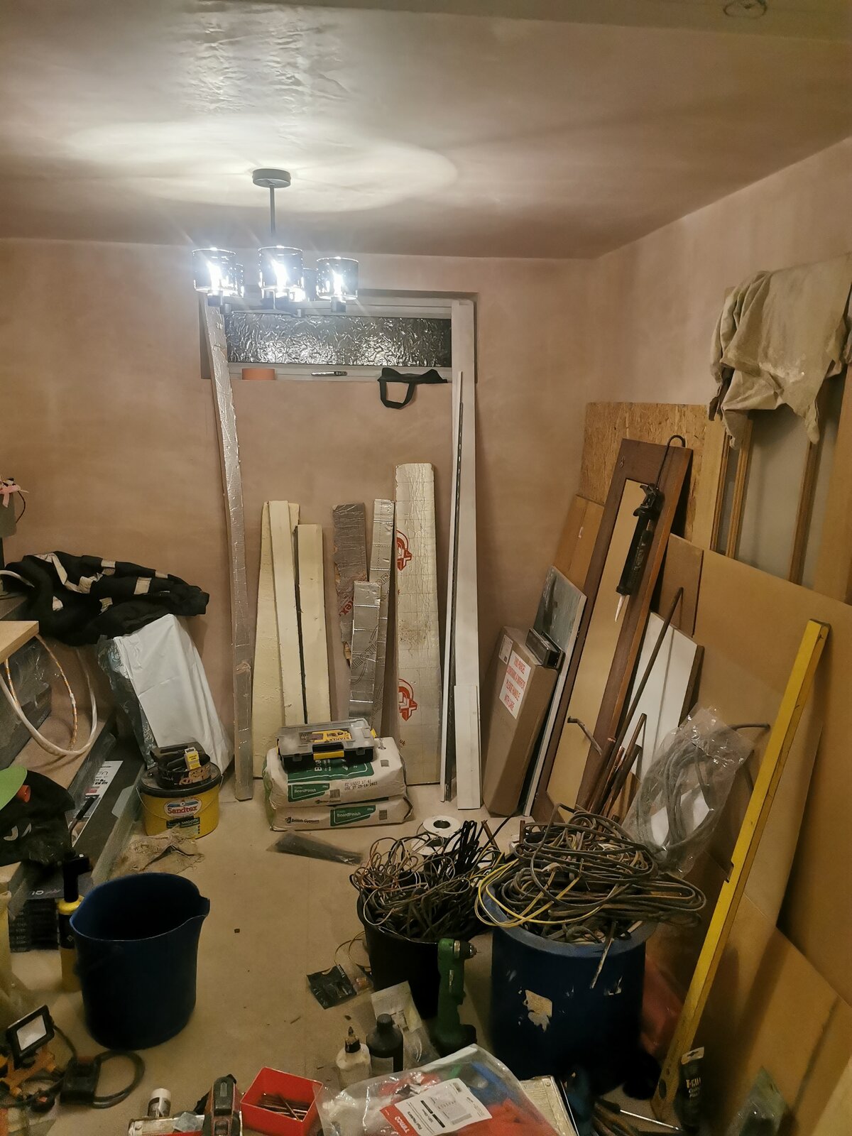

The above picture is mine and we ended up with 220cm floor to ceiling and even with the stupid light the wife chose that hangs down 40cm I can still comfortably walk around, we'll be having a bed in there so the heights not so bad for us.

I'm 5ft 10, I think you'd be ok at 210cm, it will feel a bit low but from a practical point of view it will be fine to walk around in.
