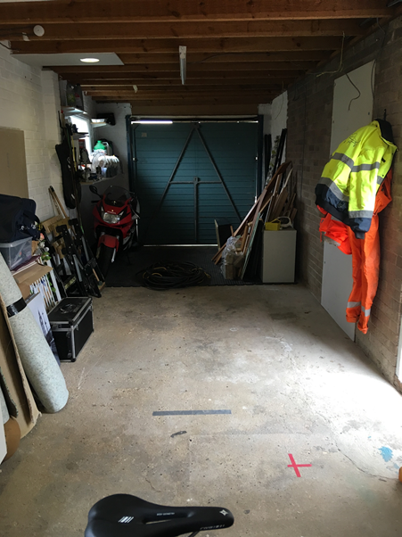

Hi all,
I've slowly been plugging away on my garage.
When we moved in, it had old kitchen cabinets taking up an odd part of the space and just generally not a nice area.
So, I stripped it all out, painted the walls white, with a 2ft band of damp-proof paint along the bottom (the white went yellow at first but this stuff has definitely held the damp back)
Being as the garage is 9m x 3m I wanted to split the space. So I put the partition in and put the Dart board on, on the other side I have no mounted a TV in the corner which swings out, so gives me one position for Zwift (think exercise bike) and one position for Insanity.....or in reality one position to sit on the exercise bench and watch TV and drink beer.
Before:

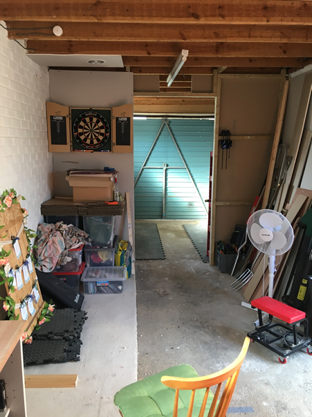

After:
As you may have spotted, I've got downlights in there. I love them! don't take any head room away and give a good beam - plus I got them all for £20. I've got a few more to put up and the sparky is coming in December to double check my wiring and plumb them in properly (currently running off a normal 13A plug - I don't do mains wiring!) Plus he'll sort me plugs around the workbench etc.
So the Bench is slowly progressing - I used kitchen cabinets, just made the job easy. Then used 1" thick mdf on top, and framed it with pine to save the edges. Next step will be to make the fence for the mitre saw
I will be making doors at a later stage and do plan to sort the flooring - as much as it'll be a bit of a pain to clean i'm intending to use hard wearing carpet tiles. I've painted floors in the past but i'm wanting to keep it a little warmer and nicer to work in.
I intend to remove the upper shelves and cabinets. It's just a pain to use, I've ordered more floor cabinets and will be making an assembly table of sorts. More storage and a decent size worktop to put things together.
That's the plan, this then leaves the middle free as a gym/Darts/cycling area.
Lumber storage will mainly be on shelves which will be mounted later.

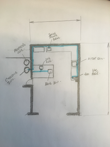

As you can see, I'm currently planning my extract system.

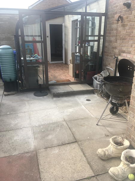

Adjacent to the garage is a "sun room" we use as a dumping ground. SO I was thinking of placing the vacuum in there, and drilling the pipework through the wall, running rigid plastic pipe along the blue line. (recommendations for extract system would be FANTASTIC!!)

Few more bits completed, made a start on the carpet - makes for a much nicer working environment! made a chunk of a start on my assembly bench too which has added loads of storage.
I have 3 lights left to mount on the ceiling and have just had my mitre fence setup arrive so need to make some bits and get that sorted out.

Oooh well why not hang fire and see how cold it gets this winter first. Or the shorter option is a multi foil. Y.B.S do some. as for the extractor. Unless you going to start making money from projects in the workshop i'd invest in a portable one you can move from each machine. Got my sliding mitre set up in loft just attached to vac. When using my plane etc just connect to them.
