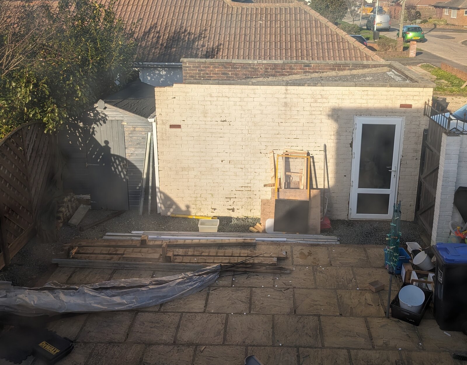

Looking to refurb my garage for as little as possible so going to do full DIY refurb on it. I'll give a brief run down then ask some questions.

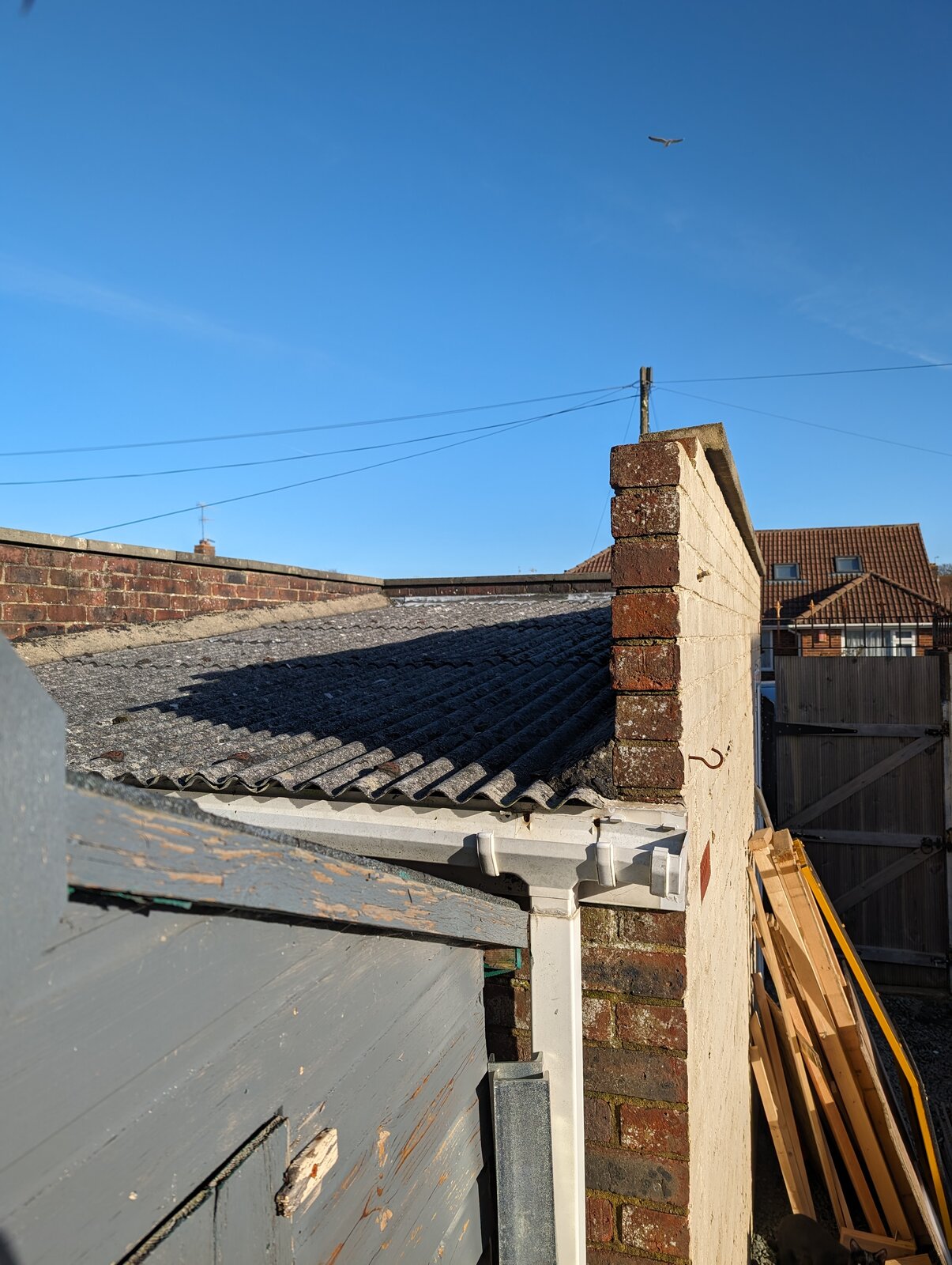

Looking to replace the old asbesto/cement roof, by replacing with a flat roof. The approach I'm taking is to take off coping stones, bed some wall plates on each wall, strap them also and then attach/sit the joists from one wall plate to another. Use firrings to get the required slope then osb and probably just a 2-layer felt system for now.
My plan however is to get 4.8m lengths of wood and leave the excess overhanging into my garden so I can then build a wooden workshop on the side of the garage so they share the same roof. Once the workshop is built the plan would be to take out a bunch of the wall with the correct rsj or lintels to create a bigger work space.
Excuse the mess of the courtyard/side garden I've just ripped up a decking, junk to go to skip that there is no room in the garage for and the plan is to sort it this year (pull up all the slabs etc).
I suppose my main questions are should I possibly look at beefing up the roof joists, just in case I decide to remove all of the side wall and use the new workshop wall to take the load of the joists or keep it simple and stick to my original plan?
When I do the flat roof should I leave the front of the garage as a wall with the coping stones and start the roof right after that kind of the way it is already? Or should I remove the coping stones and start my first joist there?

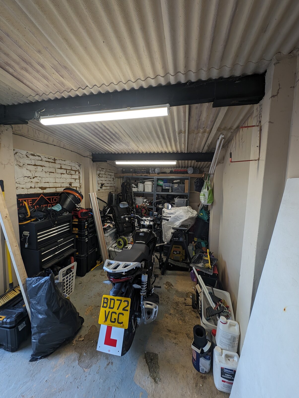

I thought I had lots of questions but can't remember anything else for now. Oh and the plan is to get one of the golfs inside at a time to finish them off but I own too much crap and garage is tiny hence wanting to gain some space and headroom so I can put shelfing up higher.

You might want to remove coping stones + 2 courses of bricks so the new flat roof ends up being no higher than existing - you don’t want a planning issue
the existing roof design with parapet walls is awful, it’s just asking to leak.
I recommend you use EPDM rather than felt - easier for a DIYer to do with out leaks
Appreciate the advice on the wall height I should have mentioned I was going to remove at least one course of bricks as can be seen on one of the photos one of the bricks/coping stone was already loose and I took it down. I believe the max height is 2.5m as my garage is on the boundry.

Oh it sure is and the sheet material condensation is a nightmare too. Not to mention the wasted space, door end is 247cm height inside, rear is 199cm. I'd like to get full height so I can push a car right back and build storage either side and above.

by the way, be careful removing the 2 existing roof beams I would leave them in place until you are ready to fit the new joists - because without them you have 2 long and tall single skin walls.

If you want to extend the garage later and cut an opening between, then plan the lintel and put in place now ready. Don’t fit 4.8 joists unless you intend building straight away - just make the garage roof joists the length the need to be but make sure you leave access to slot in new joists.
don’t forget to fit straps to fit the joists to the brickwork - they are about a metre long so you get fixing in the broickwork well down from the top few courses

Is it damp? It looks it from the photos, the front has lots of salt staining and the paint inside has fallen off the pointing.
As you're embarking on such a major overhaul, perhaps consider just flattening it and start again? Make it the size you actually want and include a cavity wall, which wouldn't be that much wider anyway due to the numerous pillars on the inside of the walls.
Obviously will cost more initially, but possibly not much more if you're talking about extending out anyway.
Damp where it leaks, I wish I had the money to flatten it but also saving for a side extension for the house and not long done basically a complete other floor to house (attic conversion with dormer but the size of it is basically the same as the original downstairs).
Roof and wooden workshop I have the cash to do now.
Can't see too well in the photo but it basically leaks down the walls because of the state of the kerbs (if that's correct term).
