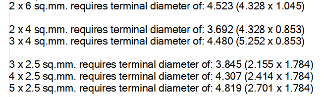

I don’t like people trying to cram 4 x 2.5mm conductors into one socket terminal. There’s too much going on and the makers spec says 3x2.5mm conductors for a reason.
Probably more to do with the diameter of the cores and how they lay in the terminal
Diameter of a 4mm^2 conductor is 2.25mm
Diameter of a 2.5mm^2 conductor is 1.78mm
We have been here before:
The first number in the brackets is the ratio required of the terminal size for the number of strands/cores (obviously for two cores it would be 2).
The second number is the diameter of the strands/cores.
As you will note; 3 x 4mm² (21 strands) requires a larger terminal than 4 x 2.5mm² (4 strands).
