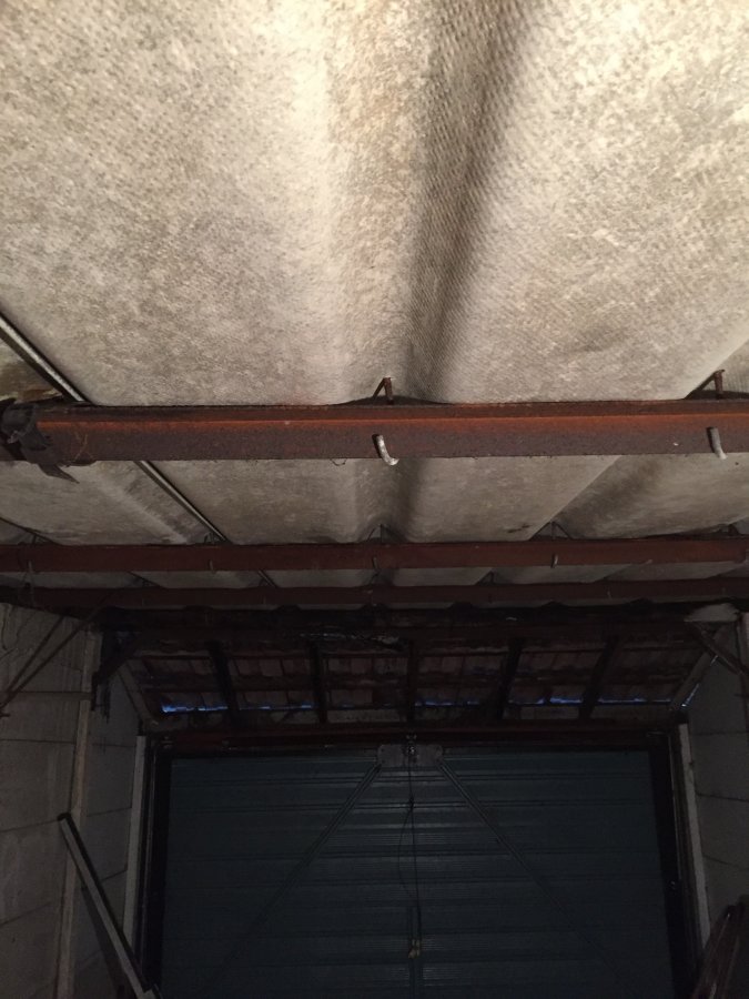

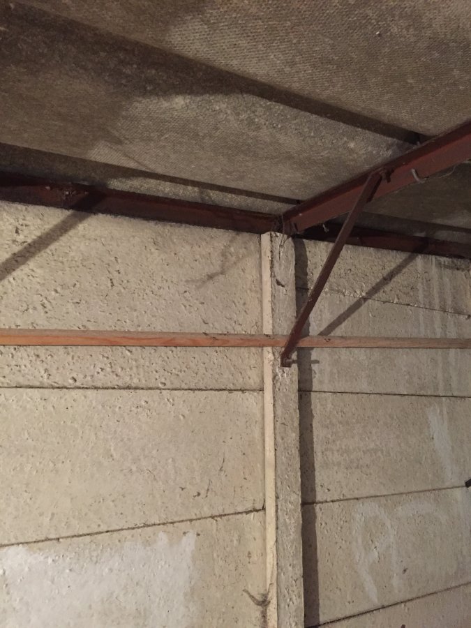

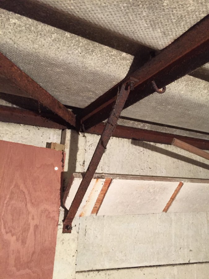

After checking today i don't think hanging fluorescents will be an option, because the height of the garage is only 2m, plus the construction of the steel trusses/frame combined with the flat roof sitting directly on them makes it very difficult to fix any girder clips, or run any cable/conduit.
So i think i might have to revert back to my original plan, do you think wall lights is a viable alternative? I was thinking bulkheads for ease of connecting conduit due to everything being surface run.
Can you post a picture of your garage roof?
I'm sure there will be a simple way to attach a light to it. Overhead lighting has been a much better solution in every garage I've ever worked in.
I have taken some pictures as requested. If you can't see any workable way of fixing fluorescents i am still open to the idea of fitting lights on the walls.
