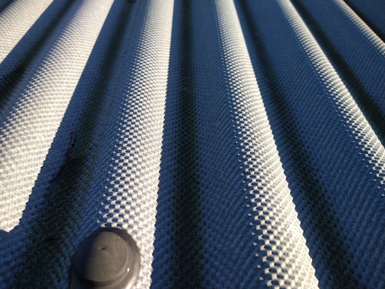

Hi,
I'm contemplating moving a concrete garage. Every time I've mentioned this I get warned about asbestos in the roof!
I think it might be tin, a magnet will stick to it. Did they mix asbestos and metal? Can I safely remove it?
thanks

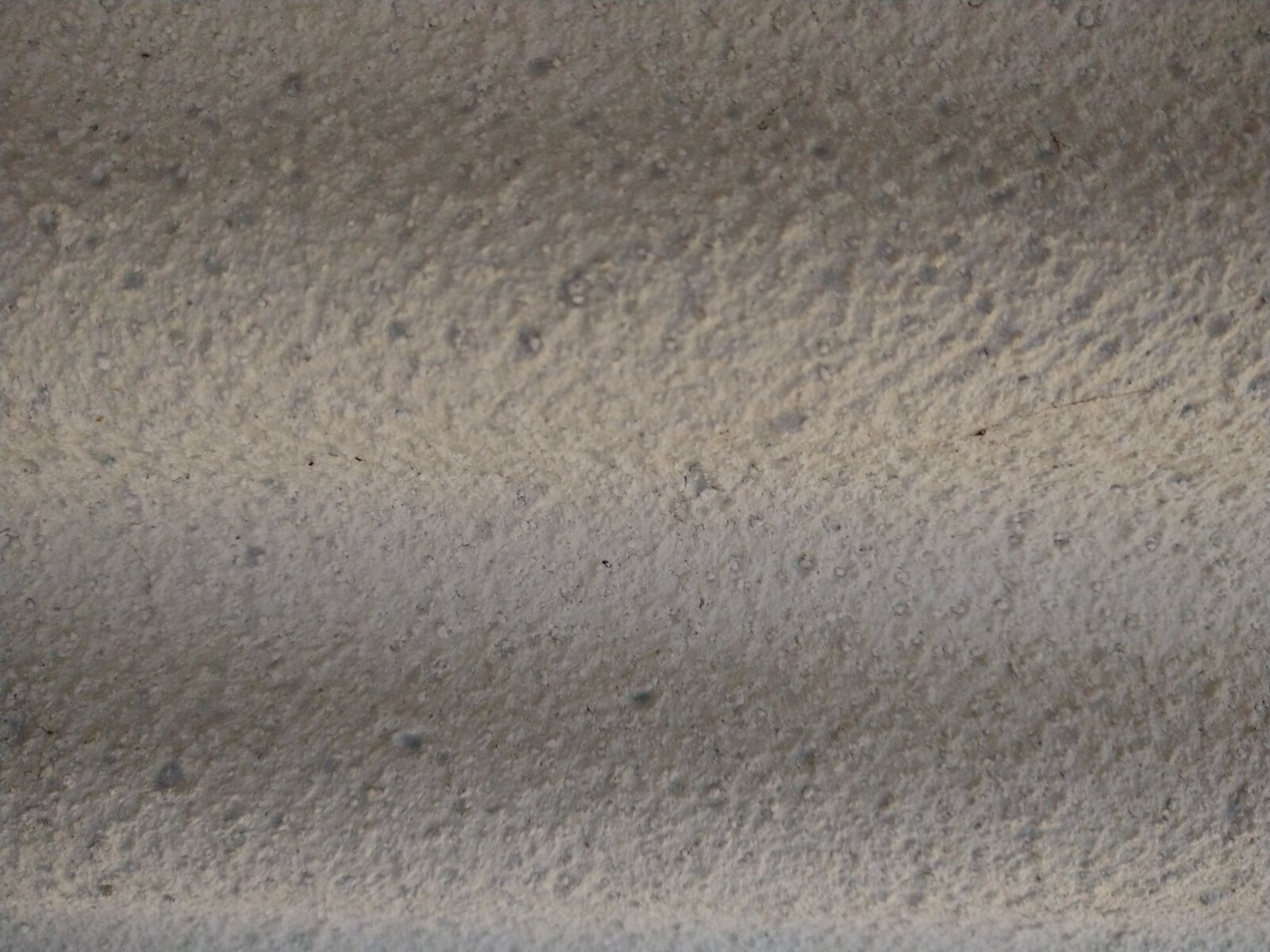

Not on a nail ;) While the top is certainly magnetic the underside is more concrete looking (pic) and very weakly magnetic
I have never heard of magnetic asbestos. It looks like asbestos, right shape and colour, though not the detail of the embossing. That is far too deep and regular.
Paramagnetic is the term, hence why I don't think you would be able to detect it with a handheld magnet.
Being magnetic, it suggests steel or iron, so could it be a coated iron/steel roof?

Magnetic asbestos? :cautious: They would be cement and fibre no metal or iron, and no contamination else the sheet would rust and split.
Metal roof sheets would be steel with a galvanized coating, not tin. And it would be the steel that is magnetic not any tin coating.

I've just checked some different ACM and not remotely magnetic.
The tin paramagetism is moot as there will never be a pure piece of tin around our homes, as it will only ever be in the form of a coating of magnetic steel.
