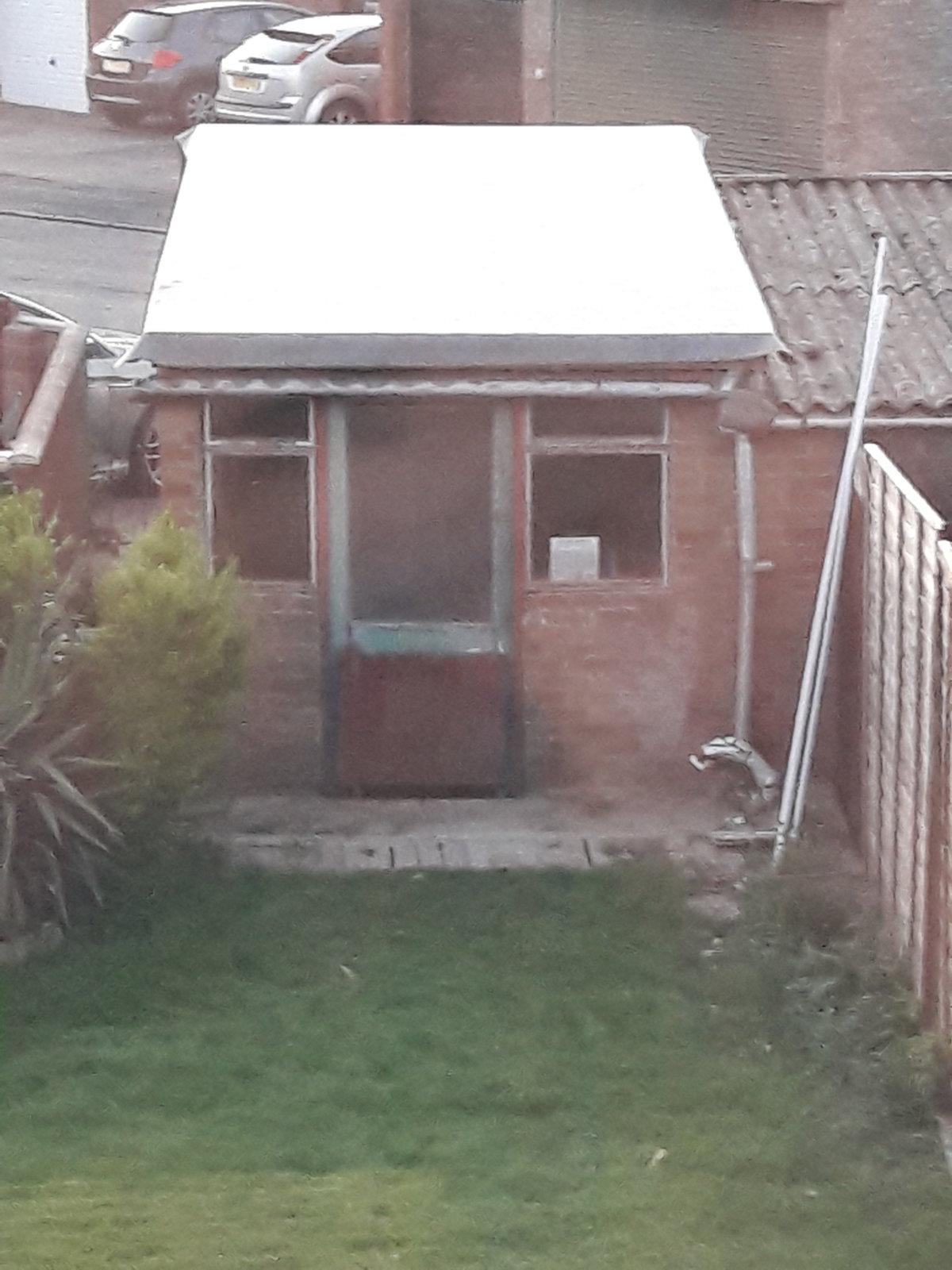

Anyway, I decided to replace the roof with a timber frame and an EPDM one piece rubber cover. I've checked with planning and as long as the roof remains under 2.5m it'll be fine. Building control aren't worried as the garages are detached from the property.
After a few design iterations and a rough attempt at costing the job I cracked on with the work.

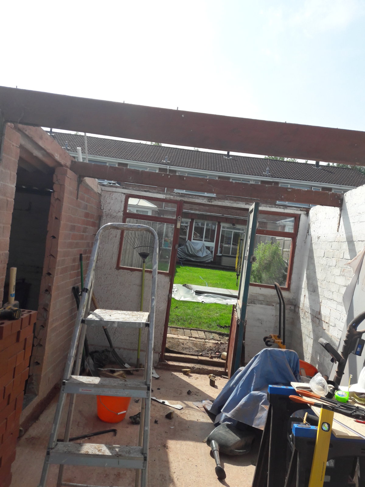

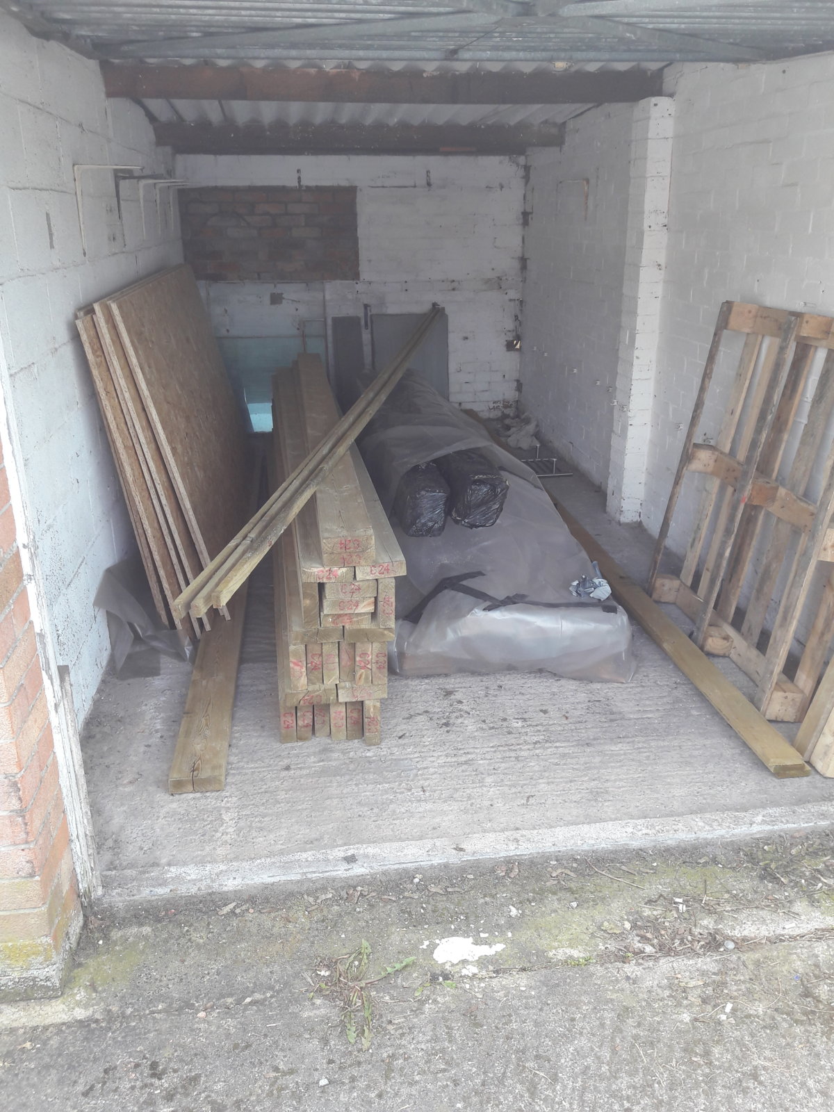

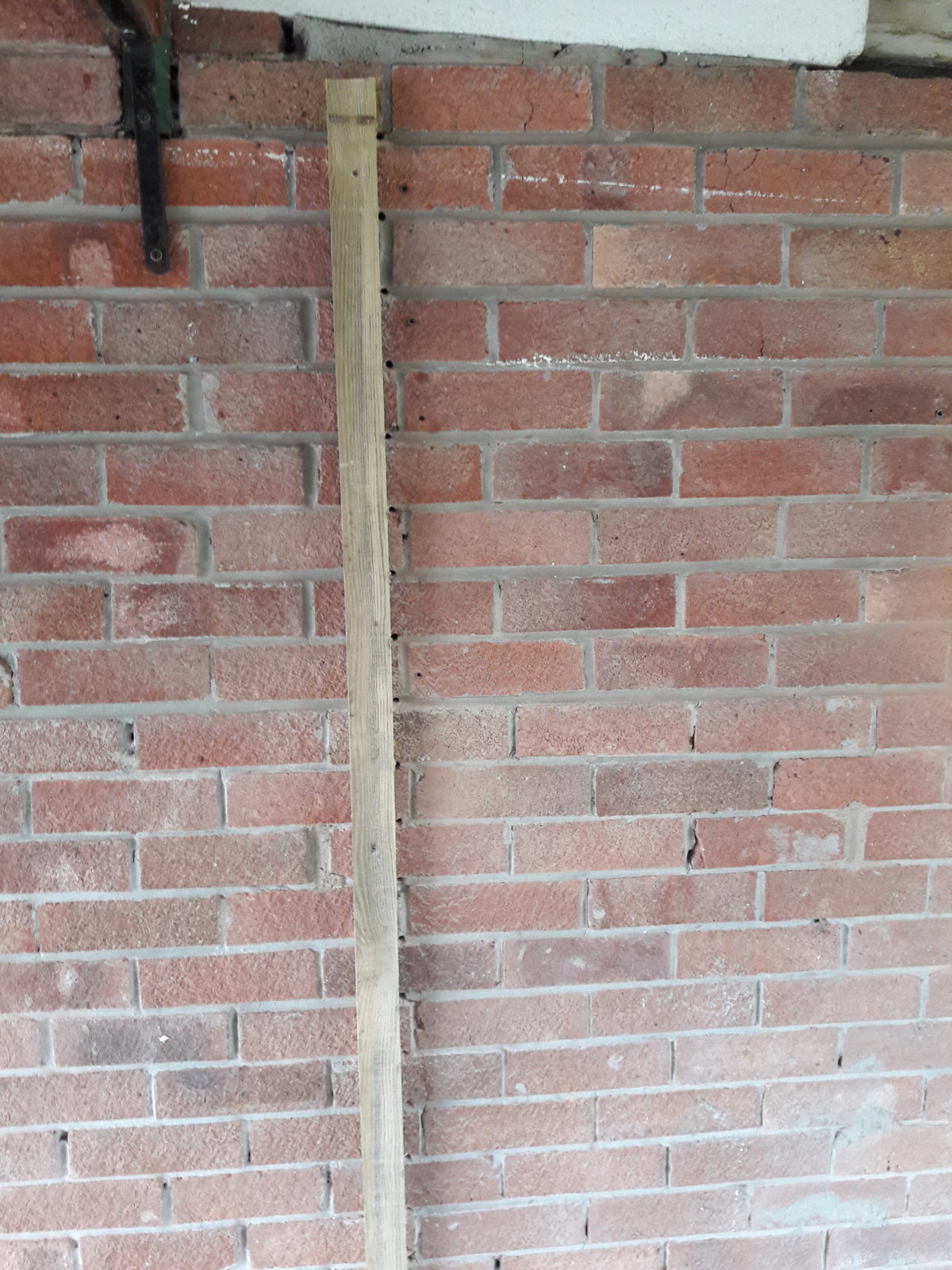

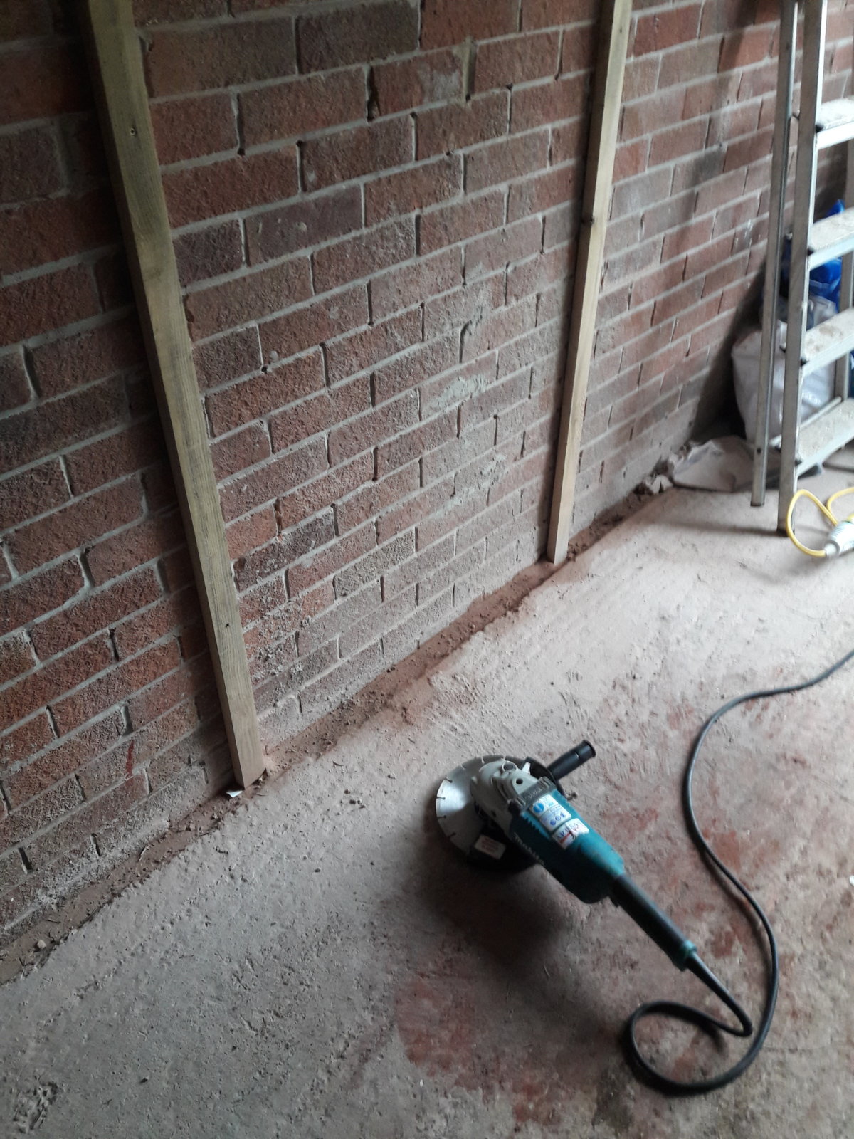

First job was to cut a door way between the two garages. FYI: the planning permission was for an extended garage not two separate garages so the permission would still be valid. I screwed some timber battens to the wall to give me a nice straight edge and drilled a load of holes in the mortar joints. I hired a 9" angle grinder for the job. I had read that they kick up LOADS of dust but I really underestimated just how much they generate.
I scoured out the mortar joints every few courses before cutting through the wall so it didn't all fall through in one big old block.
After a few passes with the grinder and a few taps with the persuader the wall fell through nicely.
Job done.

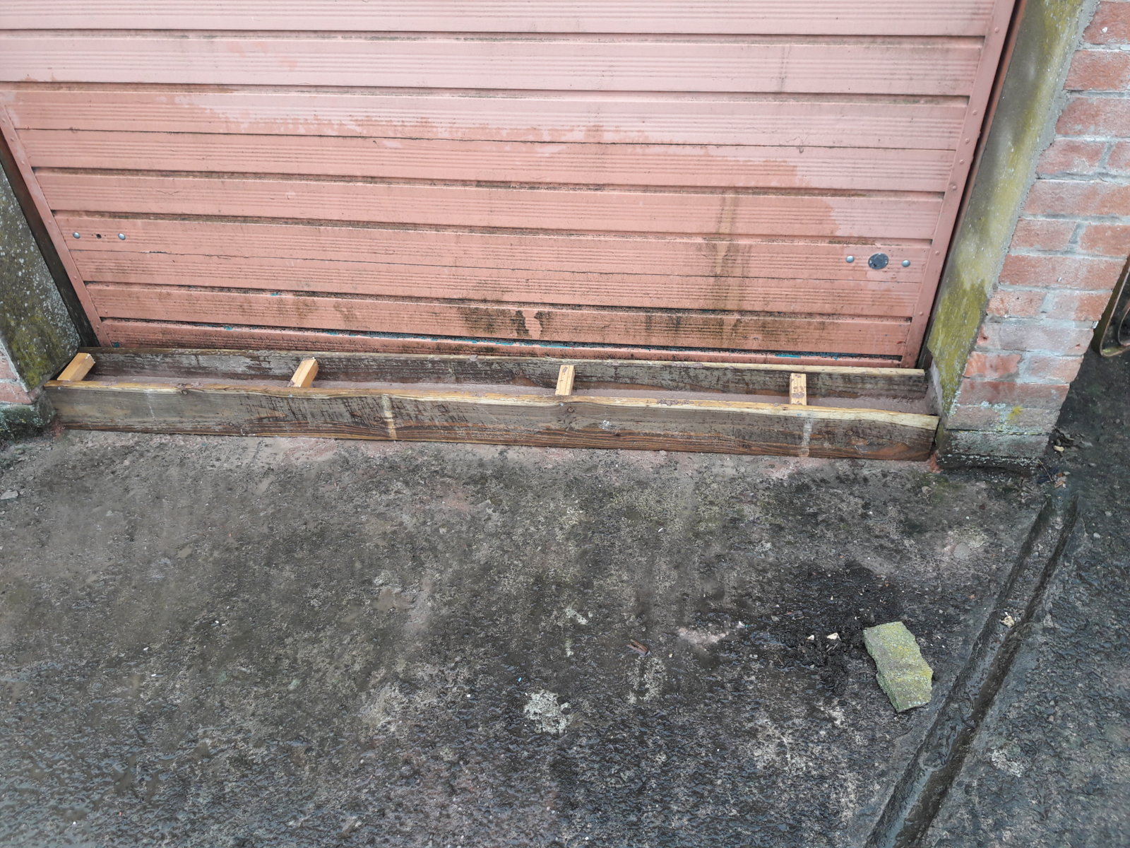

Second job was to pour a concrete footing for the timber wall at the end. I was planning on replacing the end wall with a timber frame wall.

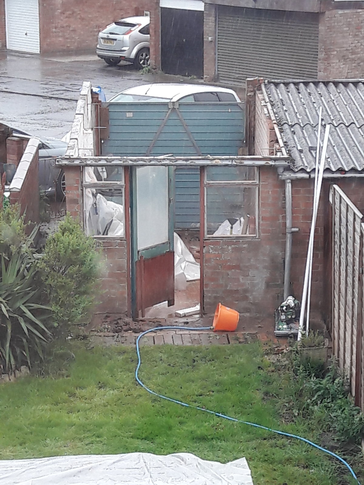

I started the second day by cutting the bolts securing the roof panels to the joists. I used some chunky bolt cutters for the job and they pinged off quite happily. I slid the panels down the roof following the fall and being careful not to scrape them too much. Fortunately it was a drizzly day so the panels were wet, reducing the amount of dust generated. In addition I wore an appropriate dust mask, goggles and old clothing that I could get rid of. With a lot of man power and brute strength the panels all came off without breaking them up. Word of warning: this is not a one man job. It dam near killed me.

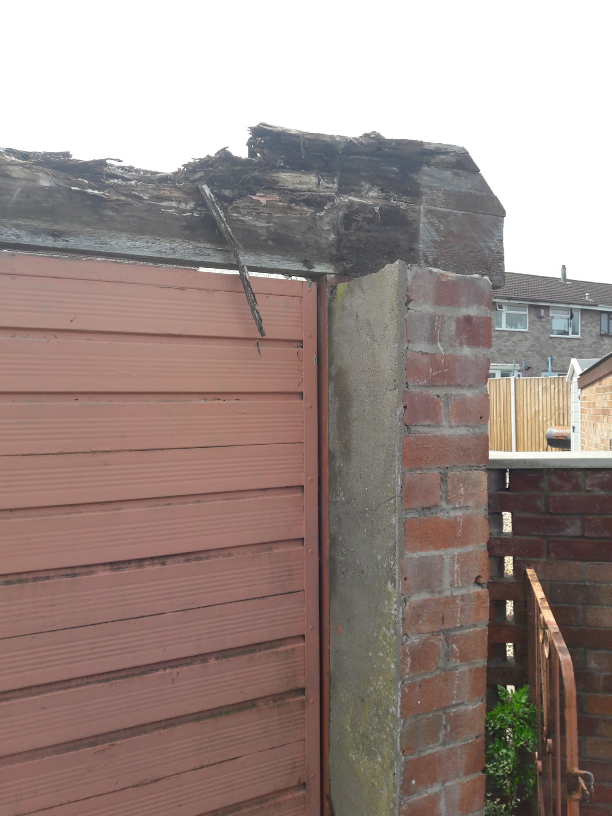

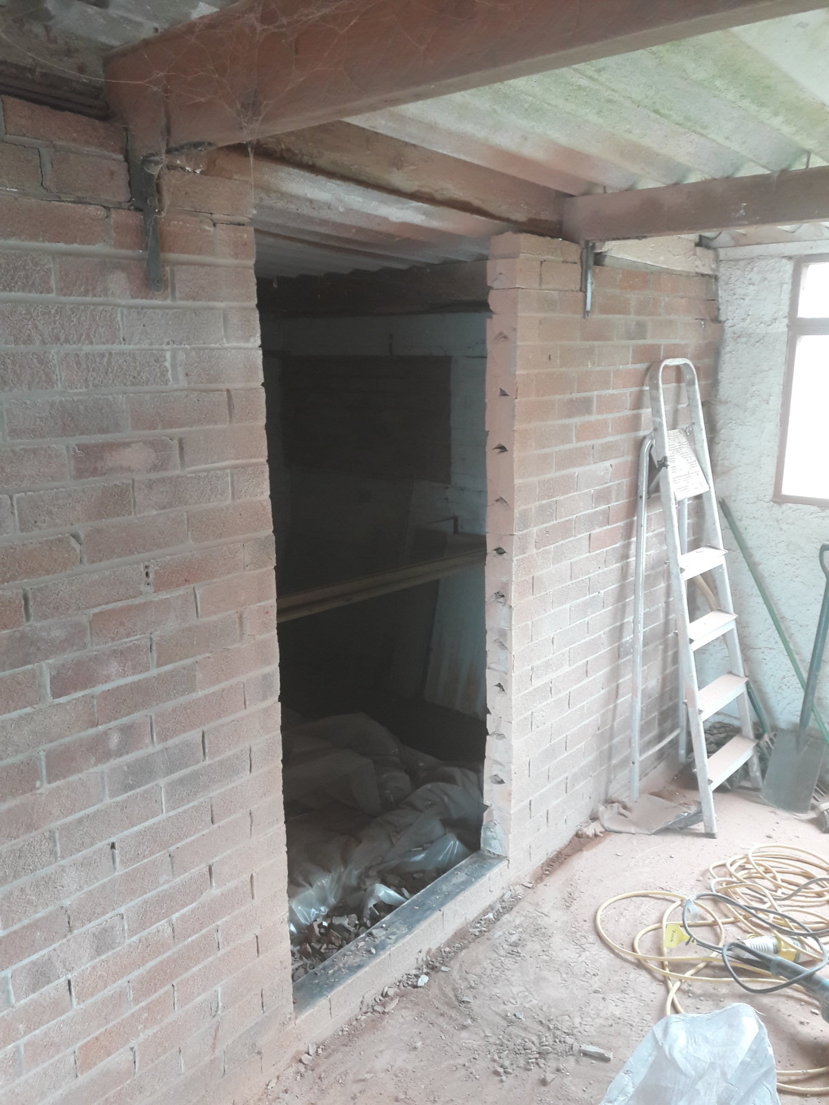

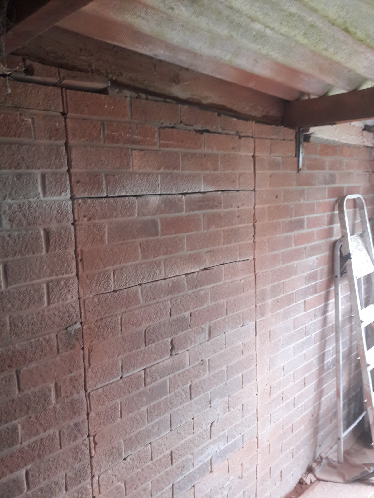

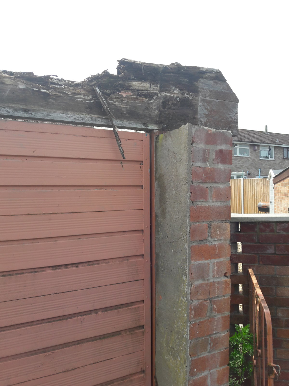

Removing the panels revealed some very rotten joists which were basically held together with cobwebs. In addition, the brick work was very dodgy and big sections were quite wobbly.

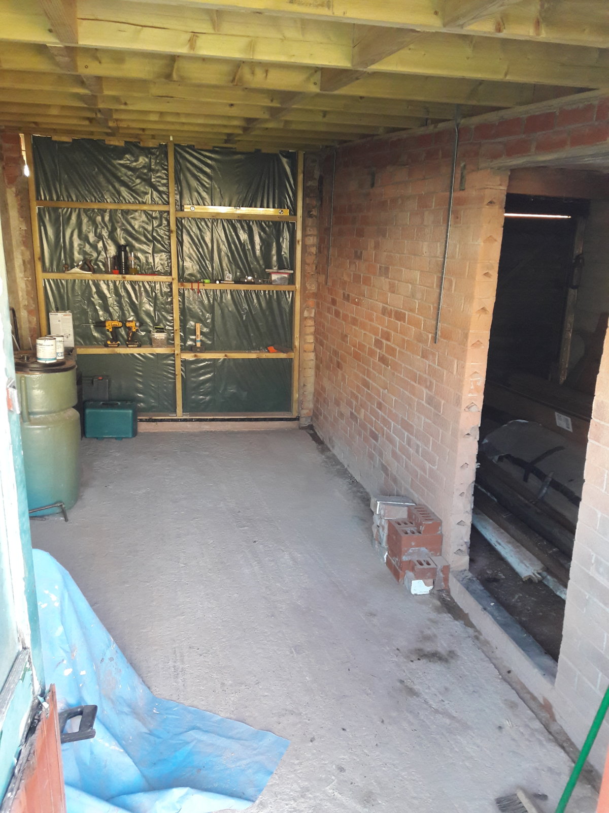

Day Three:
Removing the joists was fairly straightforward. They were quite rotten and not really secured to the walls so they dropped out without much fuss.
After the joists were out I spent the rest of the day patching up the walls and learning how to lay bricks. Its not as easy as lego but once I got the knack of a mortar mix (not easy in +25°C), I motored along quite well.
I installed a metal lintel over the door way I cut. It was not to support the bricks above the wall but to tie in the two parts of the wall and add a bit of stability.
By the end of the day I had bedded in the wall plate on the wall to the left of the image above (not on the pic). I had though I would be able to use a 1" x 4" timber for the wall plate but in hind sight it wasn't thick enough and didn't have the strength to to offer a flat surface so didn't really help too much! I picked a 1" timber as I was worried about the overall height of the roof.

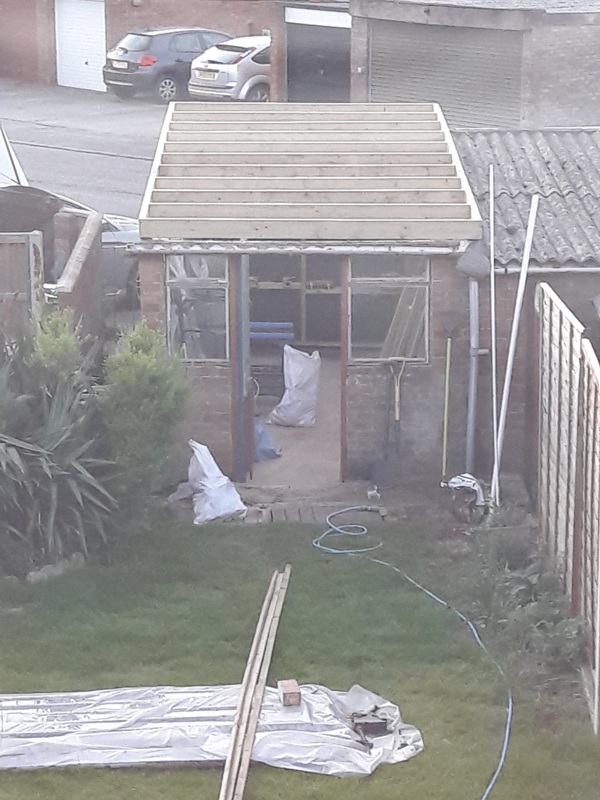

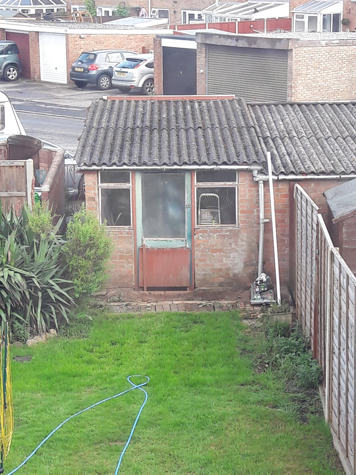

Things started to motor on the fourth day. I finished the brick work and bedded the second wall plate. I cut and fit the surrounding frame of the overall roof structure and temporarily fixed it with L shaped brackets. The end wall went up fairly quickly (thanks to a buddy with some experience). The long sides were jointed to avoid a butt joint. After the frame was in I fit the joists and by the end of the day the roof and end wall were looking fairly robust.

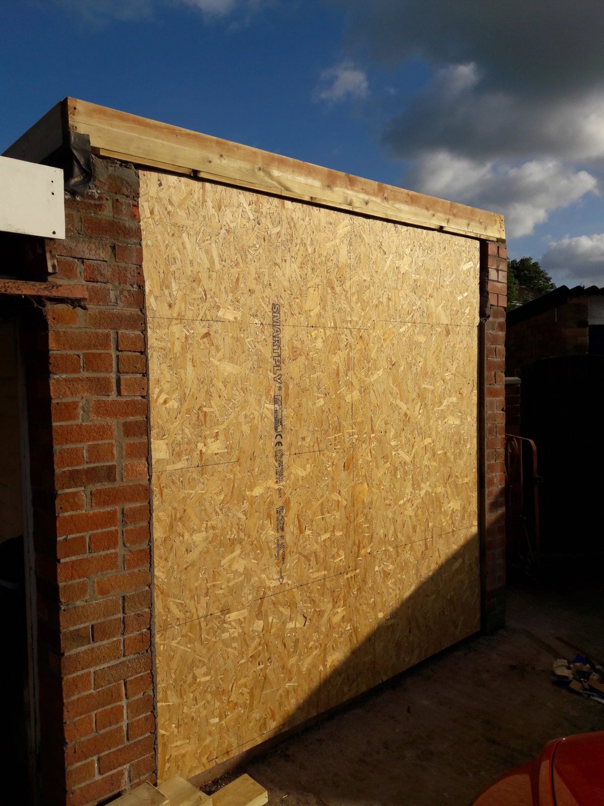

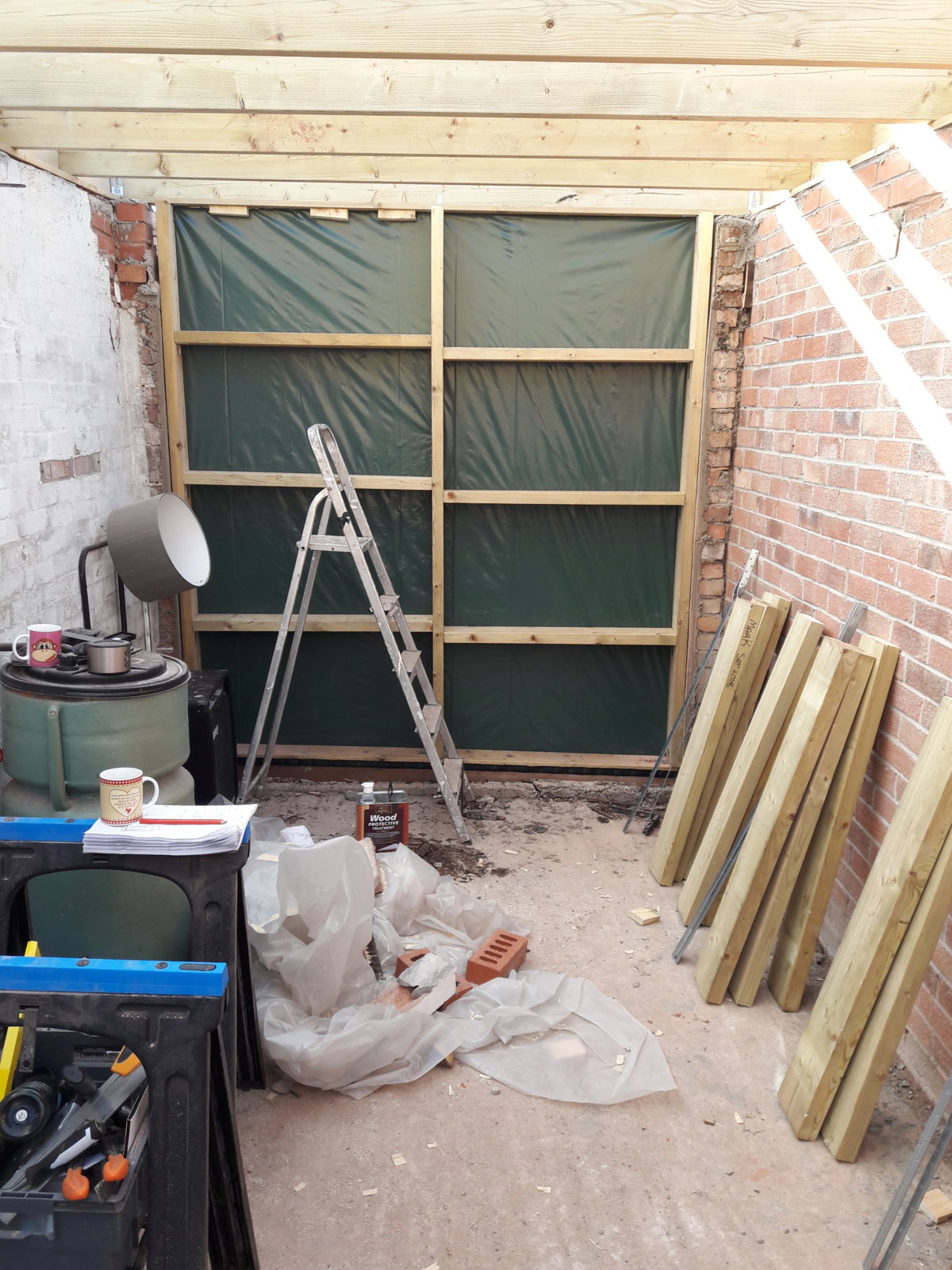

The roof was built with 2" x 6" C24 timber as was the end wall. The skin of the end wall was clad in 11mm OSB3 with a vapour barrier between the frame and the OSB. The frame was fixed with concrete bolts to the new footing I had previously poured and fixed to the side with hammer fixings.

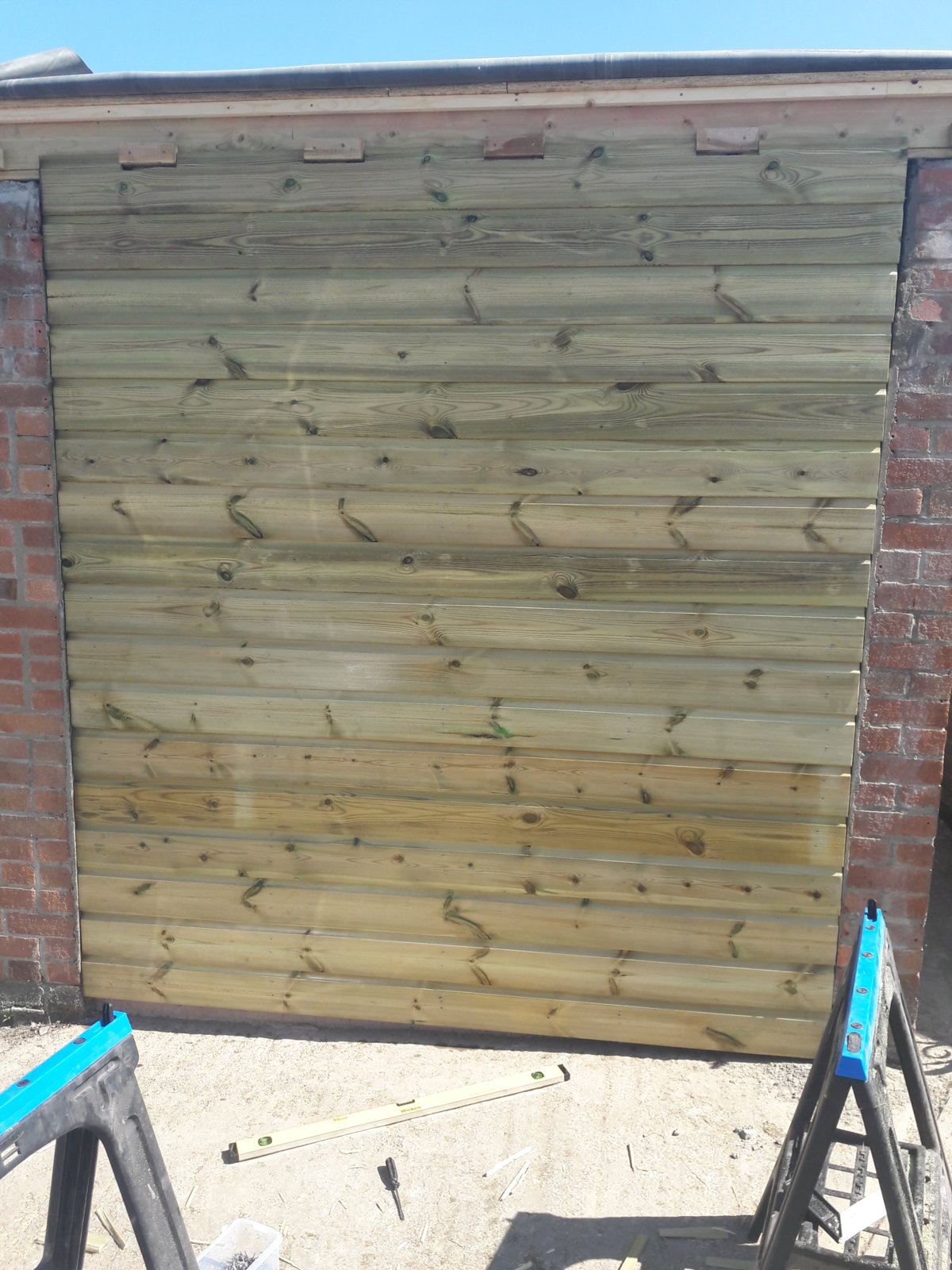

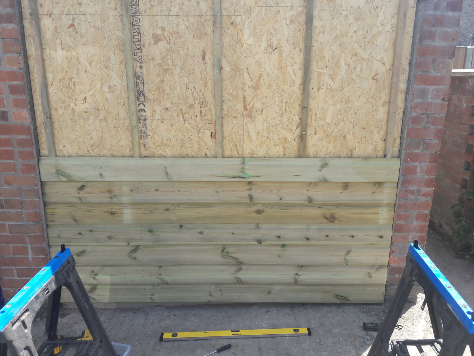

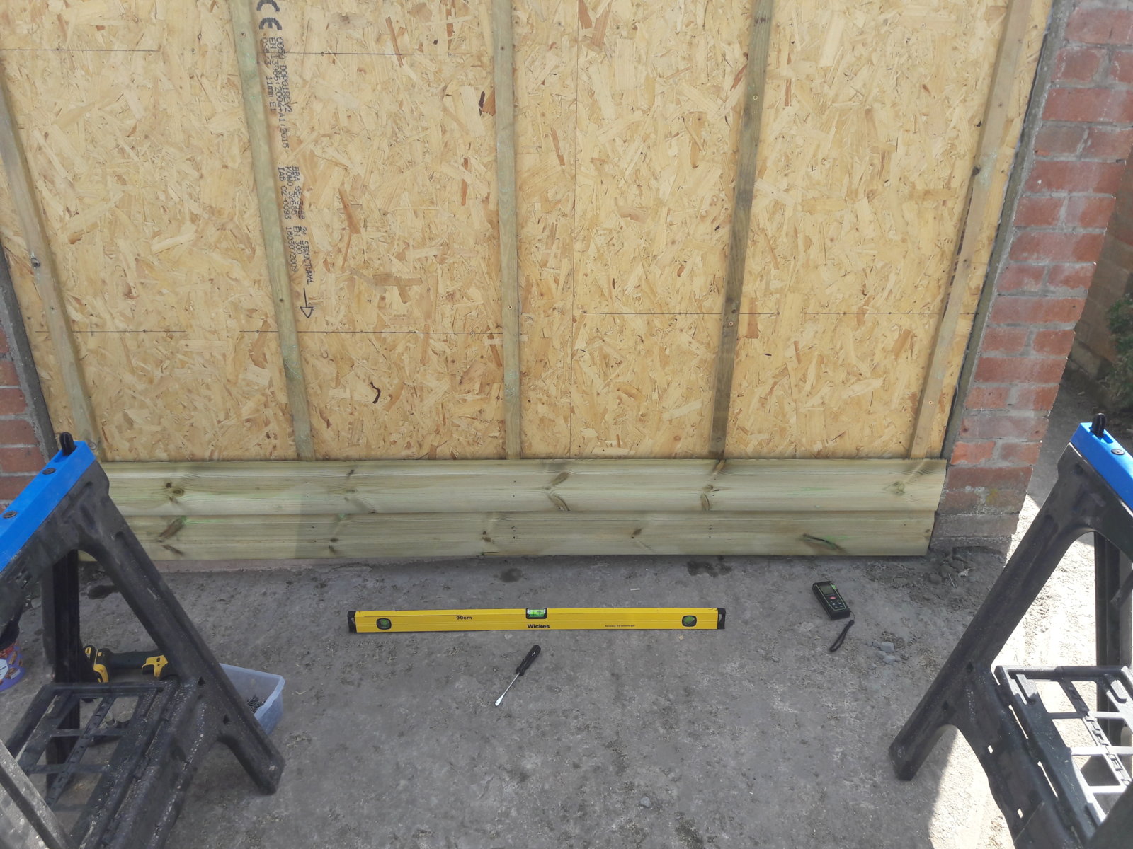

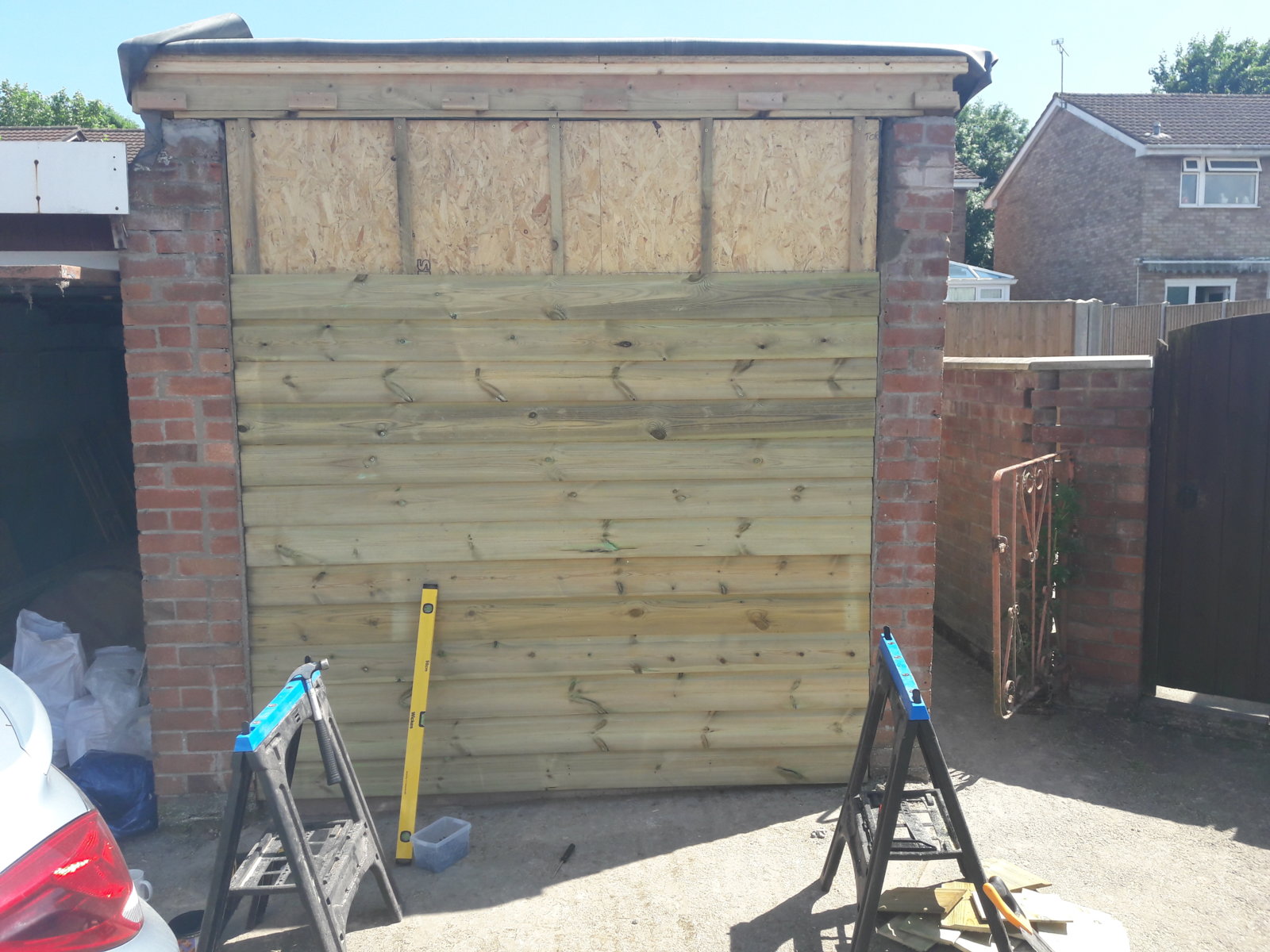

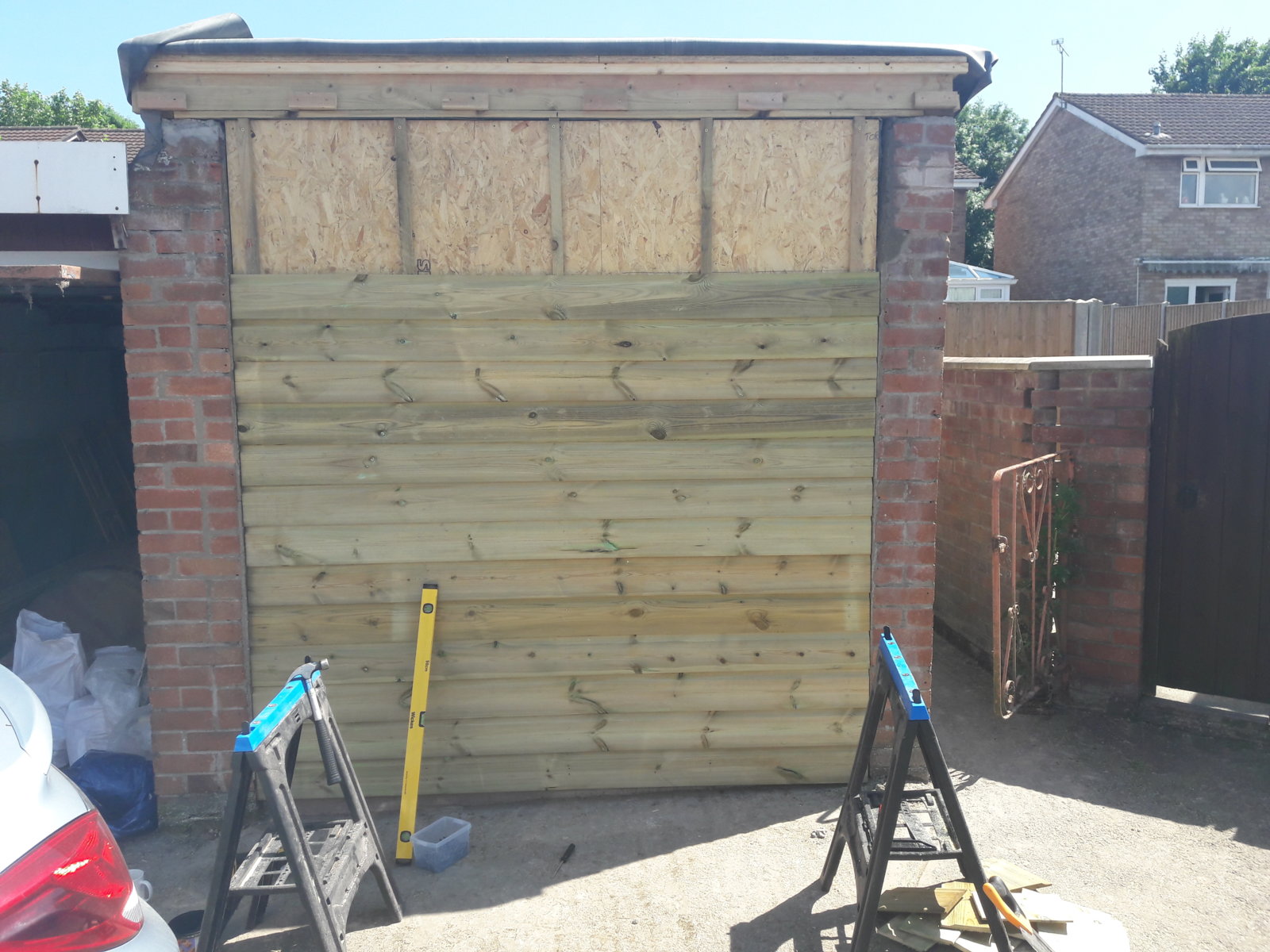

The other job this weekend was to shiplap the timber end wall. As per my previous post, I have replaced the up and over door with a timber frame wall. This is a 2" x 6" frame and has been boarded with 11mm OSB. I installed 19mm counter battens to the OSB and attached the 15mm shiplap to the outside. From what I read the counter battens need to be greater in depth then the cladding to allow ventilation behind and stop mould. The bottom board is a bit close to the floor on the right-hand side and will probably rot in a few year due to rain splash. Unfortunately I couldn't see a solution to this as the fall from right to left wouldn't allow the board to be placed any higher without exposing the OSB. I should've built the footing higher but hindsight is a wonderful thing!
~1528799528~20180610_131733.jpg ~1528799569~20180610_134921.jpg ~1528799596~20180610_135926.jpg ~1528799626~20180610_143654.jpg ~1528799652~20180610_154651.jpg
I may yet retro fit some steel wire mesh on the inside of the wall for security but I'm not sure yet. It might be over engineering the solution to a problem which doesn't exist.
The top shiplap board was (roughly) cut around the fascia spacers at the top. I lost a chunk of my thumb in this process but it'll grow back! The rough edge will be covered once the fascia board goes on so should look neater. The shiplap went up fairly easily really. I cut all the board lengths to fit by hand as the walls aren't quite square. There's still some sealing to do and the boards will need to be finished but it looks reasonably robust for now.

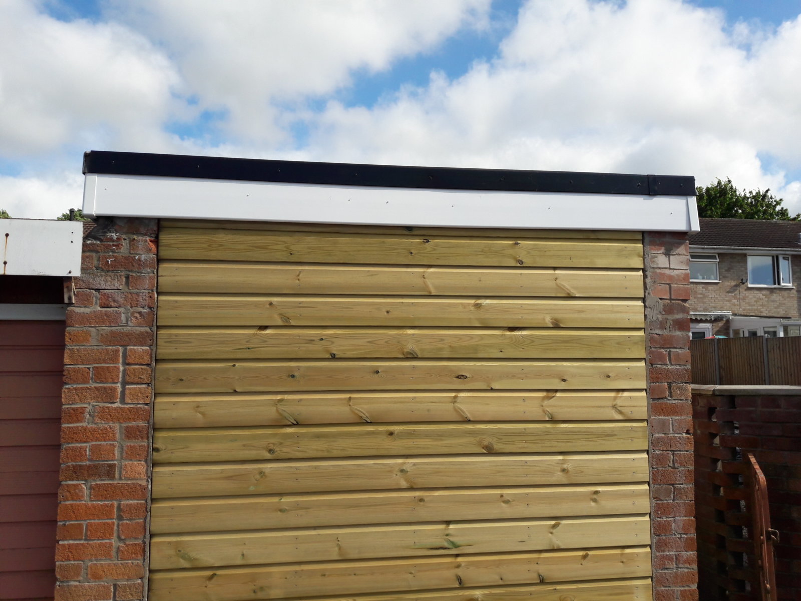

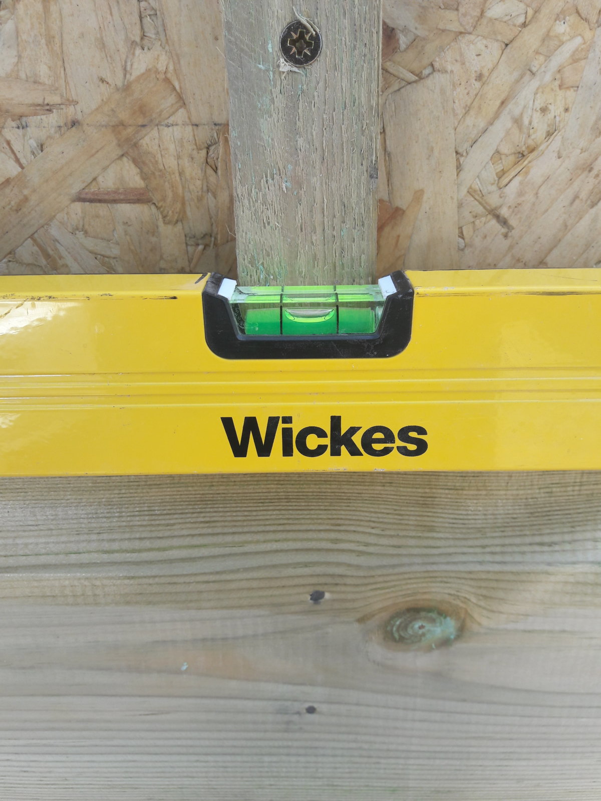

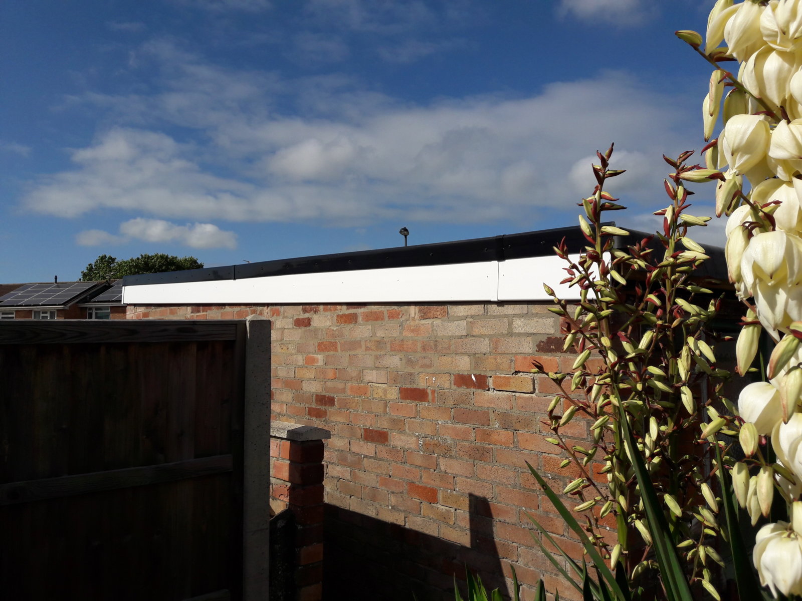

Another weekend in the garage. This time I got three of the four sides covered in fascias and roof trims.
The white fascias went on fairly easily but were a bit ungainly given that they were in 5m lengths. Not easy to handle in a breeze. I had to modify the fascia boards slightly as I had miscalculated the depth of the L shaped return at the bottom of the board. Turns out I had to trim about 15mm off each of the lip to fit against the wall and still allow air to circulate behind (to ventilate the roof space).
The design of the roof allows a 19mm void behind the fascias which allows the roof to breathe through the vent holes drilled into the frame of the roof and through each noggin of the roof structure. The vent holes are covered in insect mesh on the outside and will be treated with preservative (once I get round to it) so any condensation doesn't rot the wood. Theoretically the roof should allow the movement of air in the top 50mm to reduce condensation etc so when I get around to insulating the bottom 100mm I won't get a build up of condensation etc. I'll see how it does for a while first before I call it a success.
The roof trims went on pretty easily. I just had to squish the foam between the trim and the roof to form a weather seal. Even I couldn't muck that up!!
