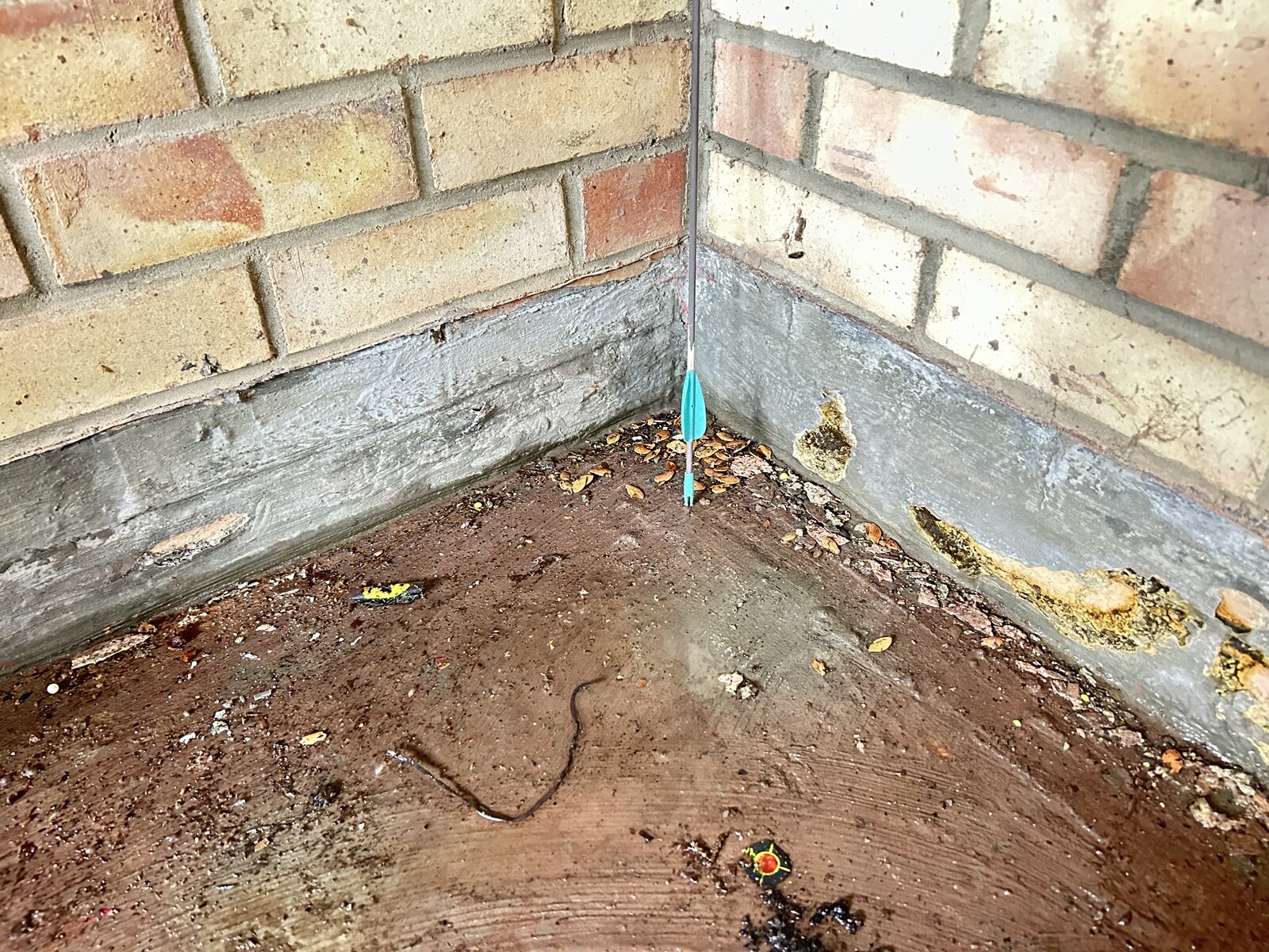

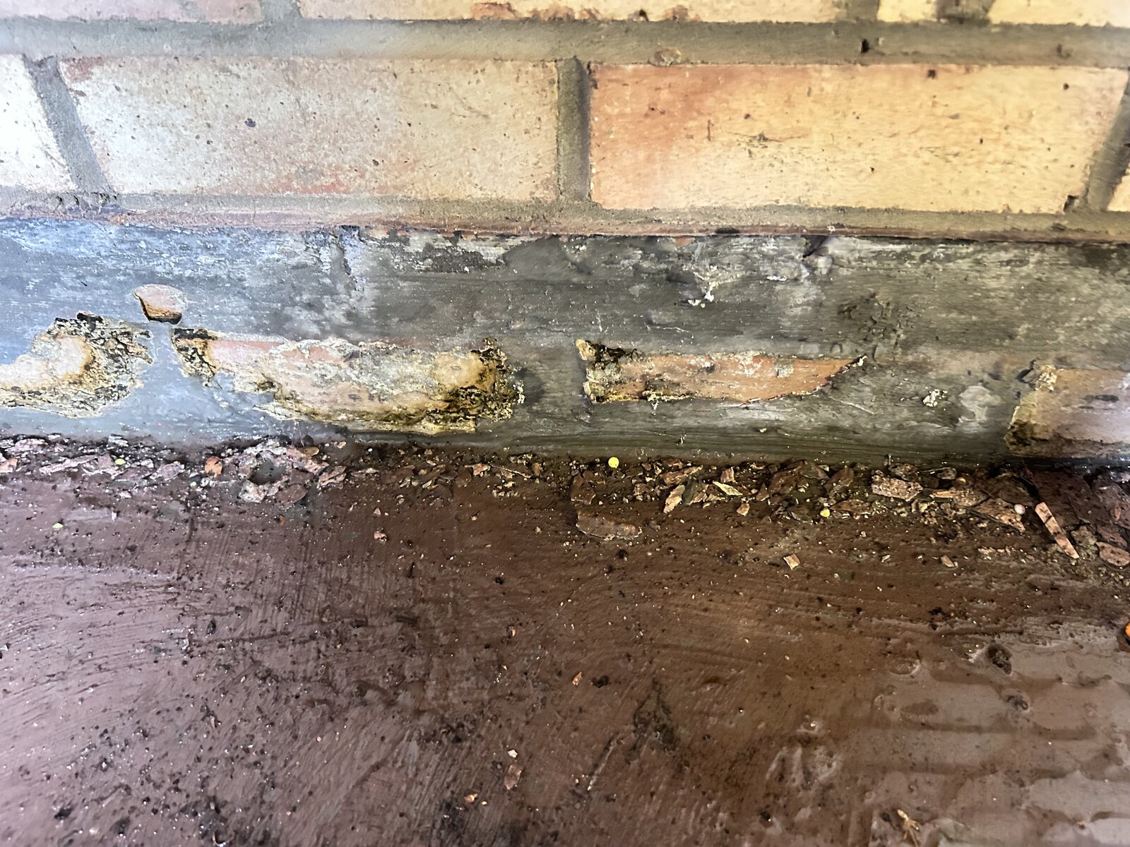

Finally got out for some images. Looks like someone has tried an internal solution in the past but it has cracked and flaked away over time.

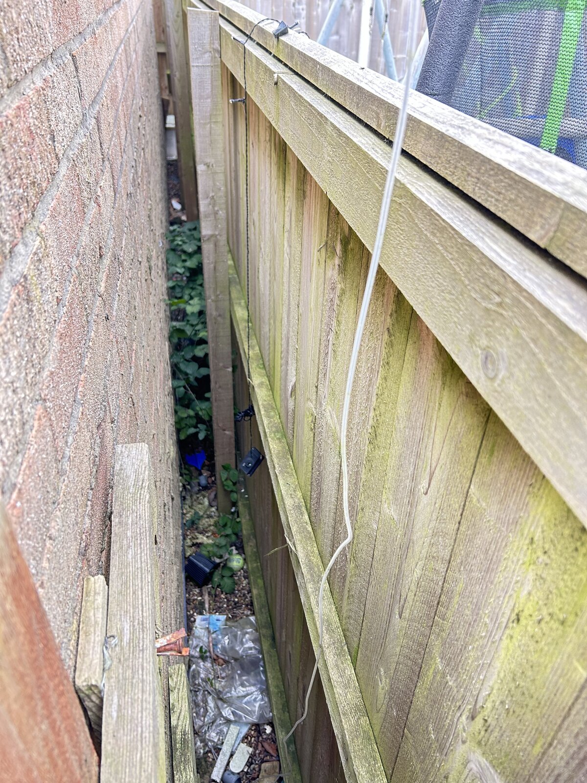

External shot of the gap down the property divide line. No chance of me getting down there and neighbours fence is new so it won’t be coming down any time soon. Working on convincing my 6 year old to do some digging in the gap to clear debris.
Any other suggestions with the limited access available?
