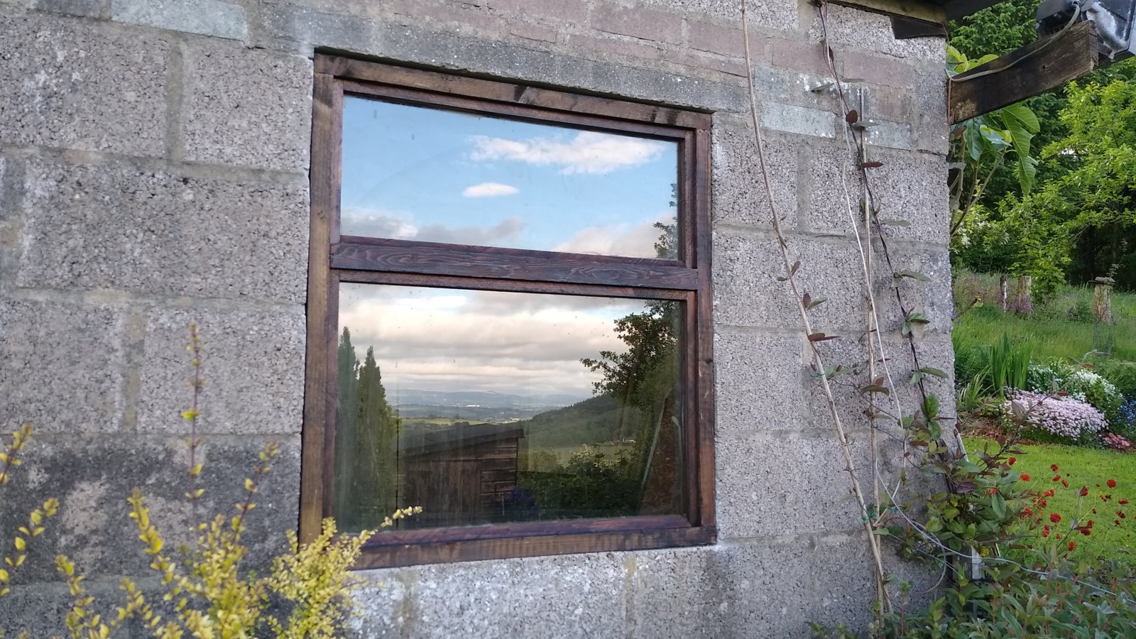

I made one yesterday,fitted and glazed today.
Frame from treated fence rails and 3x2 removed studs with tile battens to form rebates for glazing .Took an old DG unit apart and cut glass to size .Only small, 37"x34" two fixed panes but its done the job :)

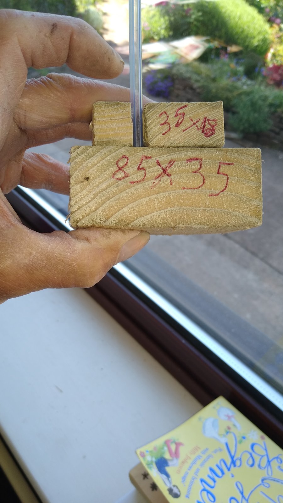

Nice work, LiL. I'd like a bit more detail on what you used.
So the sides are pressure treated fence timber -- what size?
The three cross-bars are 2 inch studwork timber -- soft wood?
Then pressure treated tile battens are used to form a rebate. What size are these?
And how is the glass fastened in? I have used putty in the past.
All 4 outers are from 1 rail 85x35 , but I've done other frames with whatever timber I can find.
Mid piece is 3"x2" stud timber .
Batten 35x18, with some run down one to form glazing bead
