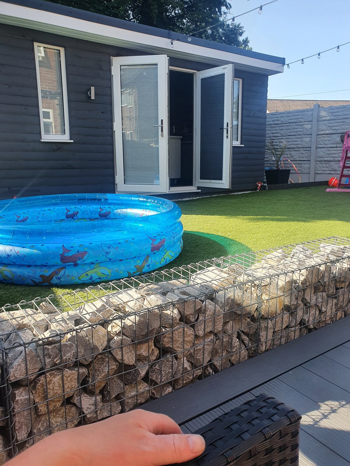

Hi all. I built a garden room last year in first lock down. Used as a bar with 2 beer fridges in there and beer machine on counter. All fully insulated in walls, plasterboard and skimmed. Have a heater for winter when needed. But jeez this weather and heat from 2 fridges. Any recommendation on how to remove heat.

A different colour to the building may help as it is dark colours soak heat, whereas light colours reflect it

Light coloured walls
White EPDM roof
A reflective awning on the side which catches most of the sun
Mrs wouldn't let me paint it any other colour now anyway.
Roof is insulated yeah. And rubber roofed grey.
Windows don't open unfortunately. To be honest, I wouldn't leave them open when not in or at work anyway. Just ordered a woozoo fan to see what that does. Still may put a vent high up on wall. As soon as I get home I open the doors to get air flowing and it cools down slowly. Bloody hot at moment not helping
