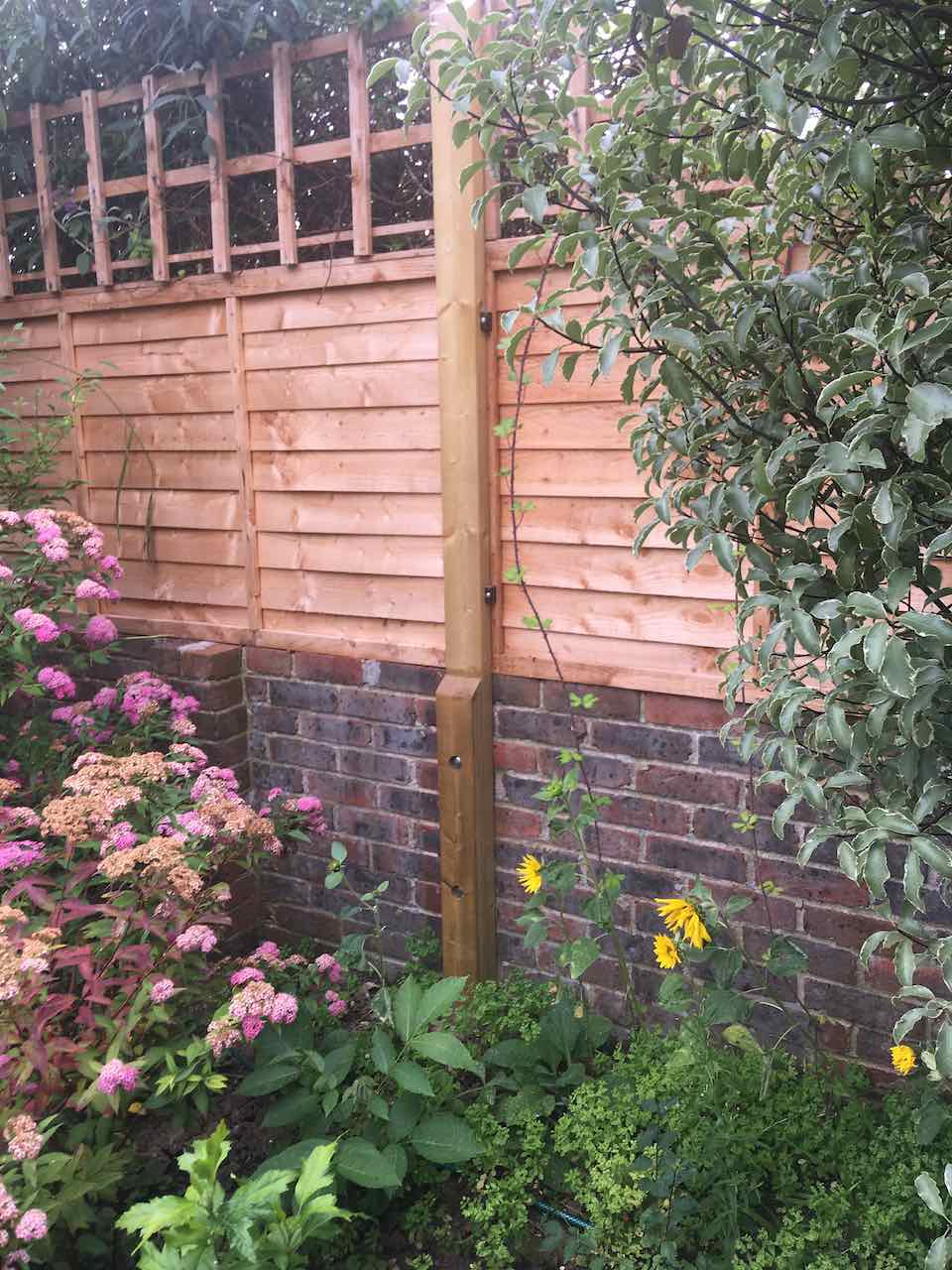

i have replaced a fence that was bolted to a wall and lasted 25+ years (my mother-in-law lived here since 1997 and it was up then, now we live there), very windy area and only recently due to the post being rotten and wood worm got the better of the fence, so 2018 my wife wanted a decorative section from B&Q https://www.diy.com/departments/goo...Vz4BQBh0TpgKSEAQYBCABEgISxPD_BwE&gclsrc=aw.ds
and during the virus I finished off the rest of the fence this year.
I used a 2.4m posts 95x45 tanalised posts , which I took below the ground and postcrete in
then a smaller piece up to the wall top and again quite a way down into the earth past the wall foundations and postcreted all in.
Then used 2 coach bolts through both posts and the wall to fix.
https://www.screwfix.com/p/easyfix-...-bright-zinc-plated-m12-x-200mm-25-pack/51675
with Penny washers and 2 NUTS on the back of the fence
I used some furniture blocks to fix the panels , so i can easily remove a panel if i need to clear ivy etc off the panel
2018 i put up about 21' length this is the very windy part , as we are only .5km from sea and strong winds come across that part of the garden, and they survived 2 winters of high winds and this year finished off the other 5x 6' length fences panels
I packed slightly to account for upright levels and horizontal levels
I used these https://www.amazon.co.uk/gp/product/B00GOUP0IC/ref=ppx_yo_dt_b_search_asin_title?ie=UTF8&psc=1
to get a space between the fence panel and wall , so the panel was not on the wall completely, just a mm or so
