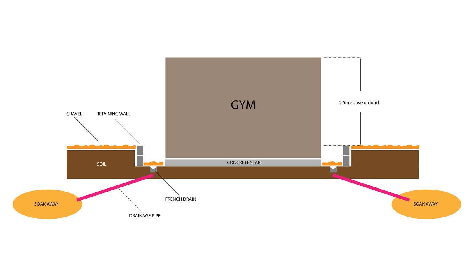

ok, looking into this further, as i'm planing on building this within 2m of the boundary, my real only option is doing it like the following, excavating 50cm. As the rest of the area is gravel, on top of non-compacted soil, there is never a drainage or flooding issues and it's around 50m from the nearest property/hard standing.
Do people see this being a possible issue with damp and water ingress? I felt a 50cm gravel border with a French drain below, going to a soak-
away would suffice... and sinking it 50cm below ground would give me the necessary height required

Hi @Larry1990 that's some sound advice thanks, but unfortunately due to space my only option is to build on the boundary. I don't think I will get planning permission for 3m in height being this close? If I was it would defo be an option. I don't want possible issues with damp ingress. I guess I hoped with a drainage perimeter it would be pretty straightforward to overcome...

Personally I can't see what's so difficult about a tanked structure. It's not much different to a fish pond (a continuous waterproof membrane) but sandwiched within the structure. Incorporate an internal step to avoid threshold issues.

I'm currently getting a front extension done and spoke to my architect about my idea. He suggested the simplest way was to do a moat as I've been thinking, he said a sleeper retaining wall and a 40cm drop wouldn't be an issue...
@cdbe I've seen in other threads where this is suggested. I'm not sure I can get my head around this sort of construction with a timber frame. I guess i'm drawn to the simplicity of the moat as it's easy to monitor...

We are on poor draining clay soil so in heavy rain a moat would literally be a moat. That would put me off, but it might work for you.
