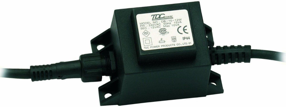

Non electricians answer - I suspect not, as the output looks to be max. 10w - four lights (of the type you link to) would be 12w
newboy is correct, the output of that transformer is 10va which is only sufficient for 3x3W
thanks guys I will let him know ...he'll probably just use 3 lights off same adapter ta
