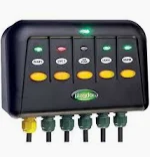

Lights for decoration tend to be solar powered battery type. As to using 10 SWA glands, and 6 stuffing glands that seems a lot of work, Blagdon made a system to get around the original Part P regulations (still in force in Wales) with plugs and sockets all water resistance which may suit what you want, I would smear the joints with petroleum jelly, 1723813731576.pngbut the units are designed for the job, would go to a pond place to see the options, as used a lot with ponds. May be there are cheaper options.
