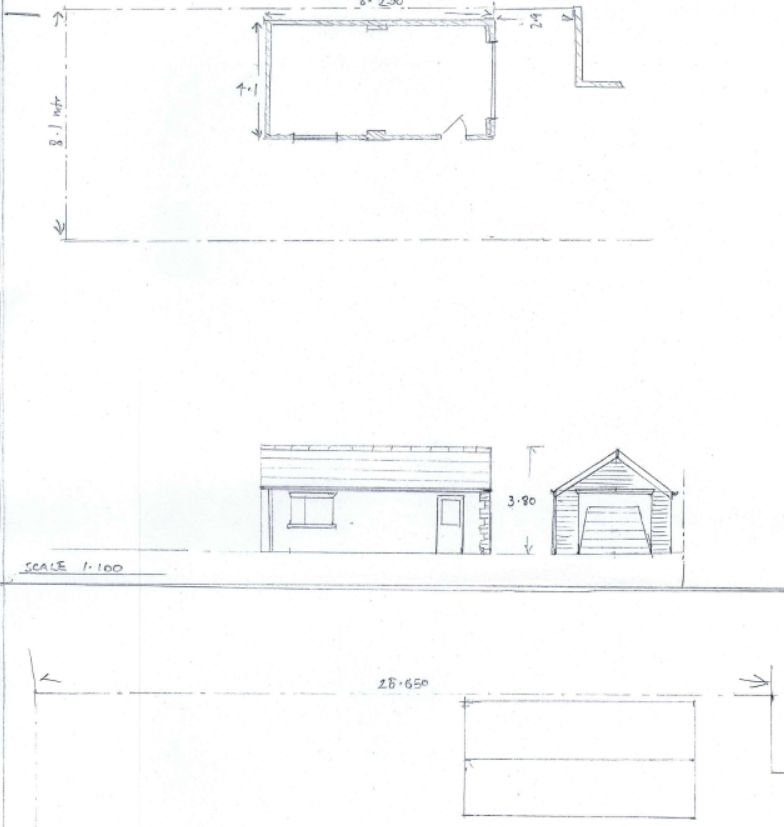

We're planning on building a garden studio/office at the Northern boundary wall of our garden.
We just wanted to get confirmation of a few things before going ahead and thought this was the best place to ask..
The site we have chosen is approximately 1m from the boundary wall. Presumed this would mean we would need planning for anything >2.5m roof height.
As the site is significantly sunk (approximately 2.5m) down from the ground level abutting the wall on the other side (an unadopted track/lane) I'm not sure how the 2.5m roof height rule would apply? Does the rule apply to the height in relation to the ground level of the boundary land?
We are hoping to get something as close as possible to the 30sqm restriction, so 7.5m x 4 I guess.
Also wondering, if we need it, how easy is it to apply for planning ourselves, presumably there is some good software out there for floorplans etc. but is it just worth paying someone to do this? If so, is there a generic online service you would recommend?
Many thanks
